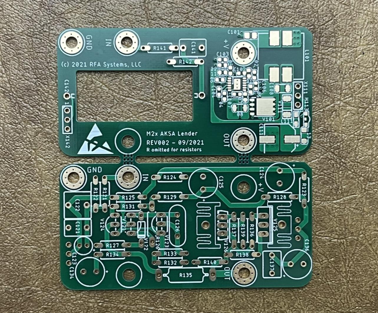

Swap DN2535N5 for DN2540N5?
I noticed that stocks of the DN2540N5 are somewhat rare at present. Yes, I see that Mouser will replenish stocks Next April, and that WinSource has nearly 1k available, but at nearly 300% of "normal" price. Humor me for a moment.
As an academic exercise, I went looking for a replacement, and see that Microchip makes a DN2535N5, which appears to me to be nearly identical, except that it has a lower Vdss of 350V; a derated DN2540N5. Since the Vdss of the BSP129 is 250V, and we're not using anything close to that, it seems to me it could be a viable replacement.
Is there any reason A DN2535N5 could not replace a DN2540N5 in this application?

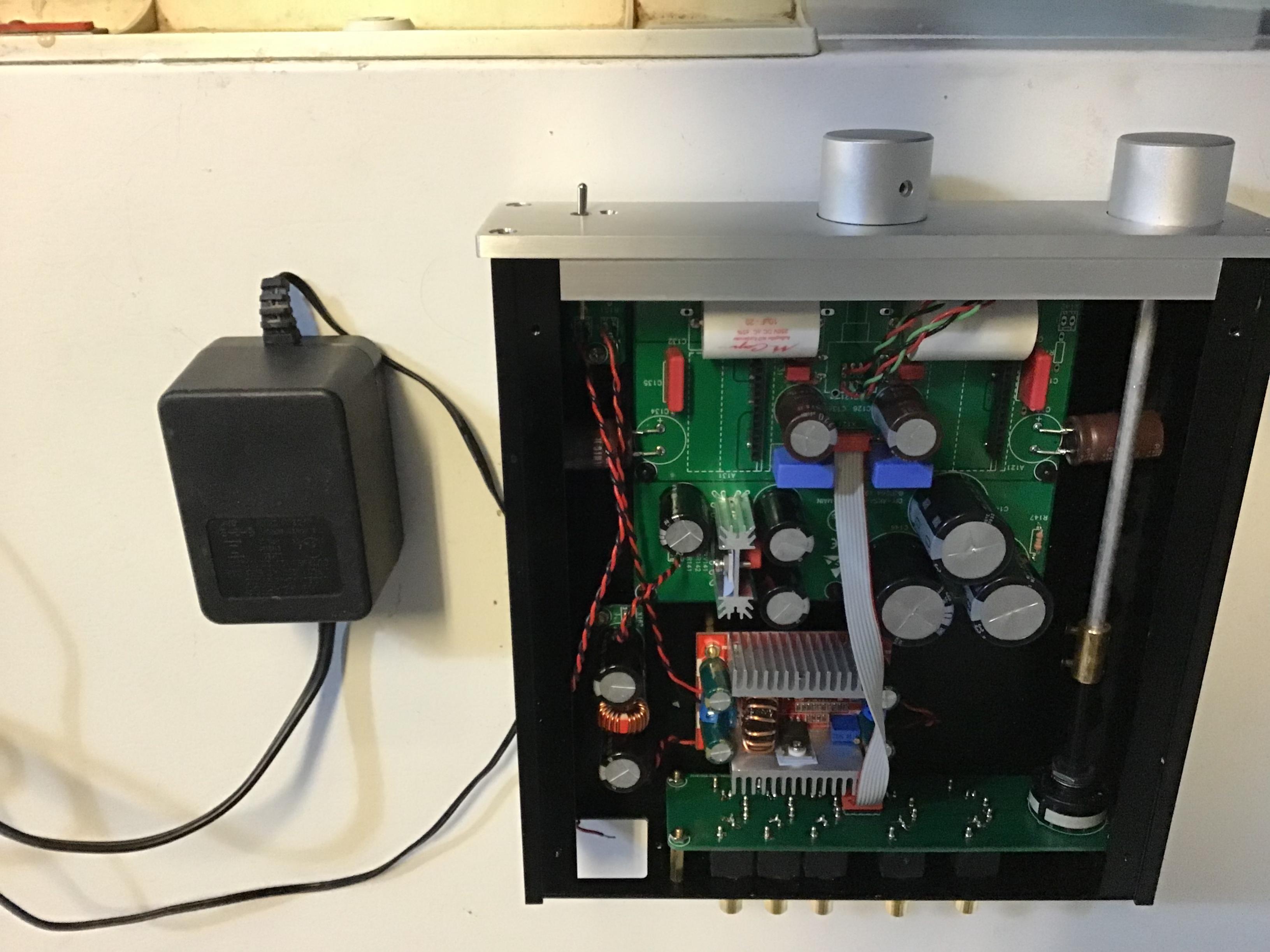

Vunce,
I have been reference the group buy and have made I think most of the corrections. I see I was looking at the wrong pinout for the depletion mosfet. This is kinda driving me nuts, it is so simple I am missing something on both boards . I just can’t get any bias current on Q5.
Bill
I am using a 12v linear transformer and step it up 48v. Just need to finish the power entry and get some real dn2540.
Bill

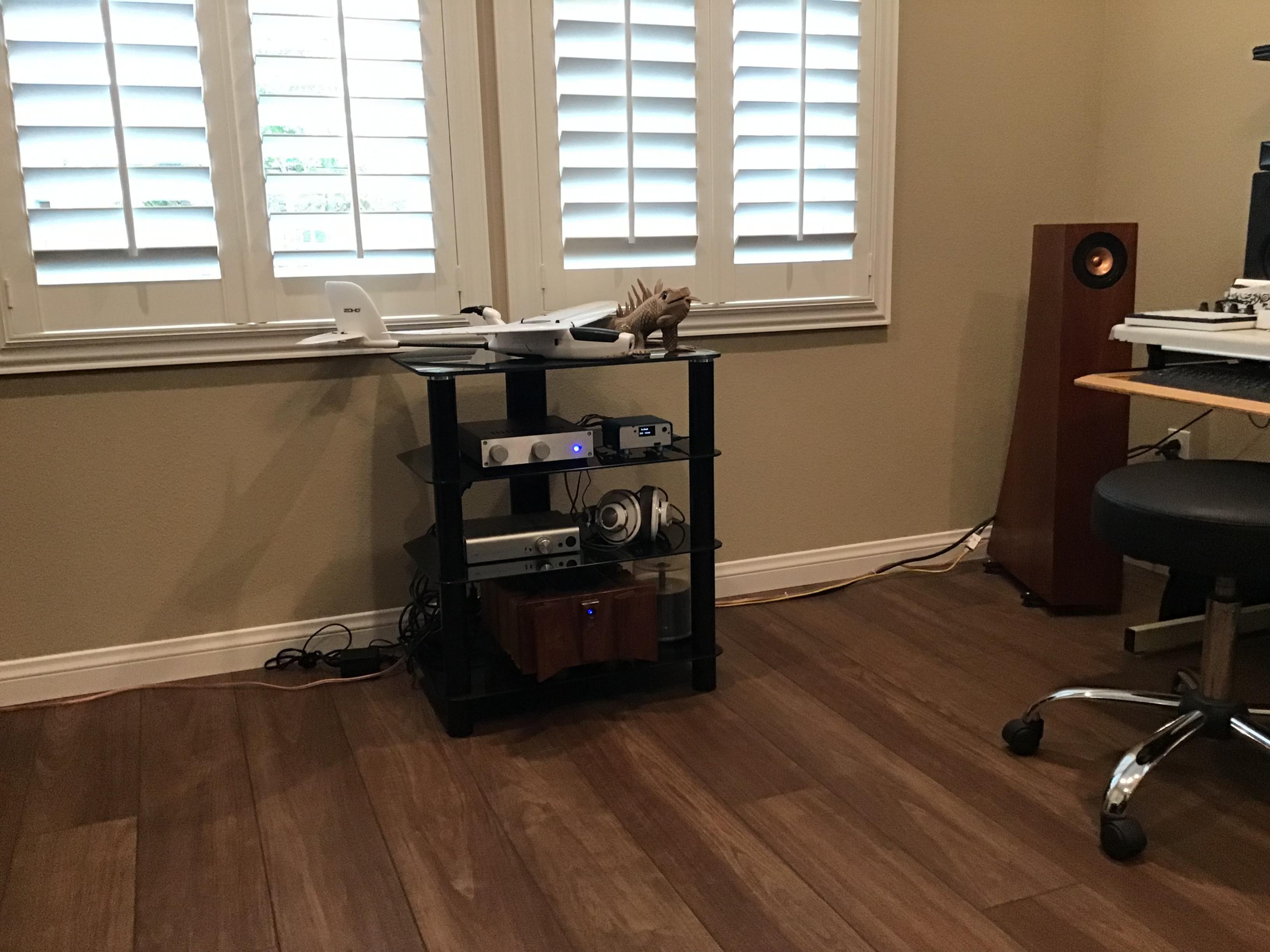

Finally received depletion fets to replace fakes,ASKA Lender doing Office duty with F4 amp built 15 yrs ago and a pair of Frugal horns and they sound hauntingly good. Ignore the peace of Schitt under it.
Bill

Vunce,
Allo Boss2 endpoint for use with Roon. ZMan thanks, in some ways this system sounds better than my large one in the living room. The soundstage is much better and small room easy til fill, living room right side has a wall left side open to kitchen screws with soundstage
Bill
