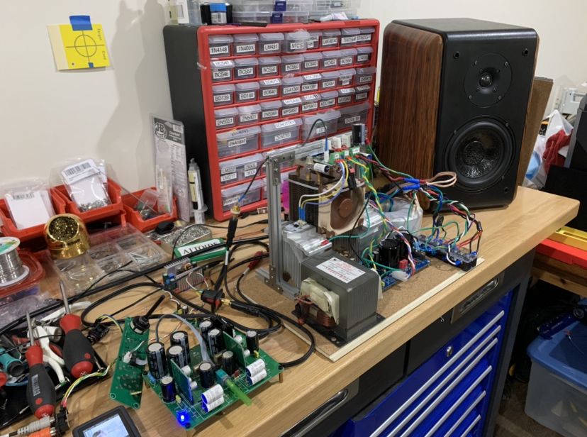

Bravo Drew!!
Wasn’t it worth the wait? 😛
Enjoy your ALP/MoFo combo!
Yes great sound. Very satisfying build for.sure. Can't wait to hear how my SONY "monkey coffins" sound with it, compared to my Sansui 5000x.
I've been considering the NuTube as an alternative, because I've never (knowingly) heard a tube amp b4.
Kind regards,
Drew

I am at a loss. I have built the preamp but I am getting wicked amounts of dc at turn on, something like 12v at the output. This then declines into the millivolt range over 30 seconds or so. If left on long enough it warms up and the output dc drops to a steady 1mv or less.
Where do I begin to look for the cause of this?

Well it finally happened, after 50 years of building electronic stuff I put a electrolytic capacitor in backwards, didn’t hurt anything as I slowly ramped power up watching an amp meter. Not to look a gift horse in the mouth ( not sure where that saying came from) I would have caught it if the polarity marking had not been covered by the capacitor ( hint hint). Also my pre amp boards powered up with no smoke however do not work. I verified no solder bridges or cold joints and I always verify resistors to 5 digits ( critical positions buy extra and match). I did measure and match the bc560c for hfe but did not verify rest of semiconductors. Since both boards act the same I suspect I may have sourced some fakes.
Bill

did I miss some thing when you use a DN2540NS instead of bd139 are the pinouts different? I seam to have 48v going to the gate.
Bill
