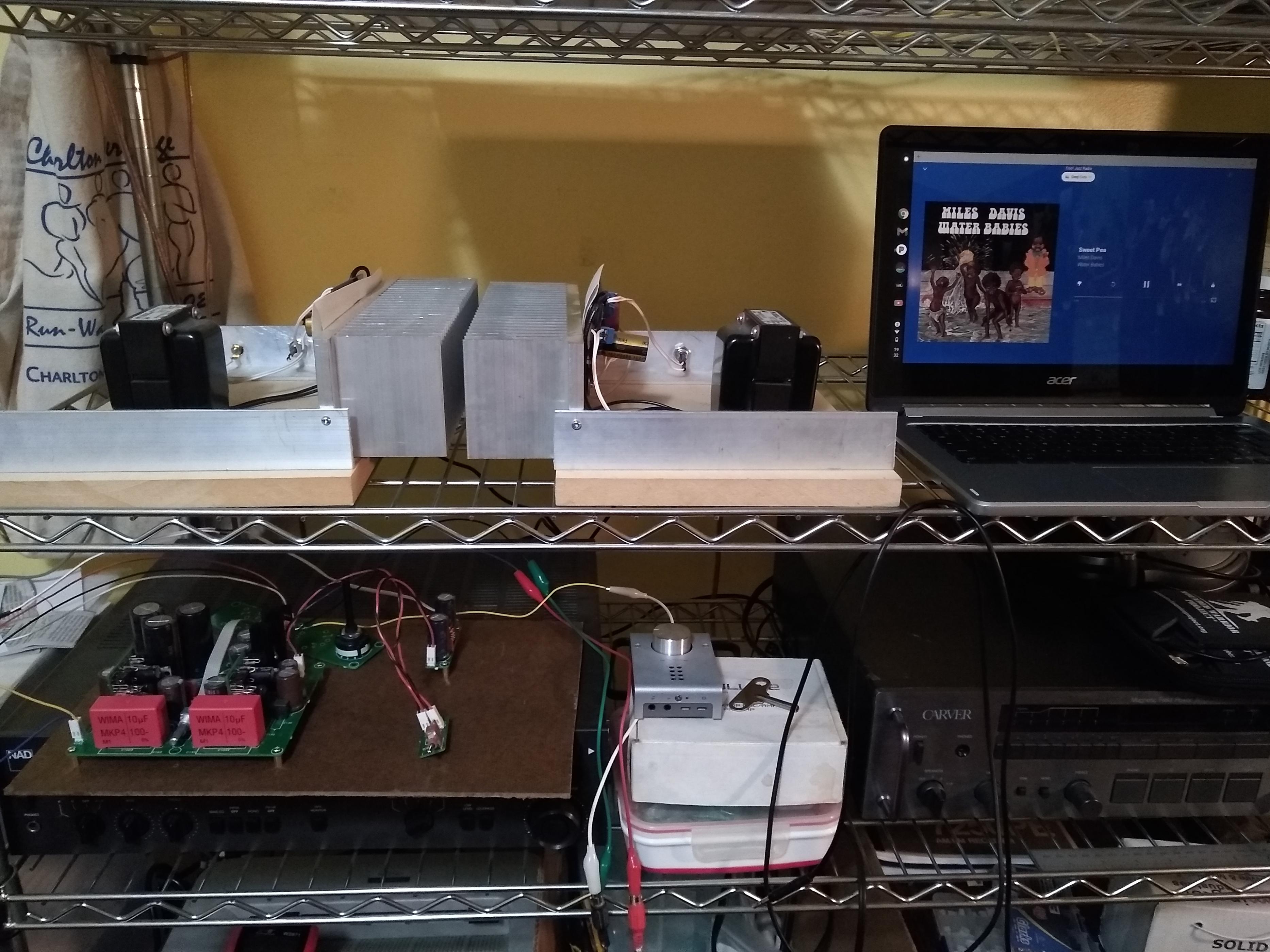

I have finished the PCBs for my preamp, but don't have everything to put it together yet (chassis and mechanicals, mostly). I thought to try a 19V laptop supply in place of my intended 48v, if only to see if any signals are getting through.
Tested with my smartphone providing a 1khz test tone, volume on max, and driving a small 8R speaker.
I didn't expect anything huge for sound, but what I got was 'scratchy', and very faint; adjusting R1021 (ALPS RK09L12B) to anything below ~75% became inaudible. I use the same phone plugged directly into my MOFO all the time with great results.
Power at the daughterboards comes in at 19.2V.
Unfortunately, I don't have an o-scope, so I can't get a picture of the output.
Can anyone suggest some test points and values to look for? I realize this is scant information, but I'm at a loss about what details to provide.

Hi Drew,
Feeding the ALP such a low voltage power source is not how this design was intended to work. You can confirm the mother board psu functionality with the daughter boards removed. But, as far as sound quality testing, it needs proper input voltage (+48vdc) for the components/transistors to work as designed.

To follow up, Vunce, the schematic indicates "<= +63VDC".
I didn't see a mention in earlier posts indicating the minimum voltage that would be reasonable for this design, but now that I think about it, there should be some floor below which the transistors (both FET and BJT) won't function well.

That’s correct what Vunce said. This preamp was designed to be powered by 48v (and as high as 55v) as designed. I have found the best performance at 48v (at the daughterboards). To do that, you need to give it about 48v plus 4v or 52v due to the voltage drop at the built in capacitance multiplier which has a 3.5v to 4v dropout.
The way I did this was to use a DC/DC step up power supply and fed that with a 12v 1000mA Class 2 linear wall wart adapter (from old school wired or wireless routers). For some reason, feeding a DCDC step up with a SMPS was noisier.
The DCDC step up has a pot and this lets you precisely adjust the voltage at the daughterboards to be 48v. Actually 48.2v was the perfect Goldilocks setting for ideal harmonic profile.
You may find that a 48v Meanwell or other SMPS has a small adjustment pot near the output for trimming the voltage. Usually the 48v units can be adjusted up to 50.2v or so. 46v is ok still.
But not 19v at the daughterboard.
The schematic shows that the simulation of the resistor setpoints are made for 48v. Besides, this was supposed to swing 40Vpp to drive 25w into 8ohms for 0dB gain power amp stages.

Did you power plus and minus rails?
Most laptop supplies + and ground only.
Hi Rolandong,
I am unsure what you mean. The schematic for the daughterboard design specifies "V+ < +63VDC" and "AGND", but I don't see an indication for a negative rail. The motherboard's main responsibility is to power the daughterboards. (It also organizes the input and output signal paths, but only to attentuate them for volume control.)
The motherboard receives power from a CLC filter, and the input to the CLC filter is indicated as "V+ SMPS".
Am I missing something?

I finally screwed up the courage and hooked up my preamp today (TH daughterboards). I'm using a Meanwell rat-tail providing 48V/1.25A, so my source voltage to the daughterboards is ~43V. Still waiting for the step-up converter to properly power it up to 48V.
I had tested voltages around, and found I had incorrectly installed R3 and R4a, and so had to rectify that.
So happy with the sound. My Chromebook is streaming Miles Davis, Cannonball Adderly, and John Coltrane and the sound is awesome.
Again, huge thanks to Hugh Dean (AKSA) for the design, xrk971 for the implementation, JPS64 for the layout, and everyone else here for their patience and dedication to these excellent designs.
Now I only have to build my own streamer, and I'll have a 100% home-built system!
