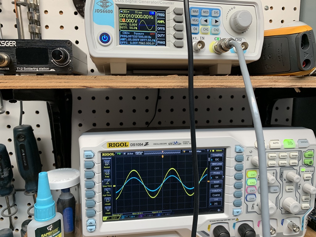

Just a quick question... With a 1.1V and 10K sine wave, the output measure roughly 19.5Vpp before the upper part of the sine wave starts squaring. Is this normal I'm not reaching close to 40Vpp? Just want to make sure I can drive the Mofo with plenty of power.

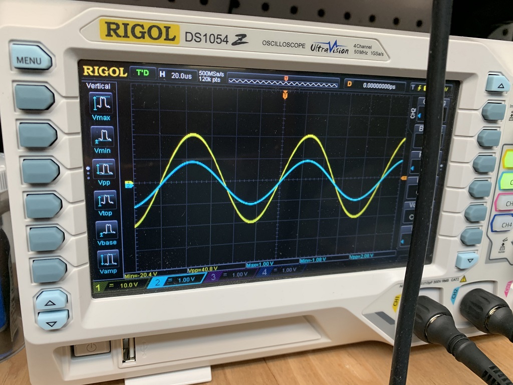

Can you provide an O-scope shot like this one? This of course shows 40Vpp as demonstration that this preamp can do that.

In the meantime, I can post a scope shot but looks like I definitely have v1 melf due to very early clipping.

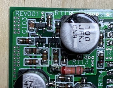

Looking at picture I posted in the link below, it clearly states REV001

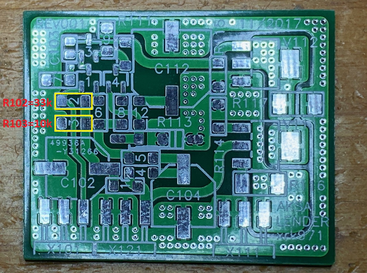

Hi Do,
It has been about 3 years since we last worked on these MELF boards so I am a bit fuzzy on the whole thing myself. I am looking at the REV001 board under a mircroscope and see that the R102 correctly goes to the base of the input LTP and R103 goes to ground. R102 needs to be 33k and R102 needs to be 10k. So can you check your board to see which resistors you have at R102 and R103? Here is a graphic to show you.
Here is the schematic:
I can't quite make out the colors (MELF resistors have terrible color contrast with the brown body, and the red is almost brown rather than red, but black is clearly black) but it looks like you may have 10k and 33k resistors swapped by accident:

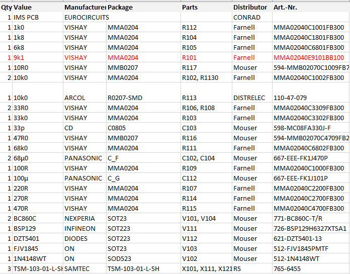

Hi Do,
The BOM is indeed wrong. R102 needs to be 33k and R103 needs to be 10k, per the schematic. When in doubt, the schemtic overules the BOM. 🙂
Sorry about that - I need to put a note in Post 1 about this error.
Hope it is not too much of a pain to swap - some hot air and tweezers and you should be good to go.
X
