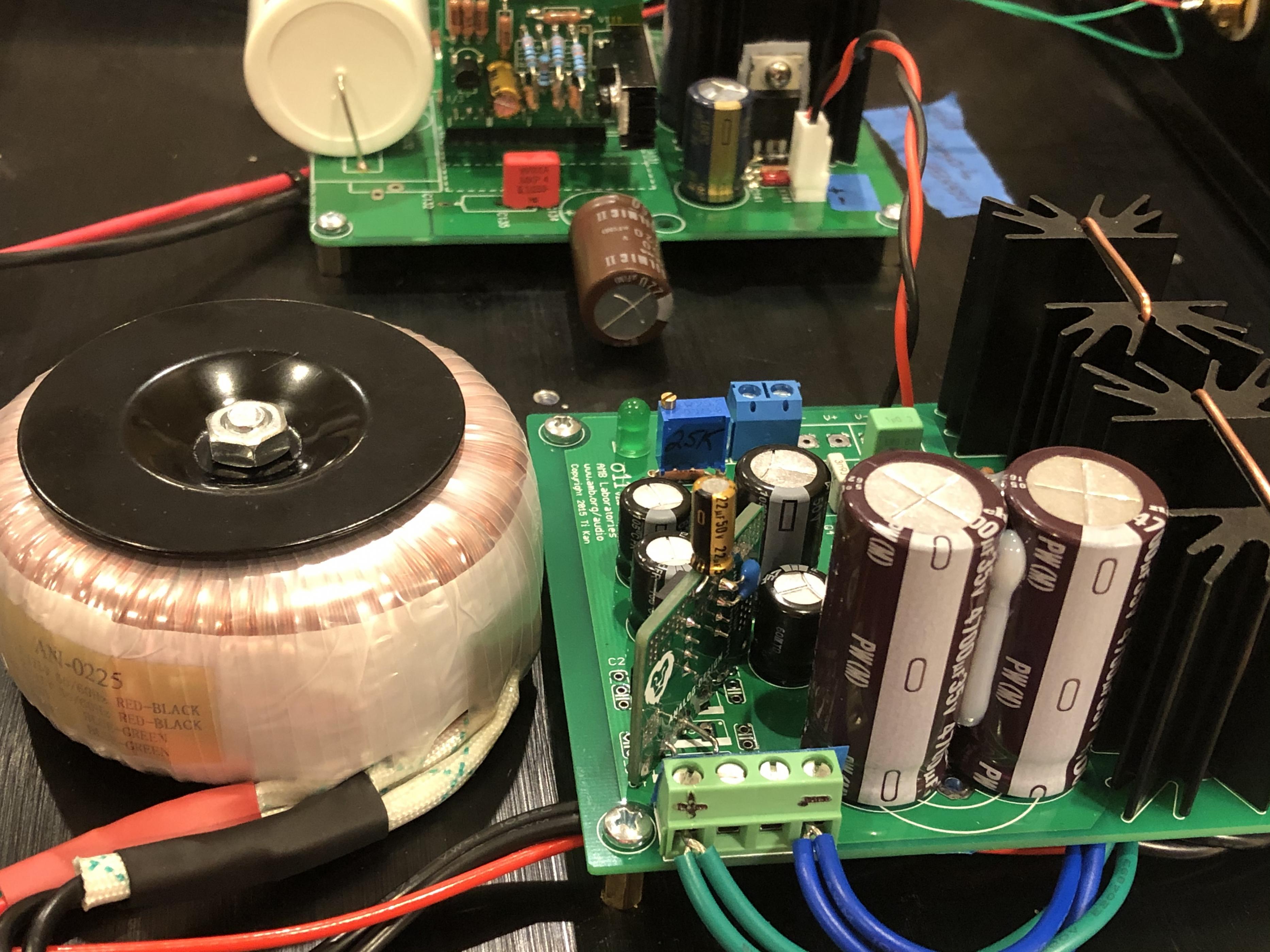

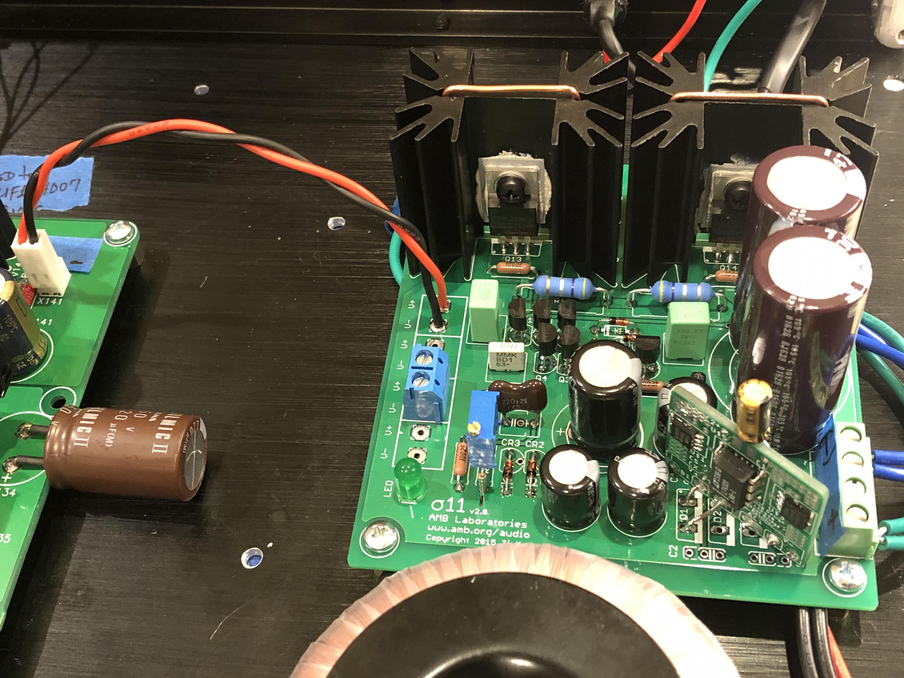

This preamp is the Tweakers Dream! I’ve been playing around with another PSU setup.

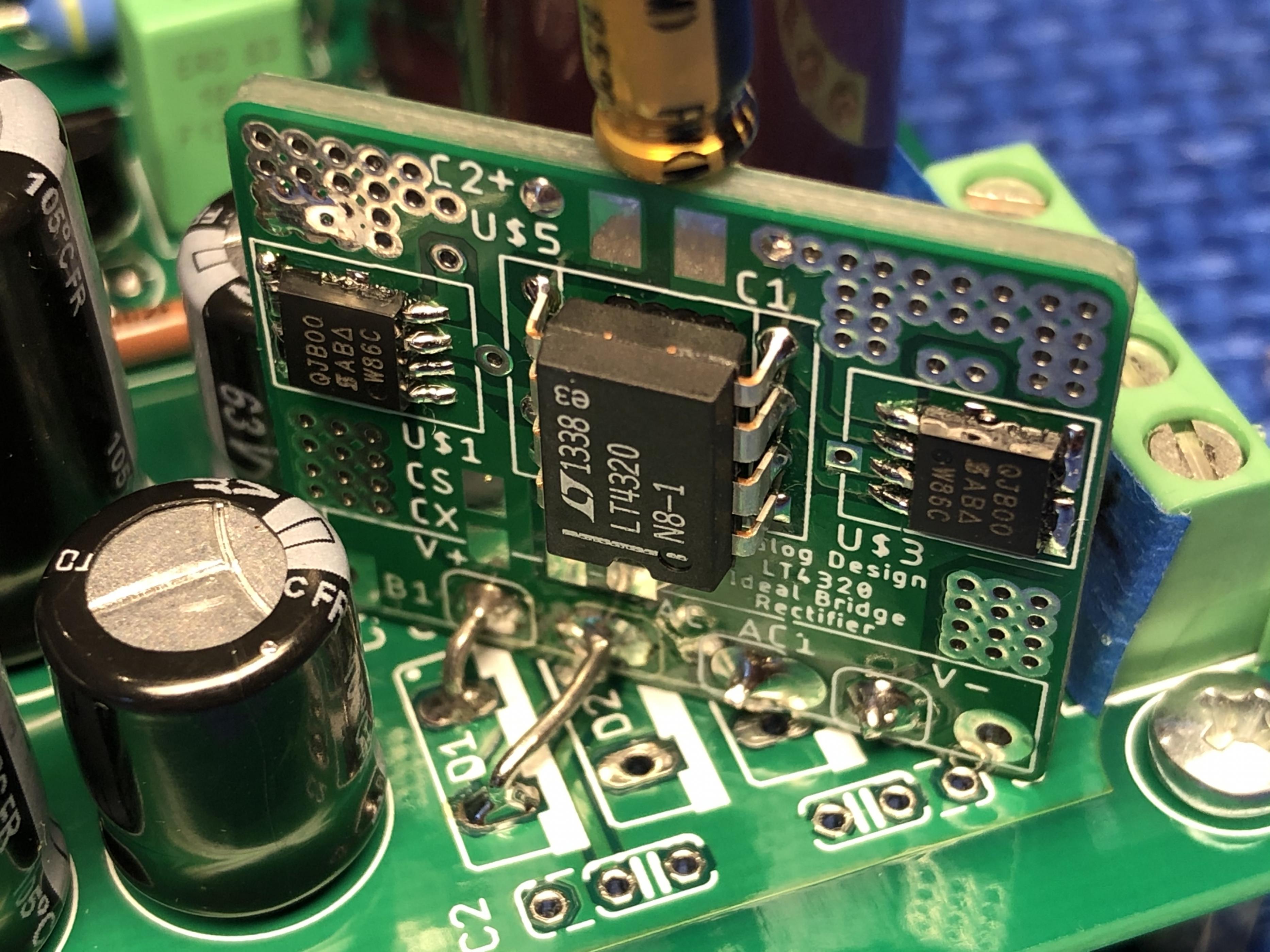

AMB Sigma11 with Prasi’s LT4320 SMT Ideal Bridge retrofitted on the Sigma11 board. Freshly fired up, I’ll get some listening hours in to see what is different.
The thick pins can be pulled and installed for either straight or 90° mounting. They do not have any electrical contact to ground, strictly for mount purposes.
I preferred these though:
MANLEY RCA Gold-plated & Teflon phono jack Brand NEW! | eBay
Are you limited to 36V with the Sigma11? I'm thinking... What if you use a Sigma22 @ 25V but don't use the gnd as reference, you should get 50V. I really like the Sigma series and use them in many projects. I like the retrofit of ideal bridge! I might end up doing this since I've got quite a few of those PCBs. The only thing is that darn LT4320, so expensive!
Do
Do
I don’t know what the AMB puts out, but looks like it’s dual rail (isolated from gnd) and Vunce has the -ve going to ground on the Aksa Lender and positive to +ve input. You need about 51v to 52v at the input. There is an on-board cap multiplier that drops 3.5v to 4v. You want about 48.2v (ideally) at the Aksa Lender daughterboard V+ input for the best performance in harmonic profile.
I can also confirm that swapping out a diode bridge rectifier for an LT4320 based one makes a very noticeable difference in amplifier sound quality. The transparency, soundstage, imaging, and noise floor all improve. It’s a no-brainer for me now. I agree the price of that LT4320 and MOSFETs isn’t cheap. But for high current applications, not using 8 TO220 MUR diodes and their required heatsinks, spacers, washers, etc - the costs are even. The complexity is way less for huge performance gain in voltage headroom and no heat.

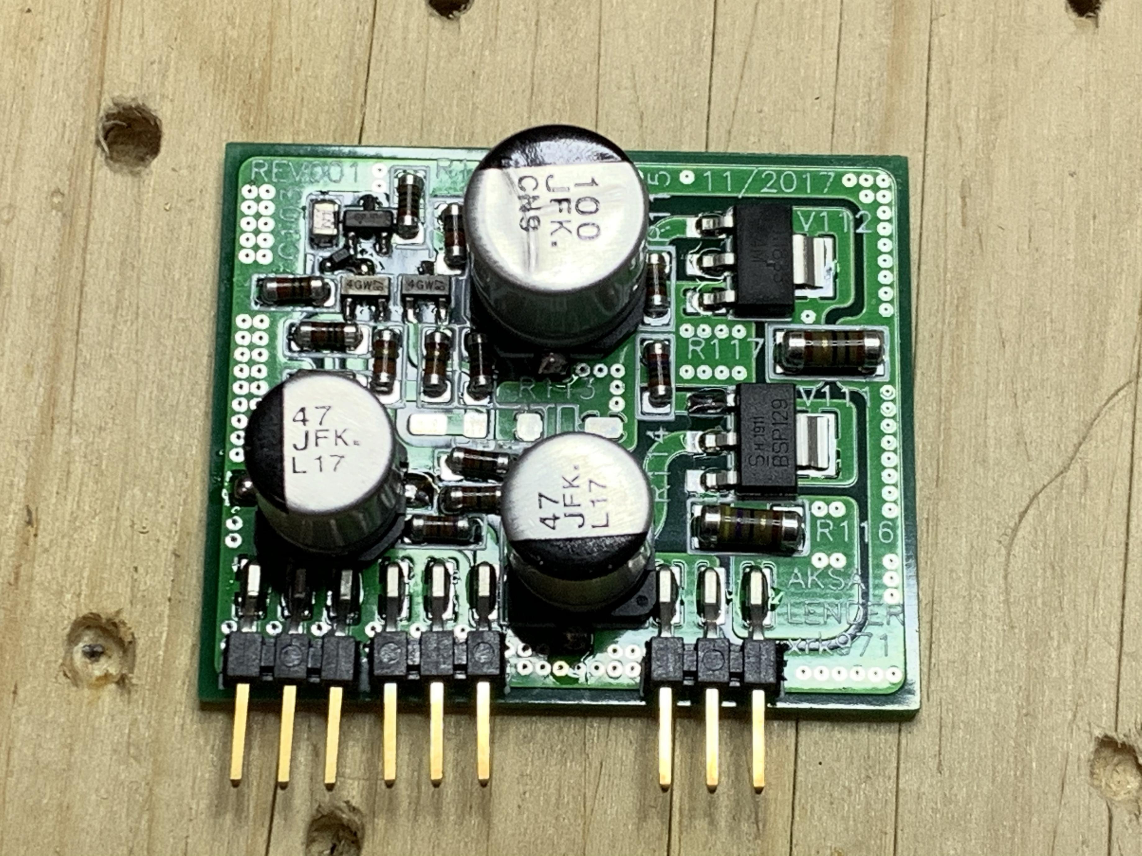

Anyone can let me know if there are transistors to match on the smd boards? I mean TH board should be similar as well.
X, Anyone?
This lowered the noise floor but did you check the harmonic profile? Is it still similar? Just curious, not crucial.
From the FFT, you can see the harmonics moved from increasing 2nd -> 3rd with a bit of 5th, to decreasing 2nd -> 3rd and everything else below the noise floor.
I don't believe I matched any transistors in my build, but it's been a while so might want to get a confirmation 😀

That diode on the upper left corner is 1mm * 2mm approximately! I had to zoom on it with my phone to find the cathode!

If you match the Hfe of the LTP's it will be more stable over a temperature range. On the Melbourne, it is more important to match if you are running DC coupled output. On this preamp, as it is cap coupled, DC offset drift doesn't matter much.
