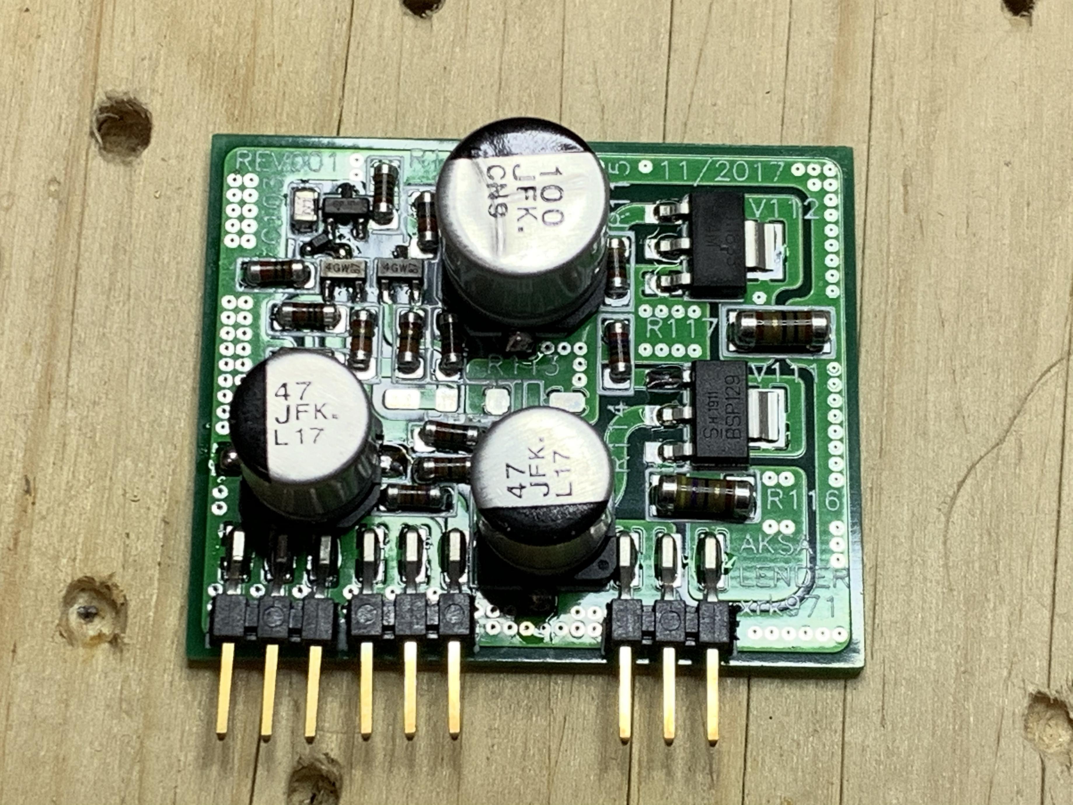

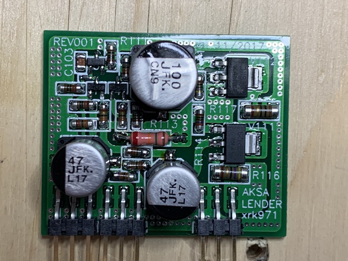

Nice work on the SMT soldering! Your probably saw this, but I think your diode is lifted up on one end and crooked. I agree that this part is a bit tight and too close to the BJT and resistor.

Hi Do,
X
Hi X,
You're right but the pad is connected there as well, so I decided to leave it as is.

When I do smd by hand (soldering iron), I can really align all the parts straight and make it even nicer but it takes way two much time this way. Rework station works nice and parts alignment is not as critical if only for my own eyes!
I would definitely use a stencil if you make some for other projects.

If you apply paste by syringe and needle, a hot plate and hot air will pretty much align parts automatically by surface tension. You can nudge stuff around with a tool while it’s on the hot plate to make alignment perfect. Soldering iron can never give beautiful solder fillets between the part and the pad like paste and hot plate or hot air rework station.
You're right but I find that when using a stencil, parts stay in their position much better and align better due to even paste distribution. I will definitely invest in a hot plate in the coming weeks.

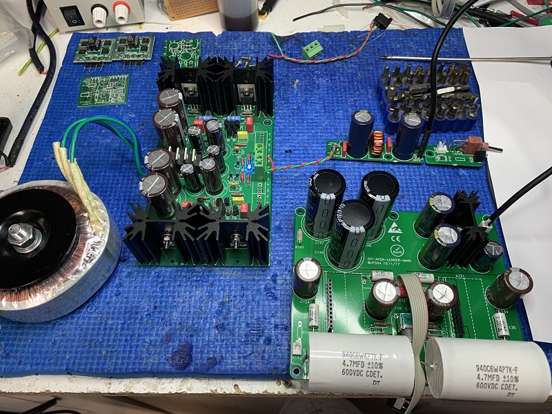

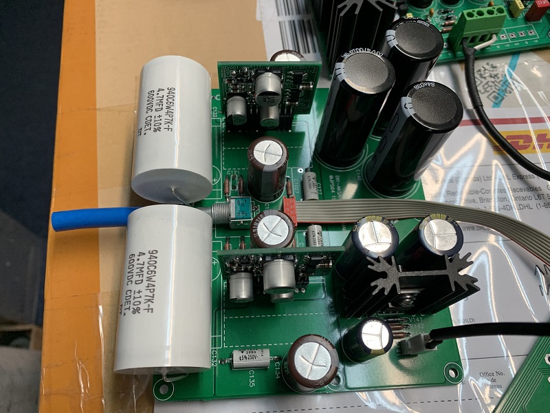

Nice work, Do! Any photos of your new baby?
I forgot what you were you going to drive with this preamp - was it MOFO?
Hi X,
I have photos that I will post later but don’t have a chassis yet. With Chinese New Year and coronavirus, it is almost impossible to get a chassis delivered... Unfortunately, until then, it will sit on a plywood piece...
Yes, it will be used to drive the MOFO but I was toying with the idea of assembling another set of SMT for use on regular (non buffer) amplifiers. So much lower gain and voltage swing. What are your thoughts on this?

That’s one of the traits that makes this preamp so good, versatility! Use your high gain DB’s for driving MoFo type amps, swap in a low gain DB and dial back the voltage to drive “regular” type amplifiers. 😀
I have two Aksa Lenders, one at 27dB and the other at 12dB. Swapping DB's is pretty easy too. For the Aksa Lender (LTP front end with AL VAS and CCS and BJT output), it needs the 48v to work as designed so no voltage adjustment necessary for the lower gain one. Just change the ground shunt resistor (Ri) and leave feedback resistor (Rf) alone. Be sure to use carbon film on the feedback resistor for the correct balance of second vs third harmonic distortion.
When using the Main Board (MB) with a PCA DB, then the voltage needs to drop to 24v.
