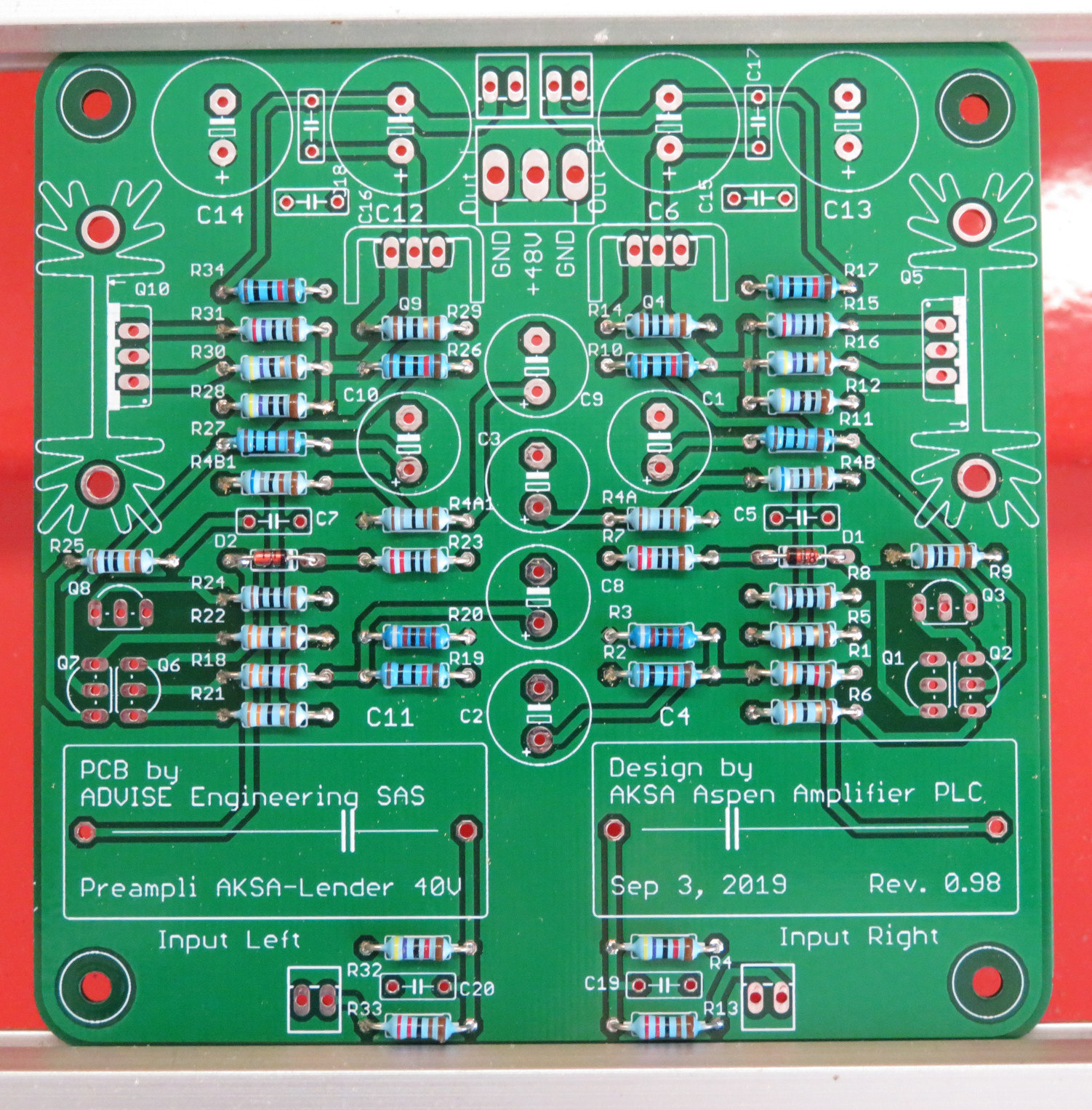

Hi Marc you may wanna have a closer look at your KAS1381 pin out, from what I can tell, the KAS1381 on your schematic is an NPN when it should really be a PNP.😱 I could be wrong as my vision is not 2020.I have received the PCB today and they look nice 🙂
Hi EmeryBB,
Your vision is quite good and you are right, I made a mistake by putting an NPN instead of a PNP transistor on the schematic 😱
These transistors make me crazy, only 3 pins and plenty of possibility to make a mistake 😡
As a result I will have to cross emitter and collector legs, the pinout is ECB, it is OK as XRK say, but the schematic was wrong !
Thanks to let me know that before I solder them 🙂
I enclosed the corrected schema and PCB of the first version but this modification must be done also for the last version of course...

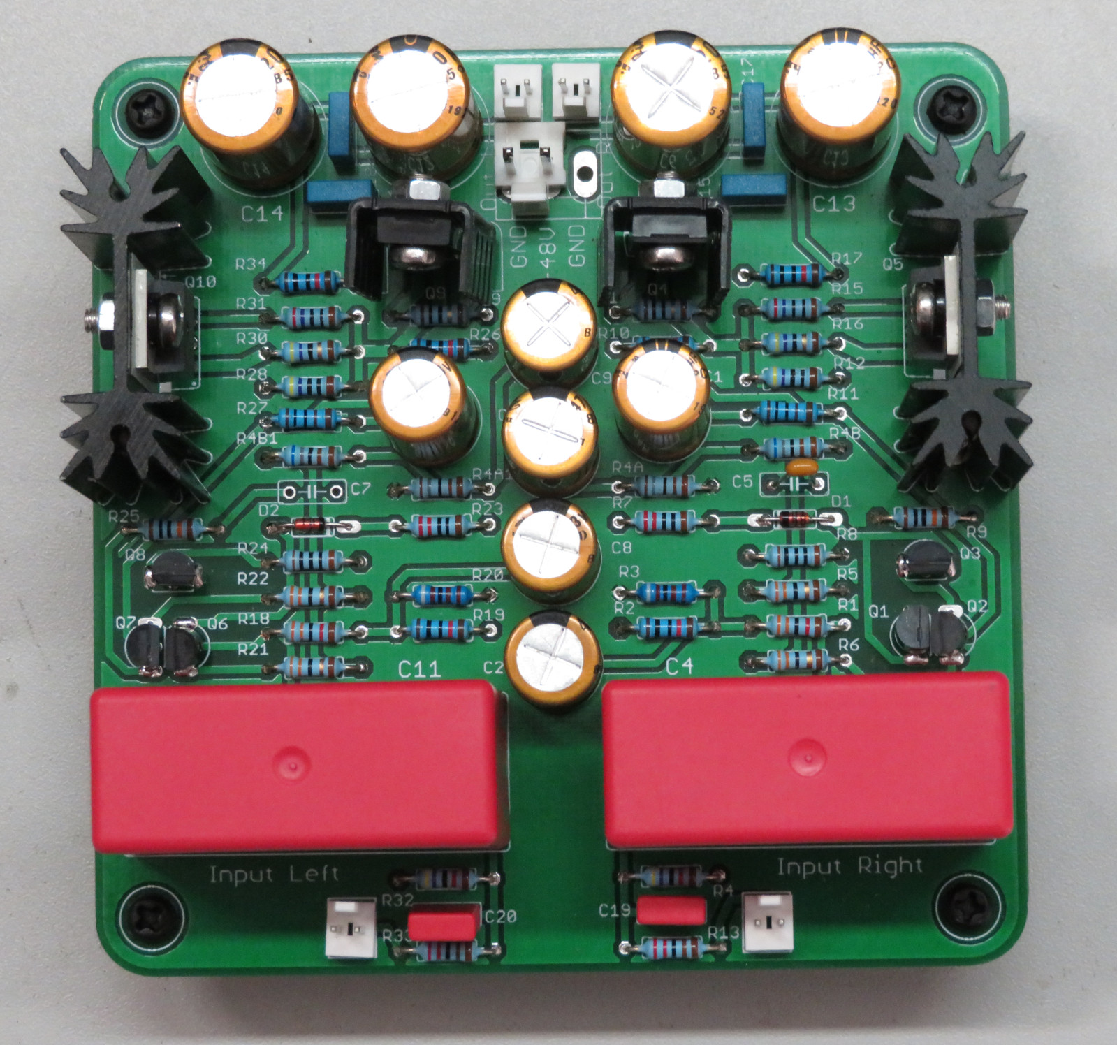

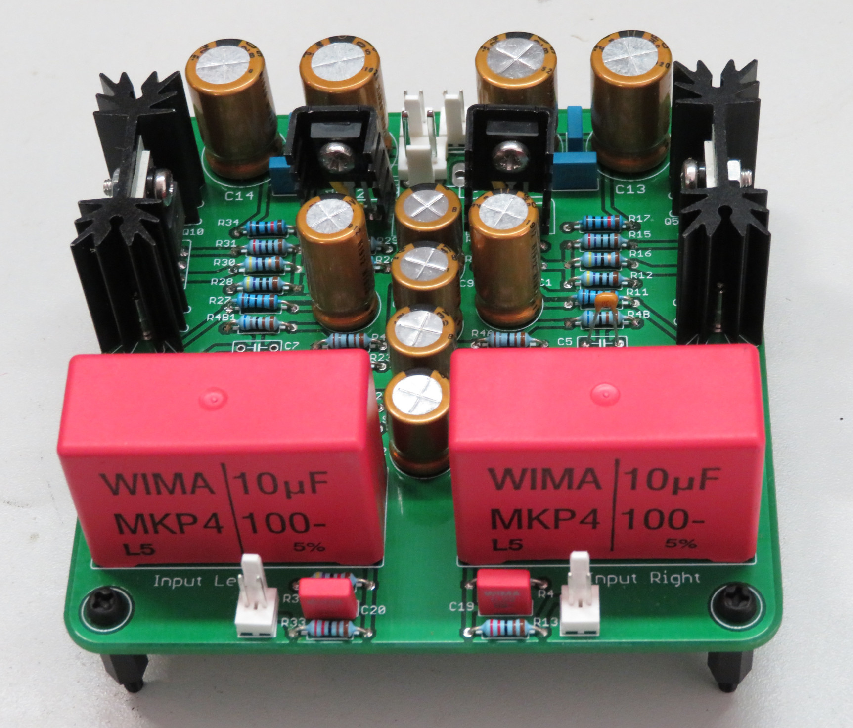

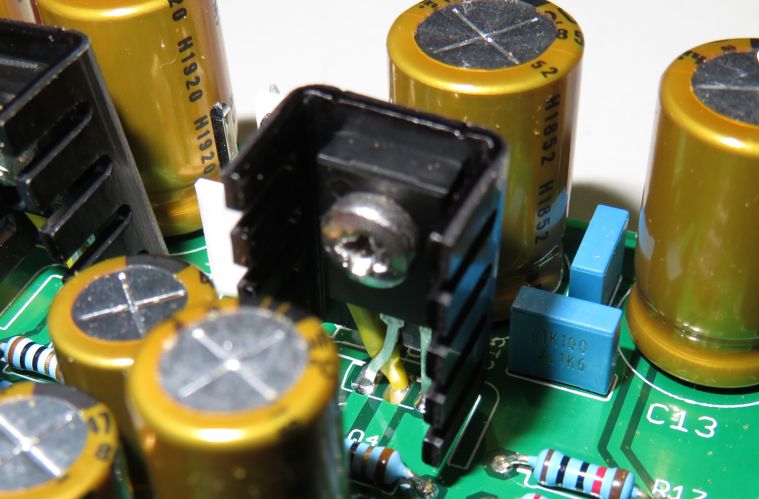

Good catch EmeryBB - crossed legs on transistor is not a big deal (shrink tube one of them) - better than an amp that doesn’t work!
The AKSA-Lender preamplifier is assembled (one 33 pF cap missing !) and the legs are crossed (see pictures) 🙄
Next step : testing 😉

Not yet started test, too busy 😡
zman01,
It is a compact PCB (10 cm x 10 cm) and big capacitors from Wima 41.5 x 17 x 29 mm ( https://www.mouser.fr/ProductDetail...dA3IHMKc%2BZFZbral7%2BzDXWUA0GoeuWPycvixH9odi ). There is an other possibility by Vishay ( https://www.mouser.fr/ProductDetail...jsyv8wssl0QBtRu1jexptDZWL2v8fWt1TAICVo7zQcQ== )... There are more options with bigger capacitors like Mundorf ( Mundorf MCap-250 10uF :: M-Cap Series :: Mundorf :: Film Foil :: Capacitors :: Passive Components :: Electronic Parts :: Banzai Music GmbH ), some version will not fit in the PCB 🙂

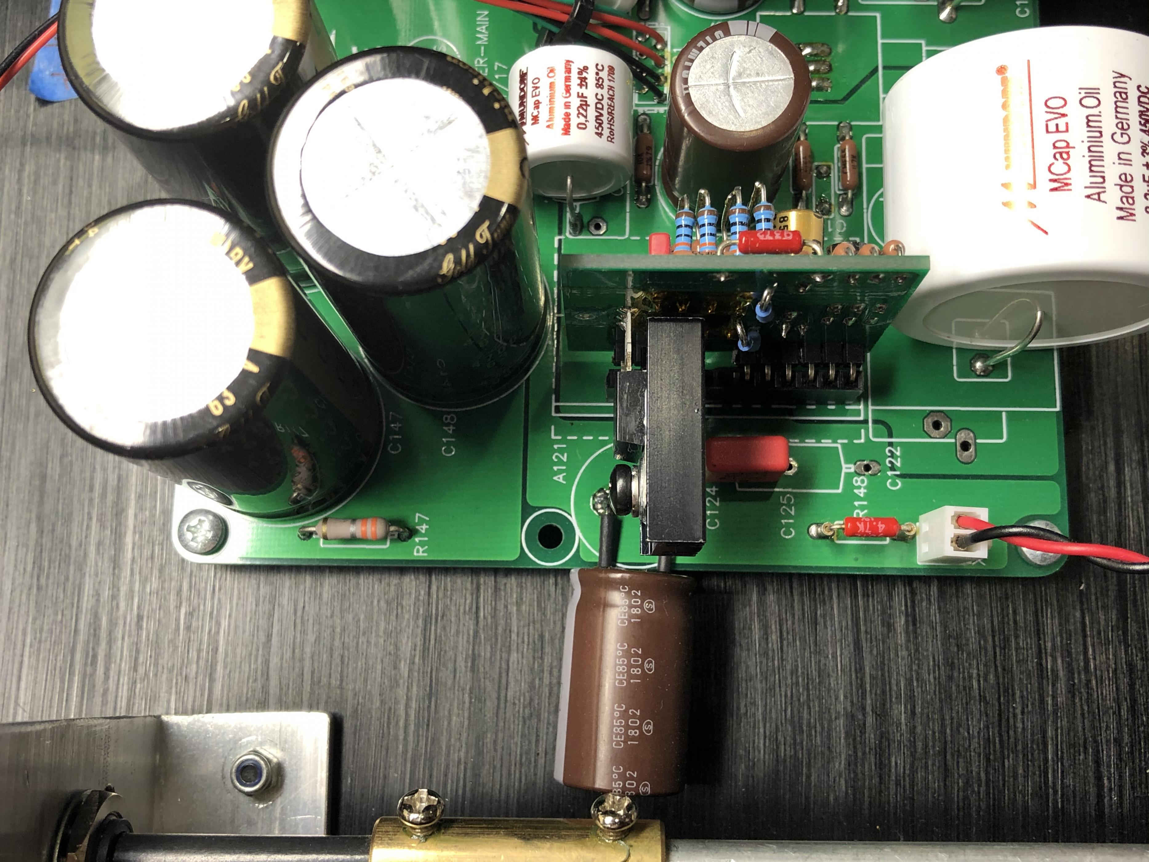

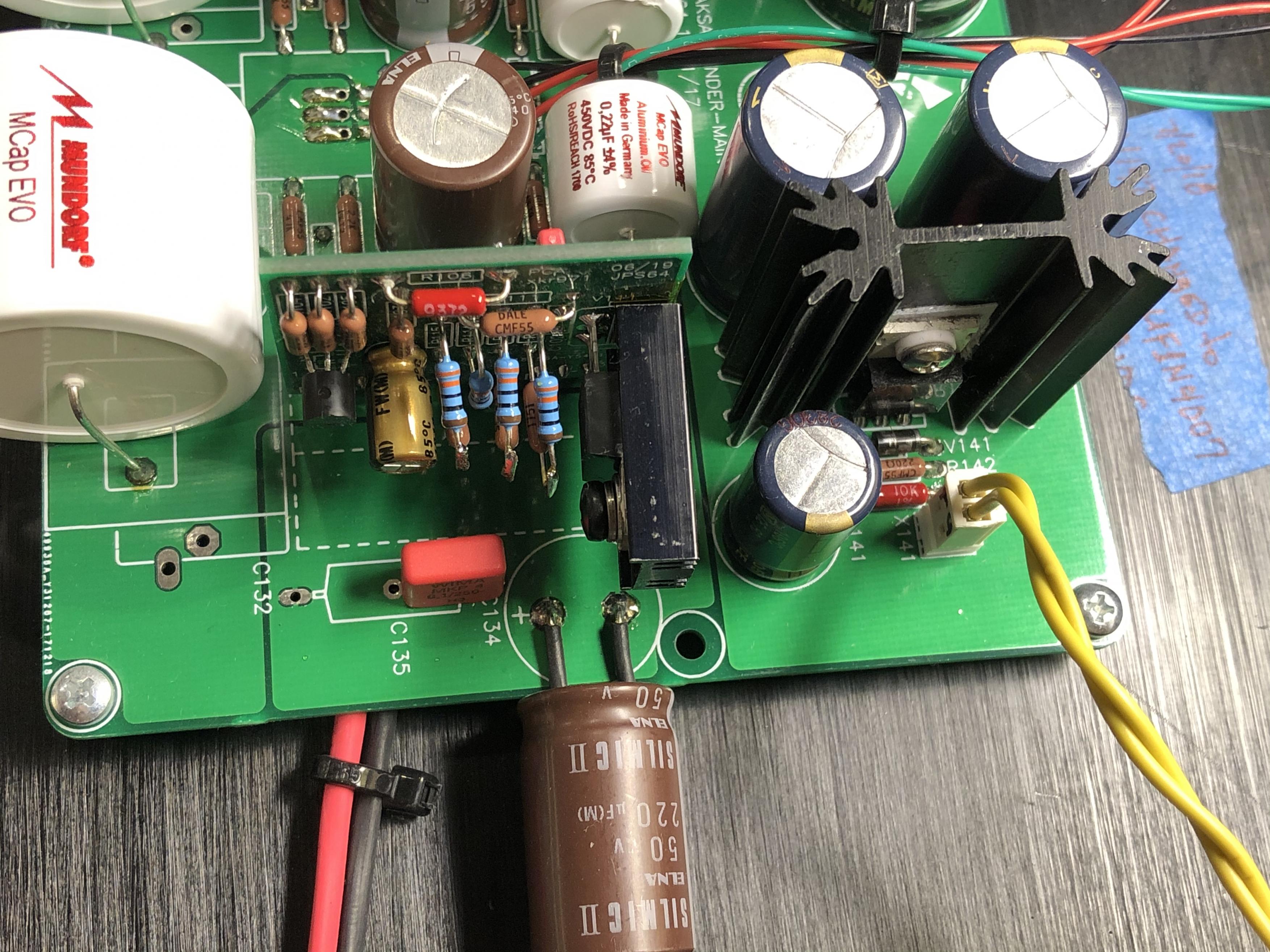

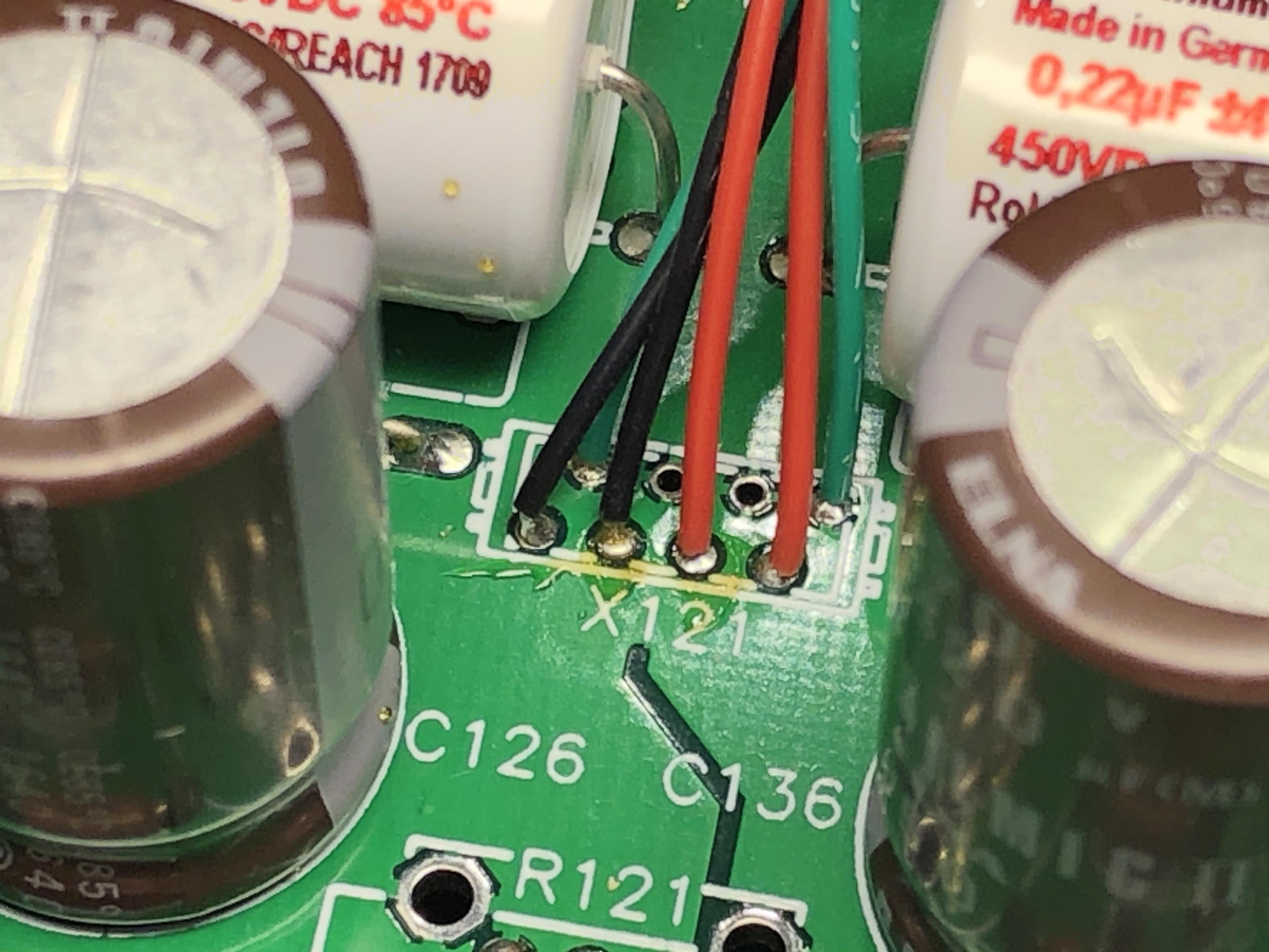

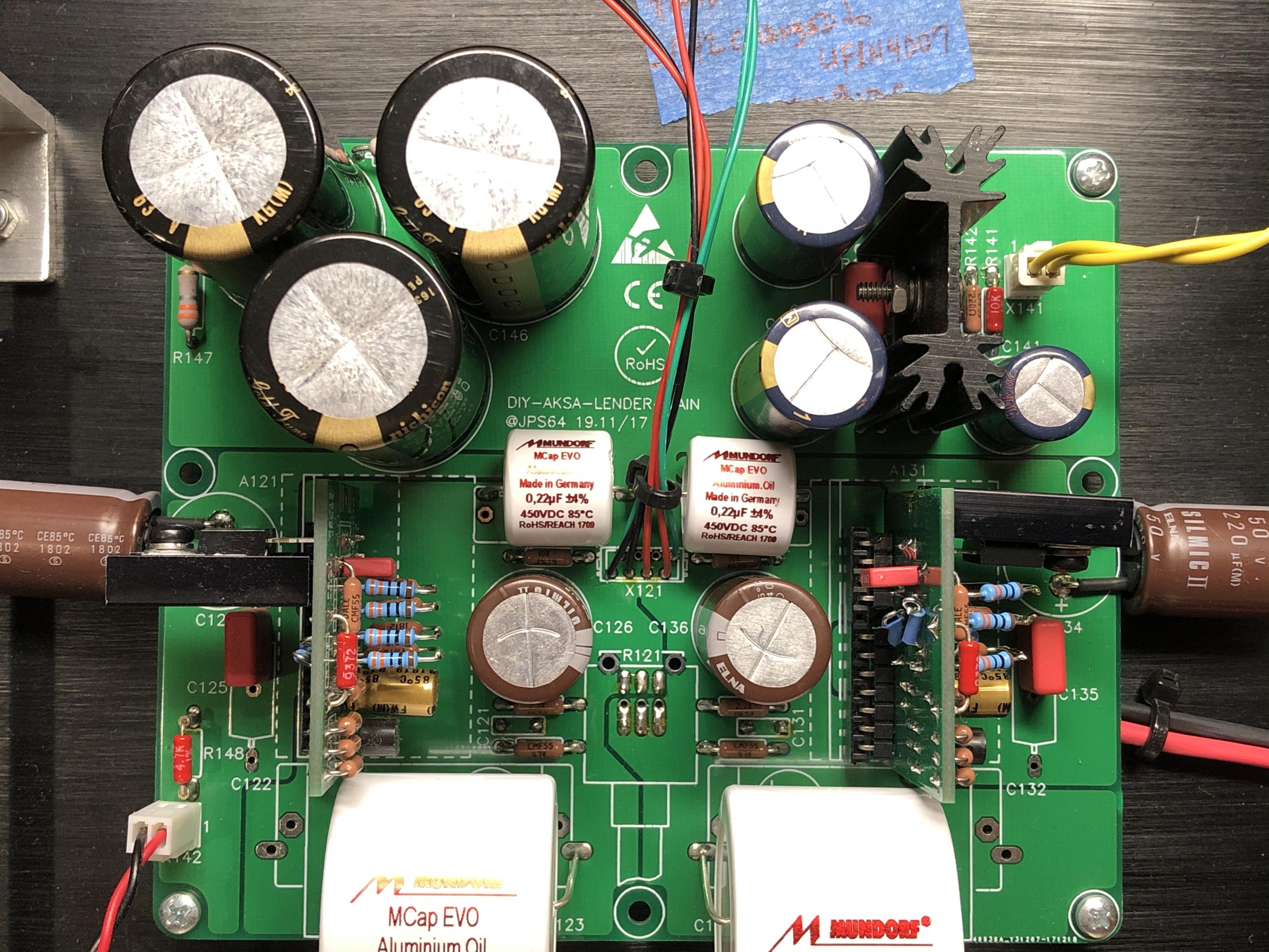

Here’s a few of my thoughts about my ALP build.
-C127/C1027 is a bypass location for the C126 electrolytic cap, pick either a box type or your favorite film cap for this location.
- For the input capacitor there are many options here, use one, either a box type or your favorite film cap with a value not lower than 4.7µF.
-Take a peek at my attached pictures to see how C124/C134 are positioned to allow room for the daughterboard heatsinks. Driving a MoFo at approximately 48-50vdc the sinks get very warm if not hot.

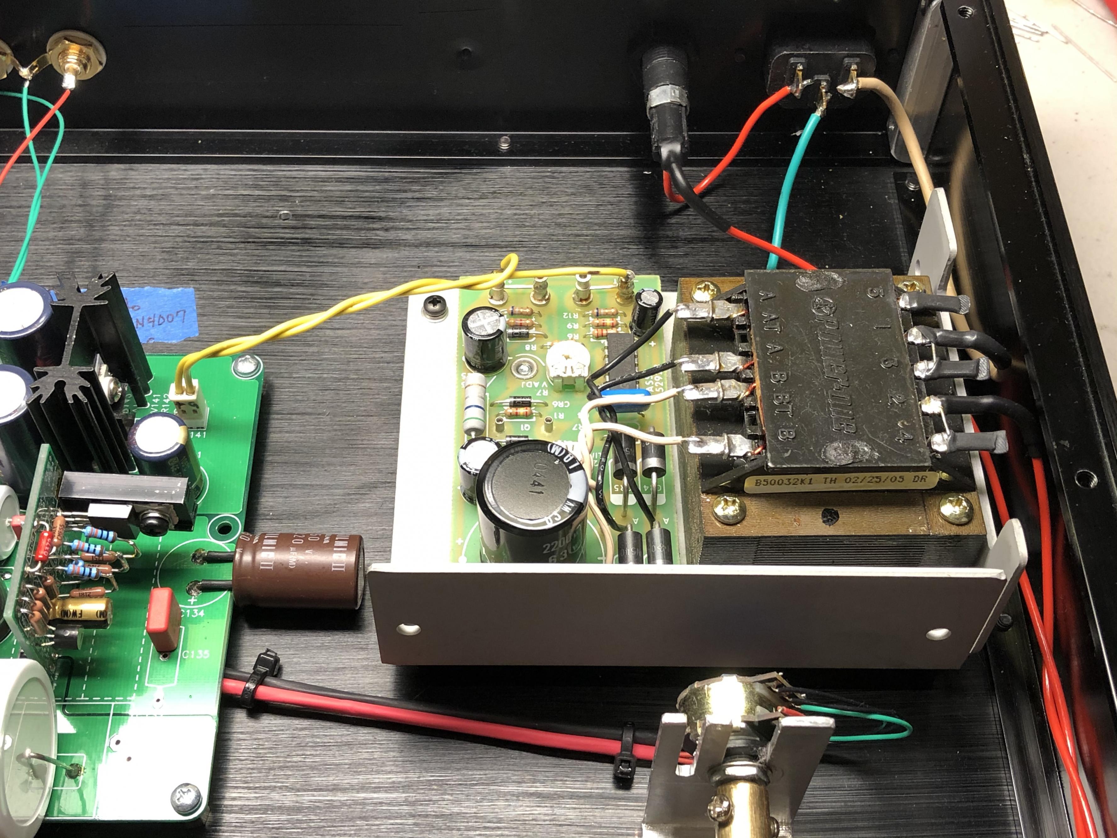

-I preferred a regulated linear PSU, the SMPS route was introducing noise in my system. Try a Bel or Power One regulated PSU, you can pick them up pretty cheap new or used. The HB48-0.5-AG has 10% adjustability via a trimpot so feeding regulated 52vdc gets you approximately 49vdc after the onboard capMX. This is the supply I use with my Big MoFo amp.
I’m currently using a 24vdc version of this power supply with my PCA daughter boards.
