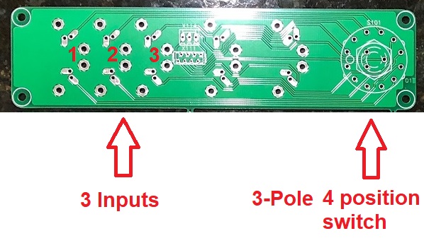

Can someone please tell me why the BOM calls for a 4-position switch when there are only 3 inputs? What happens when the switch is in the 4th position?
The fourth's also connects to the switch, like the 3 first ones while the fifth connects to the center connector. I believe to be an output, the traces must come from the center connector without passing through the switch

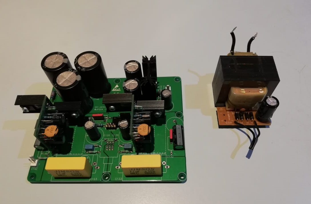

I managed to salvage a Class II linear PSU marked 12VDC 1000mA. It came out of a wall wart for a Netgear Wi-Fi access point. Haven't tested it yet.
Here it is with the Lender board for scale.
Thanks for that, GASCo. The spacing really threw me off. I'll be connecting the RCA's to the RCA/switch PCB via 2.54mm header connectors and short leads. That means I'll be able to rearrange the RCA's in a more logical manner.
That's a good transformer - although why did you remove it from its protective plastic case? Now you have to deal with line voltages, a wall plug, requisite earth grounding for electrical code, etc, and it is no longer a Class 2 (safe double insulated and essentially no risk of mains electrocution danger) transformer.
I guess if you planned on putting mains into an IEC receptacle on the case anyway, this is one way to go.
I hear you, X. Thanks for the advice. I'll be careful with the line voltages and will provide the necessary grounding, etc. I have some experience with line voltages.
I would certainly have kept the transformer inside the plastic case if I could, but the PSU is too big to fit in the preamp case with the grid/mains pins attached. The plan is to test the preamp with the transformer inside the case. If it turns out to be too noisy, I'll move it out of the preamp case and use another similar PSU that's still in the plastic case.
I've been planning for a while now to have an IEC receptacle and mains switch on the rear panel. I'm sort of practicing for the M2 that's my next project.
