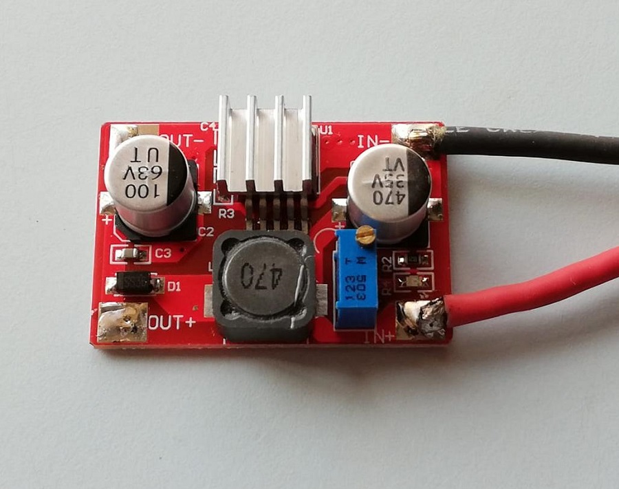

I really need to know the current consumption - for sizing the SMPS. (I went with the 15dB gain setup)
Could someone measure (or calculate) the current draw of one of these babies, please?
I can fit a Meanwell RS-15 (15W) into the available space. A higher wattage SMPS will be a problem, space-wise.
For non HPA version the current is about 35mA per channel, so 70mA total. Let’s double for good measure at 150mA. That’s at 48v so power is 7.2w. If using DC step up efficiency is 90% so need 8w. At 12v Wall smps you need 670mA.
I use 800mA 12v class 2 transformer and it works fine so this makes sense.
Thanks X. That helps a lot.
I'll be using a 5-56V, 2A step-up converter as shown below and even at 80% efficiency, the current is only 9W according to your calculation. So, the 15W SMPS will be ample. That makes life a little easier organizing everything inside the enclosure. Yes, the SMPS is going inside.
