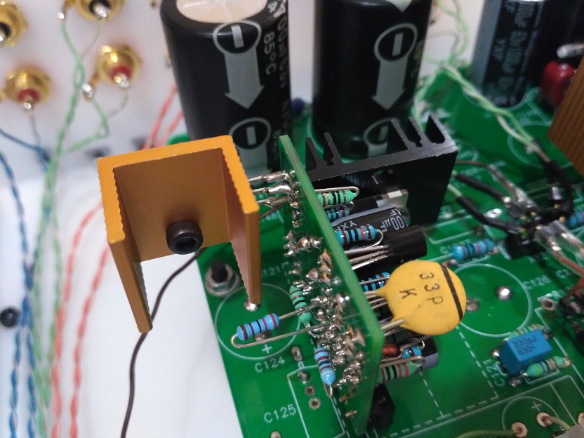

Twocents:
I had one daughterboard (TH) that I could not get working. Spent 5hrs debugging to no avail. I simply had to abandon it and make a new one in less than an hour. The new one worked fine upon first startup. Sometimes the problems are elusive indeed. I can send you a new pair of TH boards in the paper mail as a letter if you want - no charge. Should get there quickly.
Twocents:
Well thank you very much X, you are always willing to walk the extra mile! I might take you up on that. Still cannot trace the problem, but I have not given up yet. The problem is duplicated as I built the daughter boards in parallel. I also have two other options - wait for Skylar to populate his daughter boards and test them in my setup, and/or get components and populate my SMT daughter boards. I will get there ...
The BOM calls for C5 to be a mica cap. (Mouser 598-CD15ED330JO3F)
How would a ceramic cap fare there?
This one: CERAMIC DISC CAPACITOR, 33pF, 500V
I'm trying to troubleshoot Twocents' build, by checking and measuring the components (prior to populating my own boards). We have exactly the same components, because we bought together. The 33pF ceramic cap is the only item that I'm unsure of, since it deviates from the BOM by not being a mica cap.
Here is a close-up of one of his daughterboards, showing the ceramic cap.
