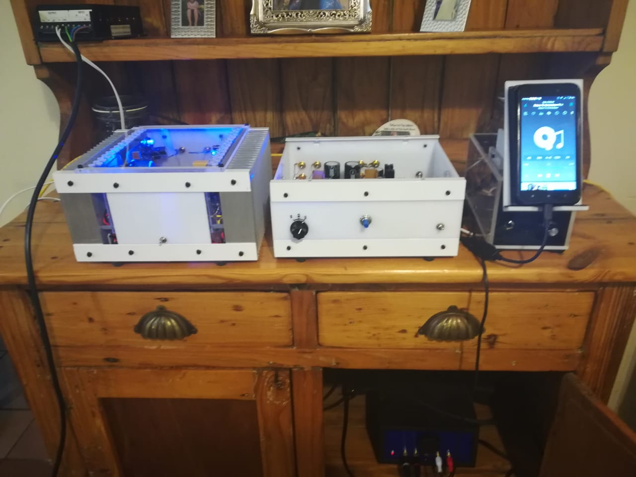

Well, at last I am happy to report that my Aksa Lender is finally working now, and working fine indeed!
Yes, I made such a stupid mistake by putting a 33r0 resistor in for R1, instead of 33k0, on both daughter boards. Somehow this one slipped through even though I measure each resistor before soldering.
The first listening test driving the ACA gave me goosebumps, it sounded so amazing. But the gain was too high for the ACA, as I still had R11 at 1k1 (2 x 2k2 resistors). To drop the gain I simply removed the one resistor so that R11 is now at 2k2. I think the value of 2k2 for R11 sets the perfect gain for the ACA as it drives my 88dB Tannoys to almost clipping at max volume with soft recordings. For most recordings I cannot turn the volume to max and normal listening levels seems to lie between 9 and 12 o’clock. For more sensitive speakers I think one can drop the gain of the Lender even more.
I am not even going to try to describe the Lender’s sound, other than it sounds simply fantastic. Like JP, I cannot stop listening. The music is just so much clearer and more dynamic than my beloved B1, and the soundstage is huge, and the bass is amazing.
Thank you X, Hugh, JP and others for making this possible and for helping me to actually build this great preamp. Here is the quick test setup - taking center stage next to my ACA.

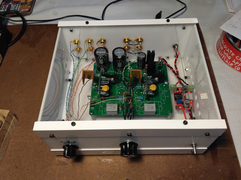

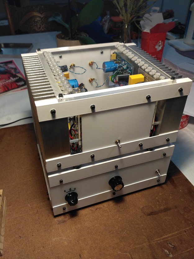

Man, this Lender preamp sounds fantastic with my ACA. Here it is all boxed up now. The enclosure is made from off-cut Perspex and angled aluminium – a common theme for my builds. The Lender box was designed to form a base for my Meccano looking ACA. Together they form an integrated mini-tower Class A amp. 😉
