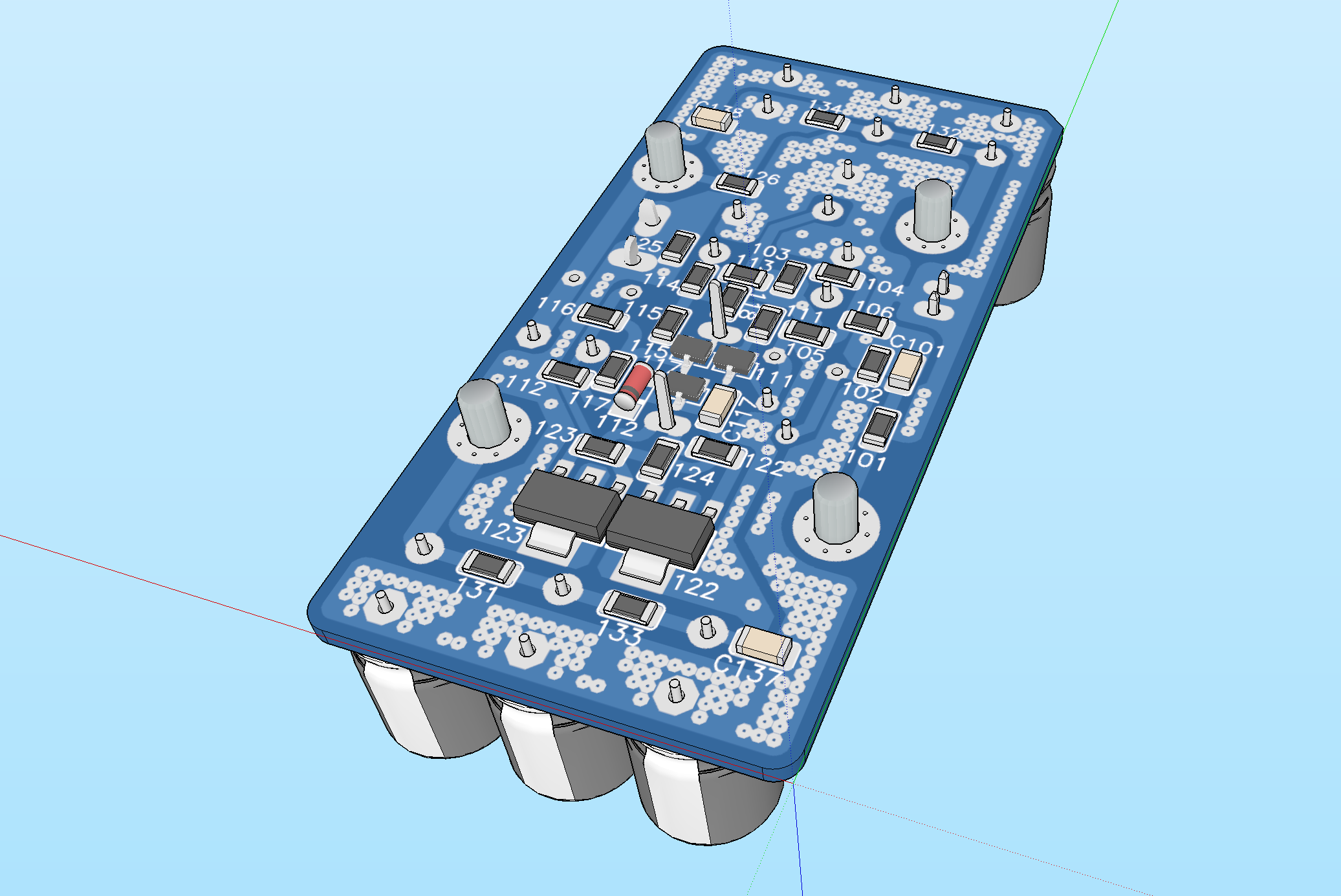

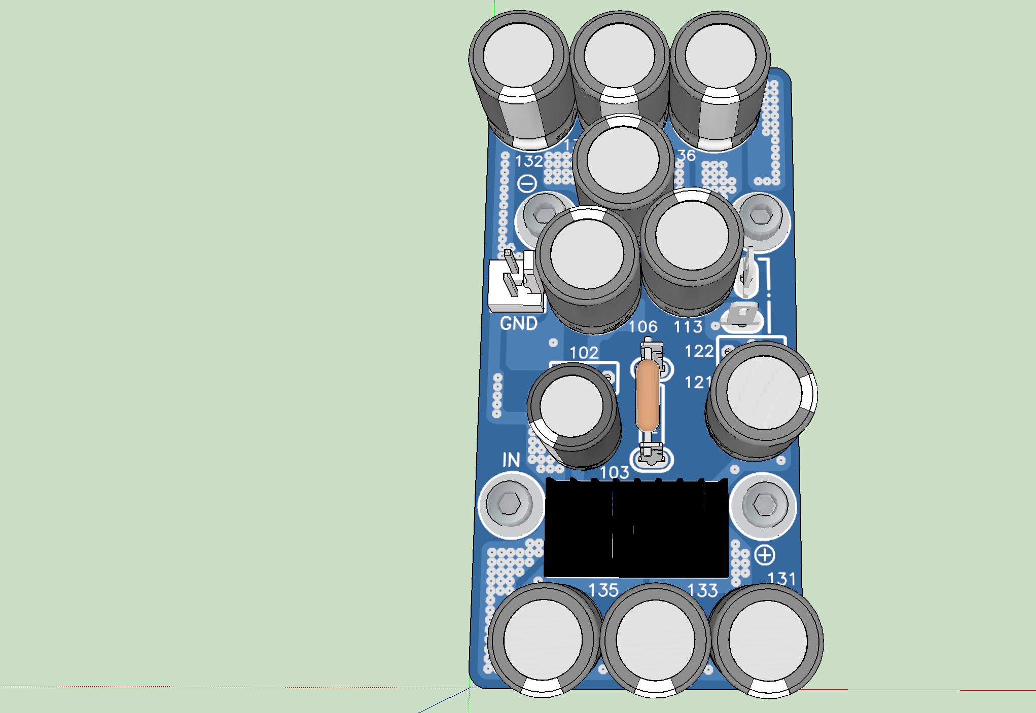

Sorry if this has been covered. but the different daughter boards, is these a difference in performance or is it purely down to preference of assembly?
Regarding DB's, it's mostly down to assembly as measured distortion between different ones are about the same. The TH version lets you add a big heatsink and use a 2SA1837 and boost bias current for headphone amp though. The miniMELF SMT version is tough to make since miniMELFs are hard to find in US at places like Mouser or Digikey - they were out of stock on lots of them so go 0805/1206 SMT if you want to make those. Technically, the SMT should have lower noise since parts are smaller and traces shorter.

can I use the transistors of the v2.0 for the HV in the regular version?
will it reduce the preformance (thd)?
The V2.0 SMT transistors will have similar THD, although I have seen that the SMT layout may have lower THD than the TH version. Use of metal thin film transistors for the outputs and feedback makes a difference though. Do not use metal oxide resistors on the feedback.
Do you mean resistors?
I saw that in the normal version, in the HV version, in the M2 hybrid version and in the M2X doughter board, the transistors are different.
AS I will go with the hybrid M2 version without edcor and with only 3 transistors, best to use are?
BC857
BC556
2N5401
KSA992
Sorry, meant resistors. I think my phone autocorrected that.
They all work about the same. 857 same as 557 butnin SOT23.
KSA992 is high Hfe but pins different than BC.
I have in stock BC559C low noise but max 30V Vce and Vcb
can I use them? should match them for Hfe
They will work fine, just match Hfe.
