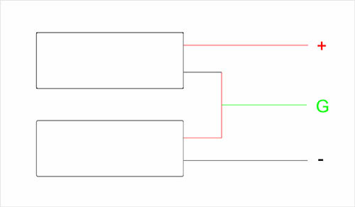

Here is an example of the improvement in noise from switching from a traditional linear trafo/bridge/CRC to a pair of 24v 5amp SMPS connected in series for a dual rail +/-24v supply for a Pass M2 driving 8vrms into 8ohms. More in this thread.
With 400VA toroidal trafo and bridge/CRC:
With two 24v 5a SMPS ($15ea) bricks:

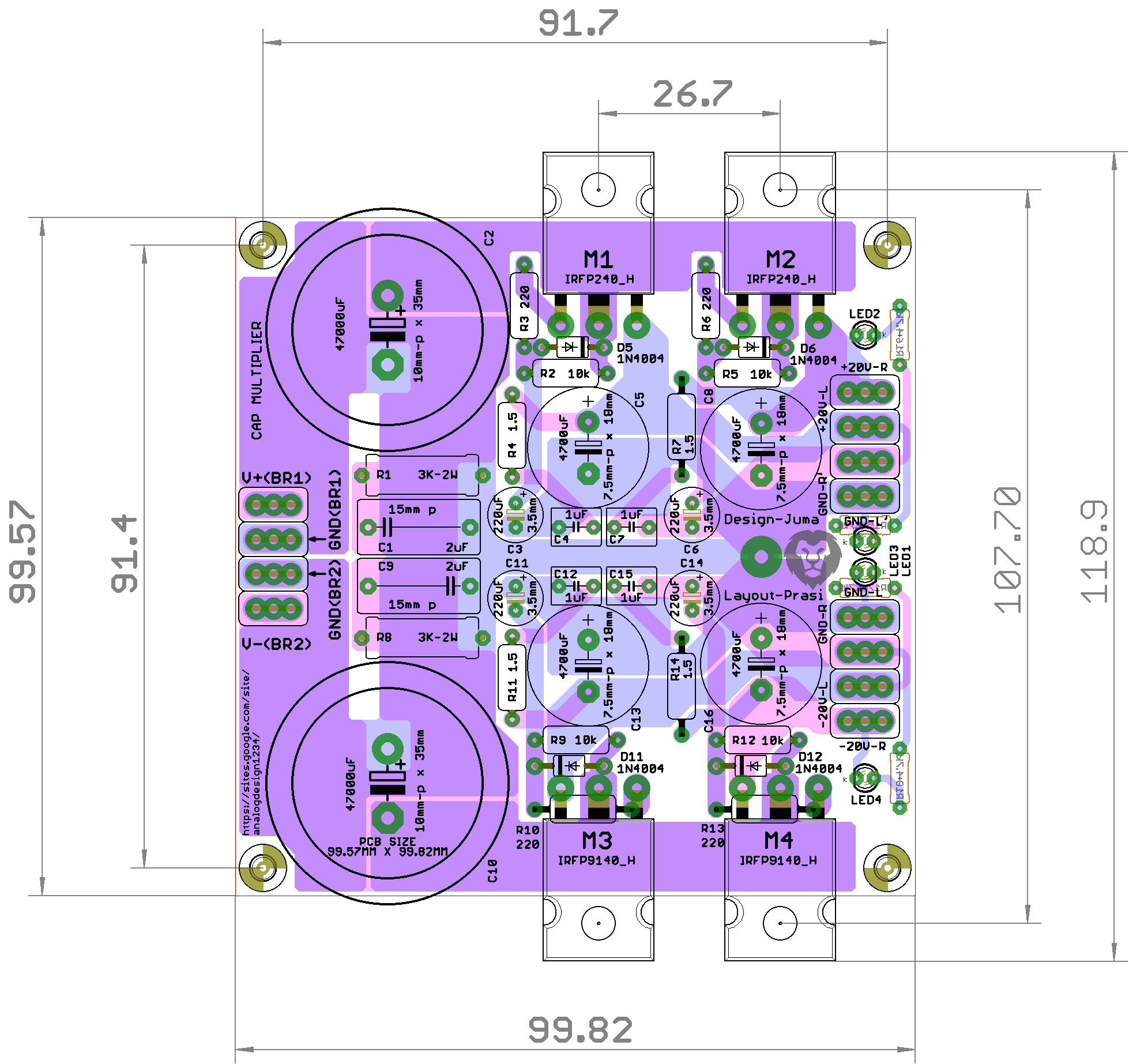

You can download a variety of Gerbers for the cap Mx from this thread. The last one by Prasi is very compact and fits on 100mm square (magic price point for cheap PCBs) and is dual rail.
Juma's Easy-Peasy Capacitance Multiplier
If you don't need looks, just dead-bug it. 8 parts and they all solder to the legs of a MOSFET:

SMPS in series ?

SMPS in series ?
Yes, close. Not absolutely needed, but add some CRC filtering to clean up and give reserve for dynamics. I have used 9600uF//0.47R//9600uF or 22,000uF//0.22R//22,000uF with 0.1uF film cap bypass at output of CRC.

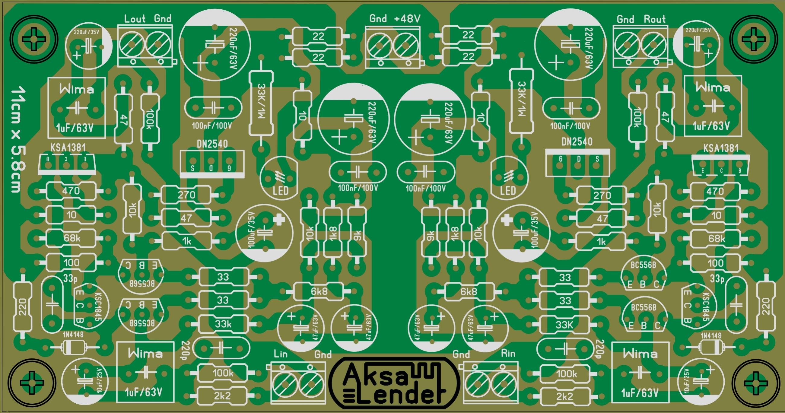

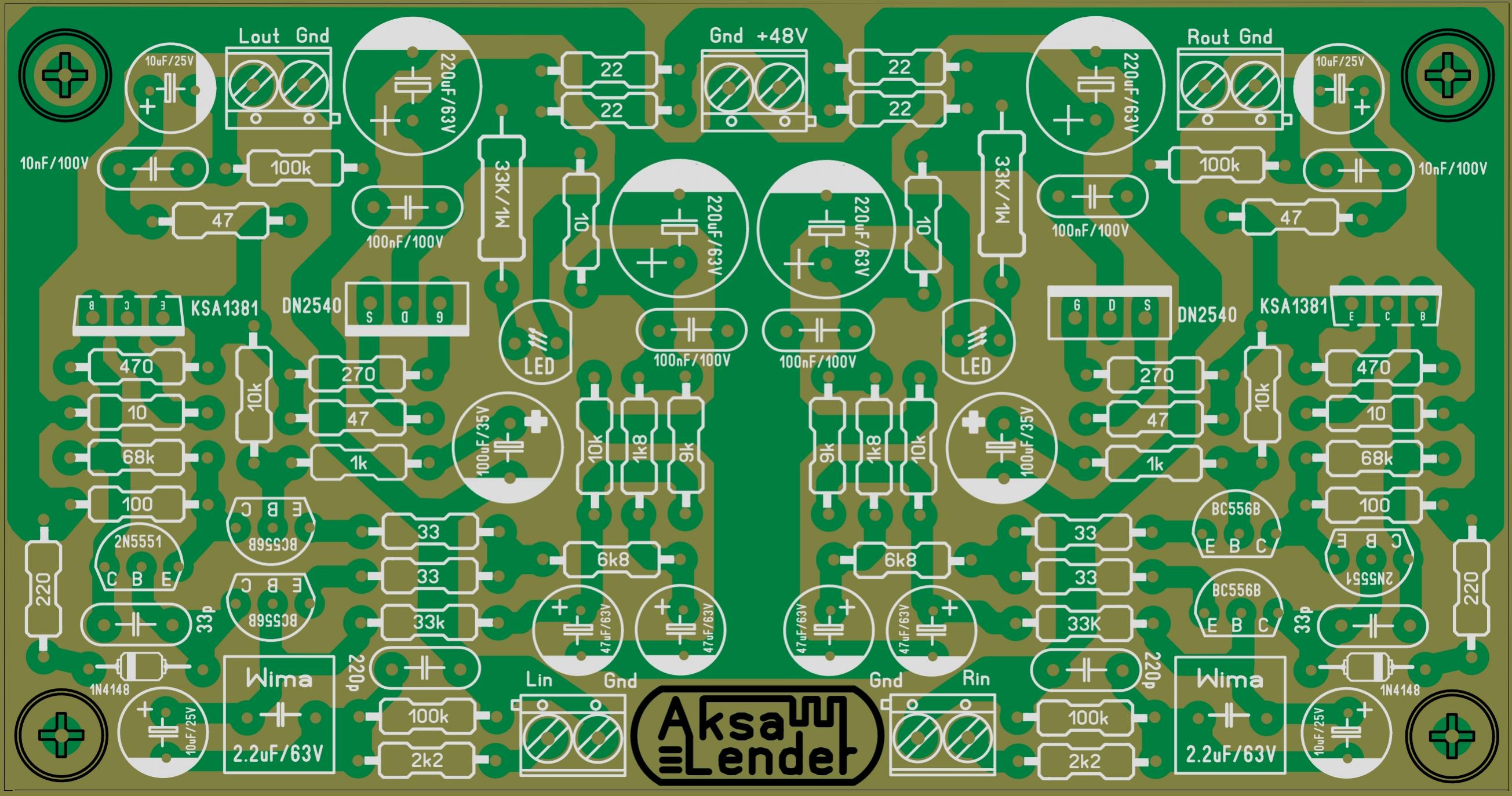

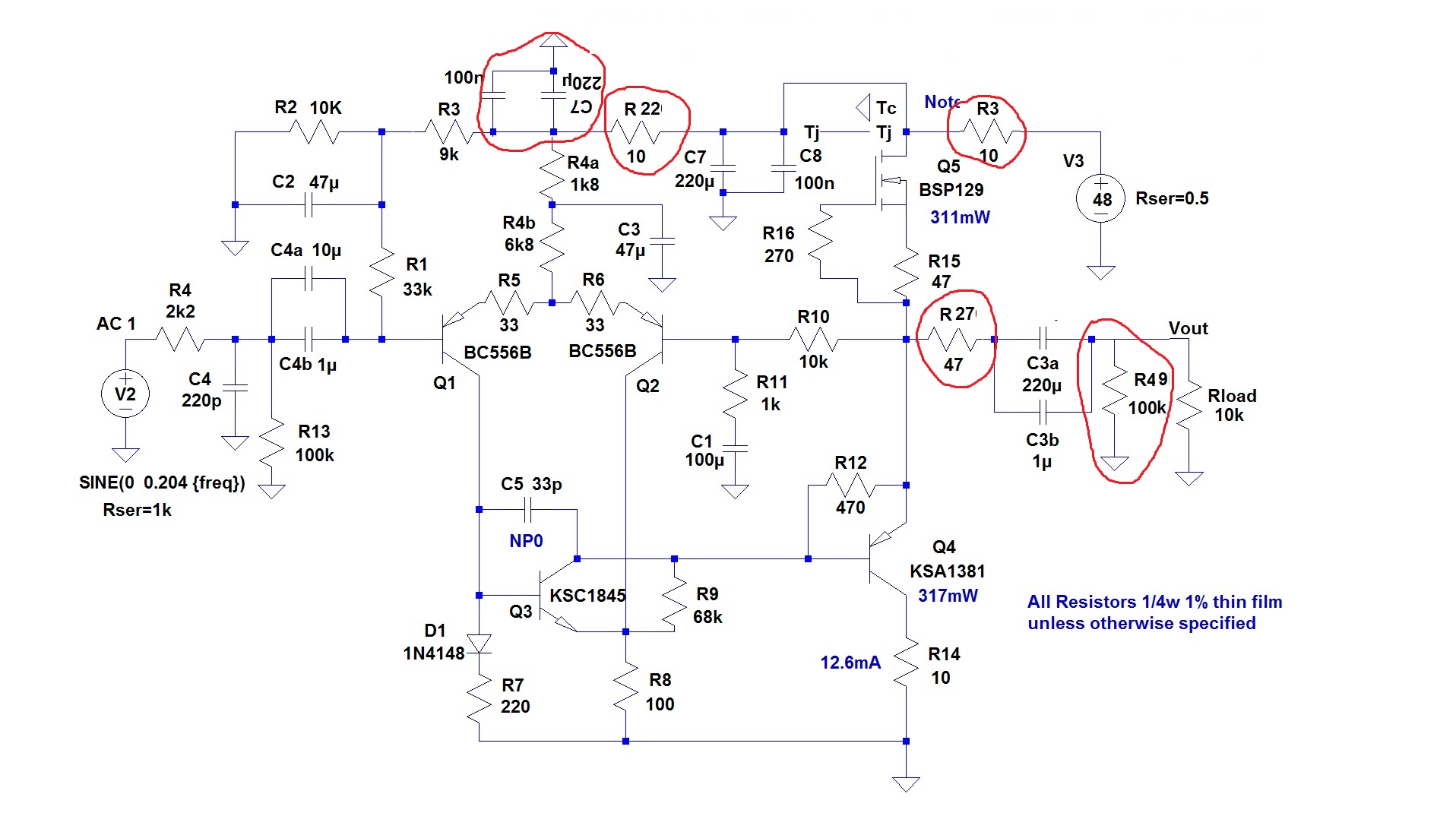

Hello.I made a stereo version -all parts throughhole- PCB.I hope its good.I replaced KSC1845 with 2N5551 (any disadvantage with this change?), added a led indicator,a 47ohm series output resistor and 2 RC networks at psu rail.What do you think?If anyone is interested i can post toner.pdf. xrk971 can you post LTspice.asc file?
Very nice! Thanks for making this, I am sure there are pdf transfer folks out there interested in this.
A few comments: the KSC1845 is a special transistor and the performance of this preamp depends on it. It's not that hard to find, quite common actually. I would make the pinout ECB to be compatible with the as-specified part and let people twist the legs of the 2N5551 if they want to swap. The label on Rout and GND are reversed. You changed many values of the resistors and coupling caps from what was shown in the original schematic, why? Perhaps label the components following the notation of the posted schematics. Else, a constructor will use the as-printed values on the silk and the preamp may not work as specified if values were followed.

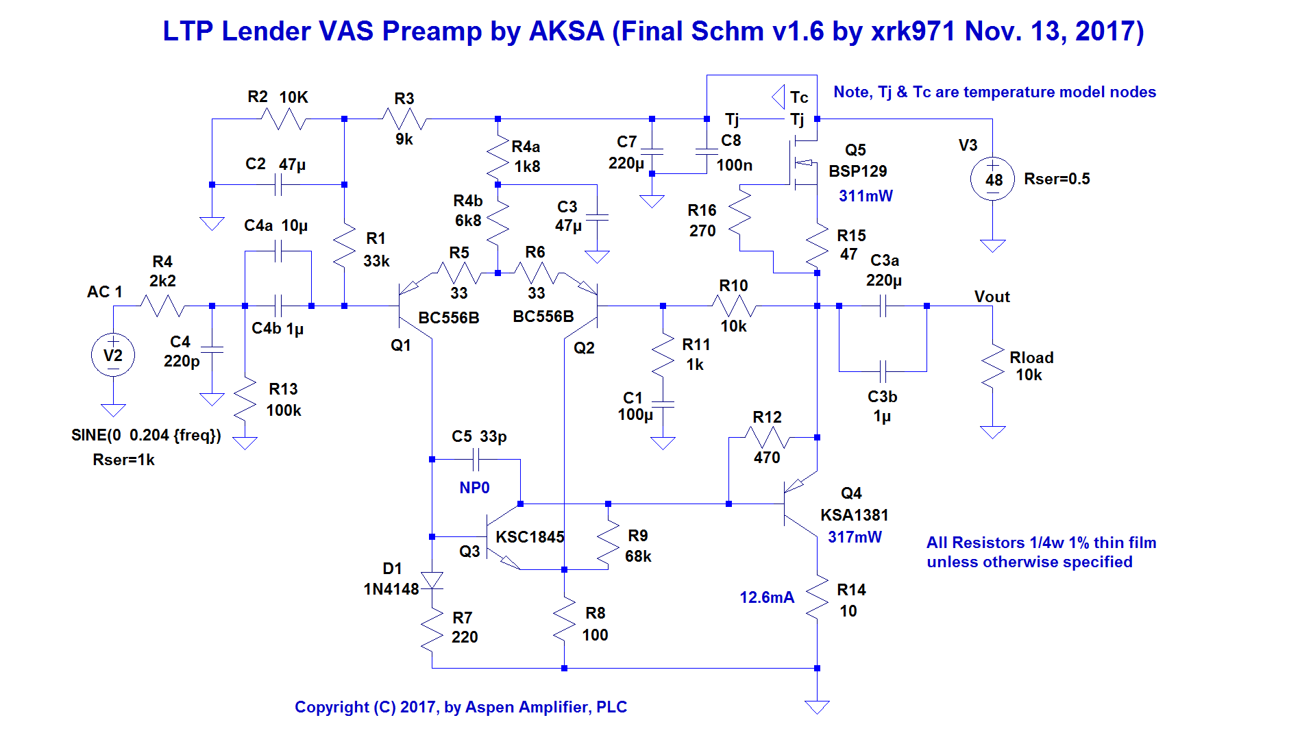

xrk971, this is the schematic i used to make the layout.i also attach the schematic with what i added.I corrected my layout.Is the schematic i used the final one?Are the values i used ok?
Ok, looks good now. Just change output 220uF cap to 50v as it sits at 24v and needs to swing up to 20v either way.

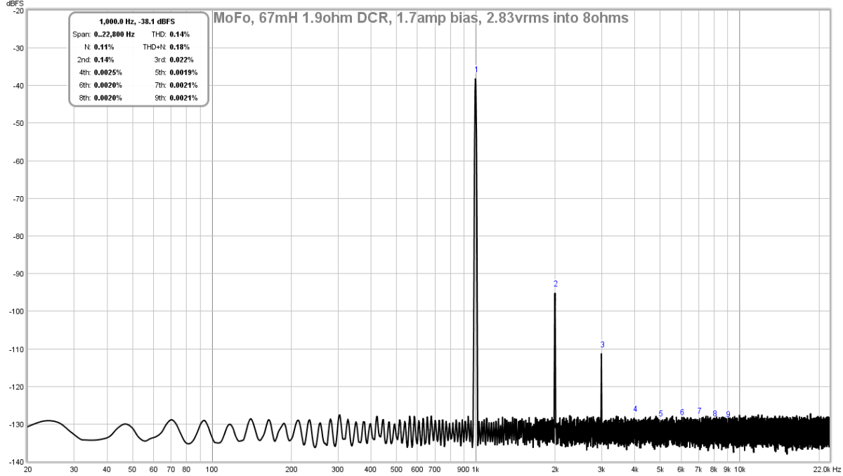

Here is an example of a 0dB gain Class A amp driven by this preamp.
http://www.diyaudio.com/forums/pass-labs/313649-build-mofo-32.html#post5263537

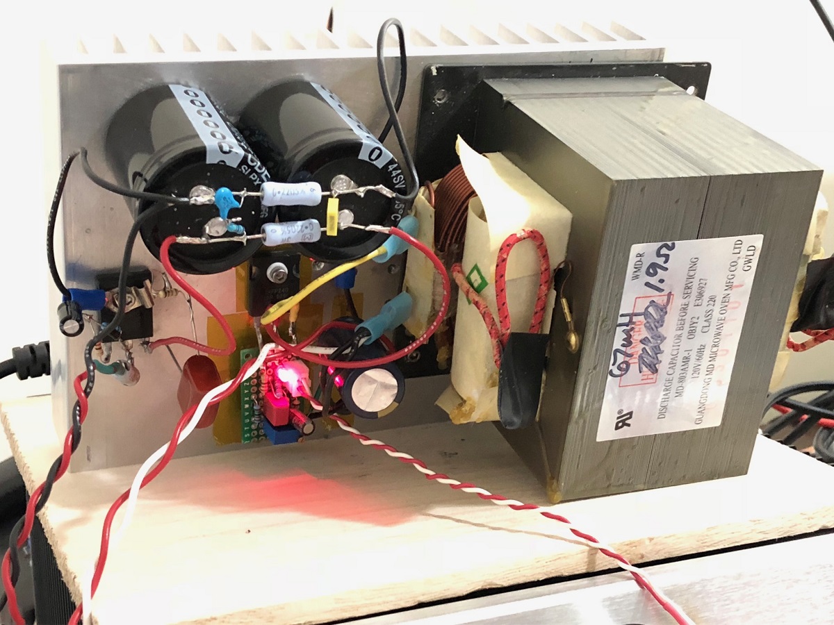

I just got an old 67mH microwave choke for it (free as it was a dead microwave I have been hanging on to for years) - sounds very nice.
