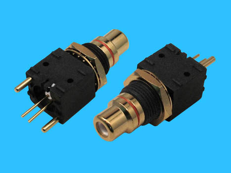

If anyone can find deals on the special RCA jacks that would be appreciated. They are currently circa $9ea from mainstream dealers. Actually, I am having a hard time finding them.
Part No: 12HP059-BLACK
Part No: 12HP059-RED
Article No LCHQRCA
Priced $9.89/pair from Hificollective. Could not find on their website.

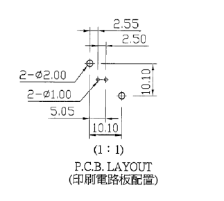

JPS64,
Can you please share with us what the 3D render of the RCA jack looks like so we can find a cheap substitute?
Or is this closer?
http://www.morethanall.com/upload/products_pdf/15646360353ace67def498.pdf
Here is the PCB pattern for the above jack.
attachment.php

Hello X,
do you´ve a price for a pair from Morethanall?
We´ve three solutions:
- GB for right RCA PCB high quality but depends on demand
- cheap RCA but will check first PCB replacement and it´s IMHO a bad choice then good preamplifier but bad connectors
- standard rear plate mounted RCA connector connected to PCB using wire
JP
@jwjarch
It´s OK. If short distance between RCA and PCB I would go with simple wire (like Mr. Pass designs).
OK, here a solution:
- use 2p. header, the same as used for X141 to replace all RCA on PCB (2.54mm pitch)
- use assembled 2 wire socket (short length if necessary)
- twist the cable and solder directly on RCA socket (use shrinking tube for isolation and secure fixation)
Photo attached (showing technique for Pass HPA I´ve built).
JP

This works well for me and lets me use the standard RCA panel jacks I have already have. So to confirm, the pitch for the pins is 2.5mm and standard 2pin JST PCB connector can be used here?
Are those Morthenal connectors the correct size? I will have to see if they are even in stock.
