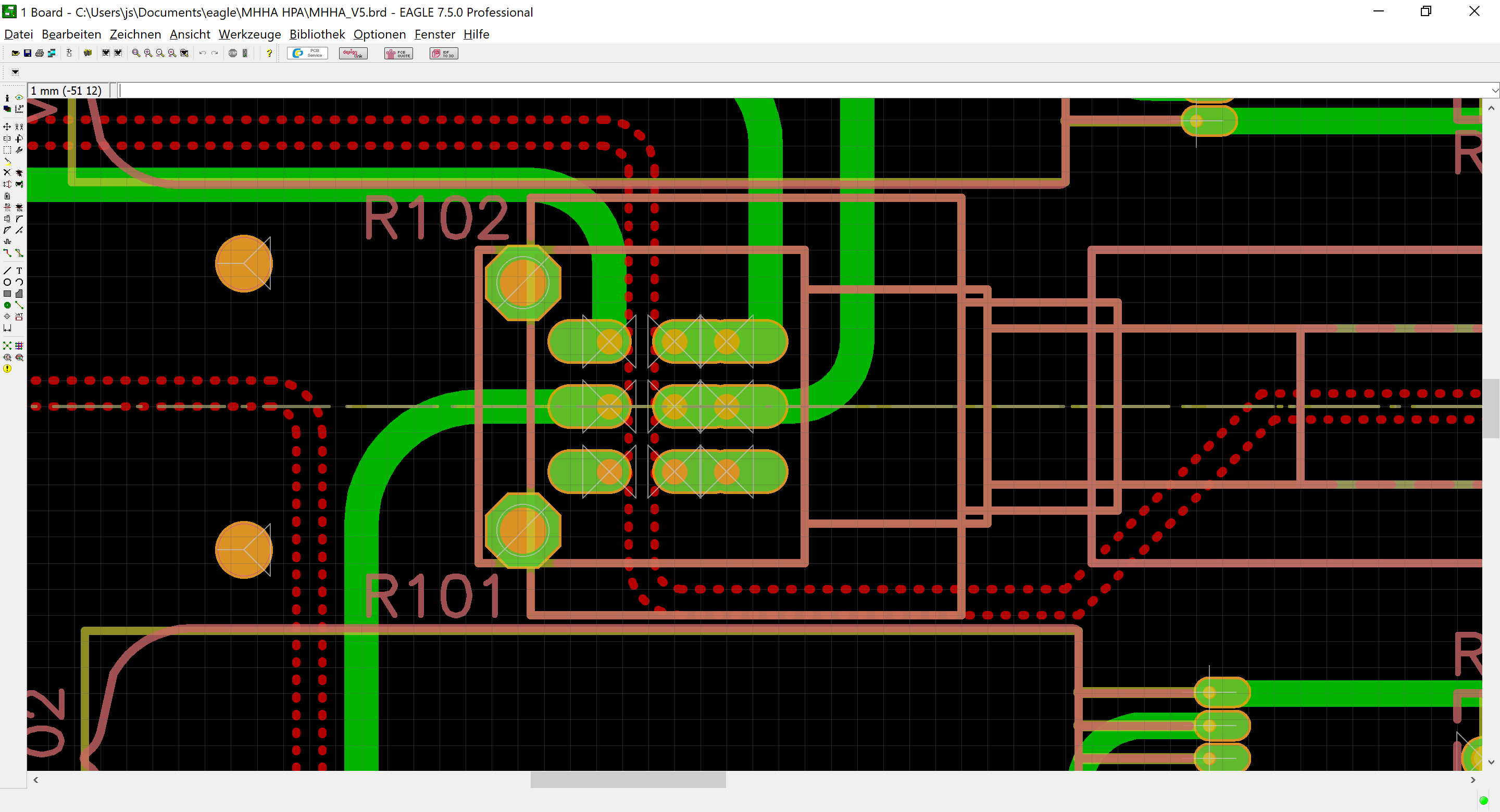

...adding a RK ALPS potentiometer in parallel to TKD one (cheaper solution).
I am sorry but I do not understand what do you mean. Two potentiometers -and different- in parallel?
X , please remove my name . Have to redraw from this groupsbuy . Hopefully I can buy some boards in a later time .
TKD (40€) or RK (4€) potentiometer and you choose what you want equipped.
Thank you for the answer.
@maty tinman
JP
Unfortunately the fab house never got back to me so I assume the production went forward. Is there a lower cost pot with same footprint/pin out? Or I suppose we can always go flying leads.
Hi X,
or drill carefully 3 holes for signal in existing pads (signal and soldering on bottom side) and the 2 mechanical grounded pads (soldering on top side). I´ve done this operation on breadboard.
I could supply the template.
JP
JP
Ok, I can handle drilling. A Dremel too drill pretty handy for stuff like this. So the copper tracks are already there and only need holes to make it work?

Hi X,
JP
Hi JP,
They were able to halt the production - please get me the revised Gerbers with RK09 holes and I will redo the order.
Thanks,
X
