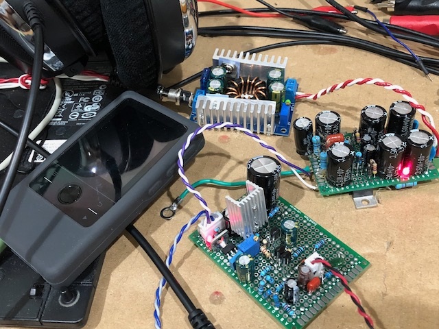

I just tested this preamp as a headphone amp and it works very well. I installed a 2SA1837 as the output BJT (vs the KSA1381) and dropped Vcc to 24v and bias to 80mA across a 2.2R source resistor on the 2SA1837. Also installed 2200uF 50v output cap to get bass response lower. Listened to a bunch of tracks using DT880-250 in pseudo stereo so amp sees 125ohms load (L&R driven in parallel). It runs dead quiet.
