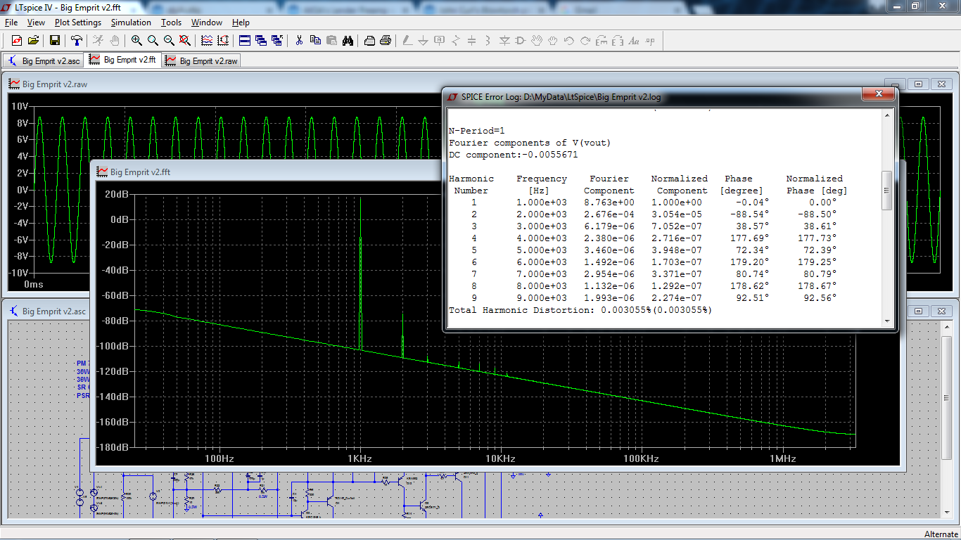

Inspired by this thread, I modify my Emprit amplifier.
This is the simulation result: output about 8Vp 1kHz at 8 Ohm load.
Thank you, X. You should make a version of general pre-amp from this pre-amp (gain 2x - 4x). You proved it is stable for 2x gain. Please fine tuning it. It is very good pre-amp.
That’s a great result Bimo. You are asking what FFT would measure at 4x (12dB) gain? Currently it is 21dB I think.
