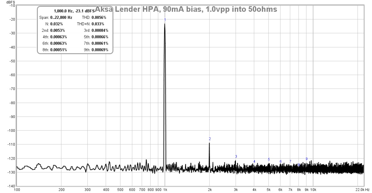

Here are some quick measurements using my older (noisier laptop), and a smaller CRCRC (2200uF caps) but shows excellent performance as a headphone amp driving 1.0vpp into a 50ohm load. THD is about 0.0056% mostly H2. This is with the through hole prototype board using 2SA1837 under 90mA bias and 24v Vcc.

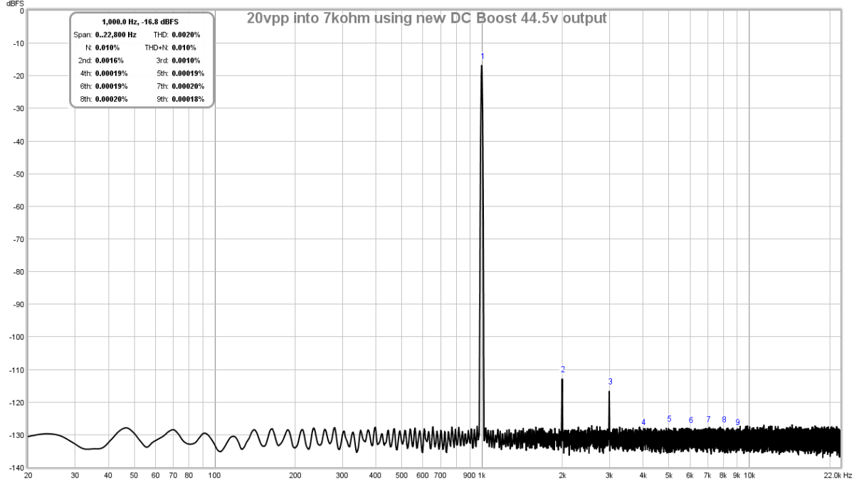

It is my experience that a shunt regulated linear psu using a mains transformer can not be as low noise/ripple as using a smps and DC step up regulator followed by cap multiplier. You will still have residual peaks at 60Hz,120Hz,180Hz with a shunt regulator. It is very difficult to filter out 60Hz noise. What a DC step up does is to convert the AC “mains” frequency from 60Hz (50Hz) to about 400kHz-1MHz, where it is much easier to filter completely with much smaller capacitors and steeper filter slopes.
Look at the FFT on this preamp, there’s no mains bumps or harmonics to be seen.
I just received the white metal PCB DC boost unit in the mail today. It looks very well made and measures clean - same as previous boost unit but much more compact and capable of putting out 50v. With the cap multiplier in place, the max Vcc is about 47v. If you have no need to drive very high output levels, setting the preamp Vcc at 40v seems to have less THD than at max 47v.
Here is 40v Vcc into the preamp driving 20vpp into 7kohm as before:

They are rated at 10amps and have high quality 14 ga wire presoldered to them. The aluminum board is convenient to bolt directly to a case for heatsinking if operating at high currents. It would seem that two of these in series with two 19v SMPS would make a fine (zero hum), extremely compact, dual rail supply for many Class A or AB amps out there for a low cost. The switching frequency is reported to be 170kHz, well above audio band. With the cap Mx and CRCRC, you can see that the supplies are absolutely silent.
