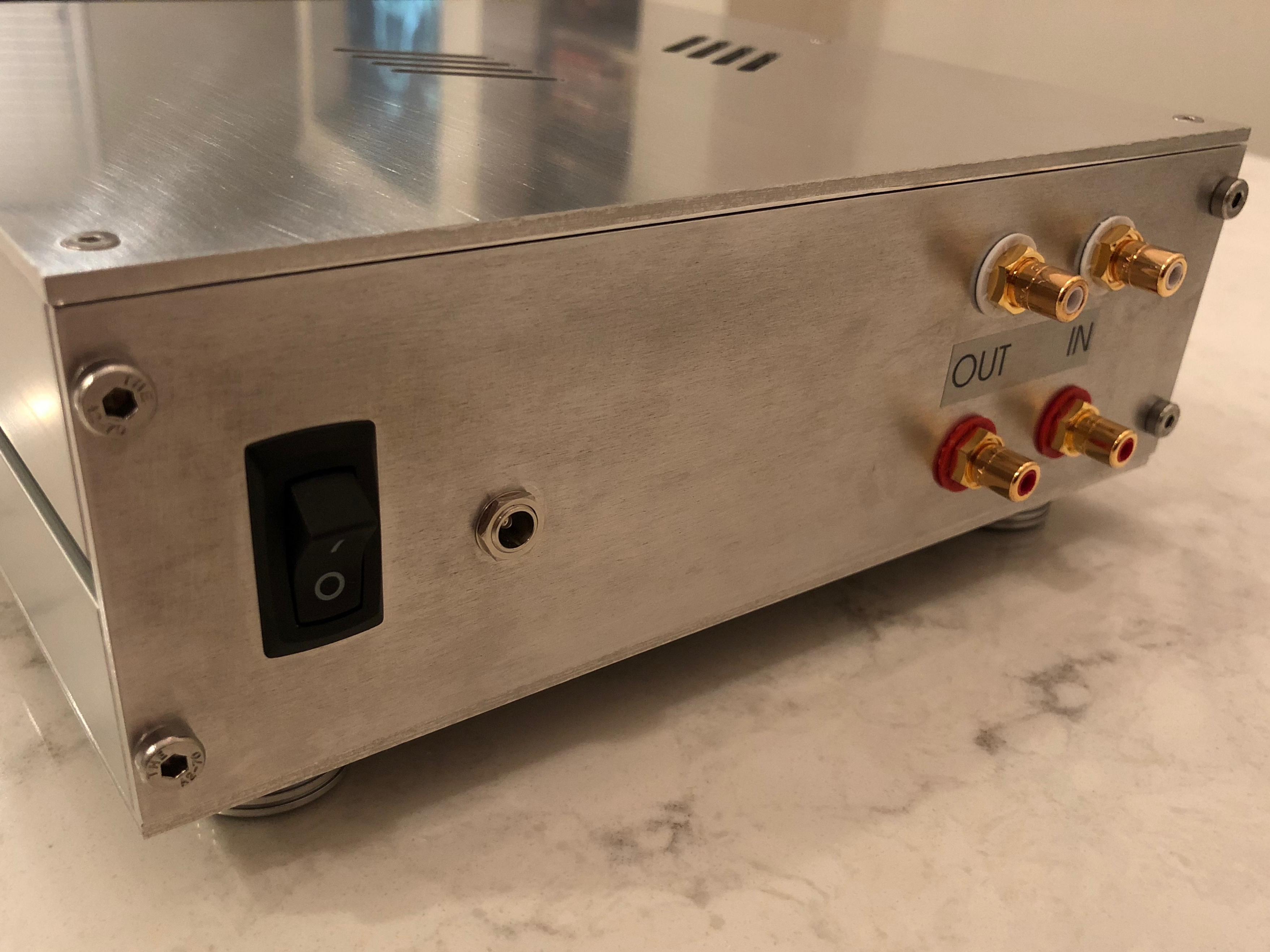

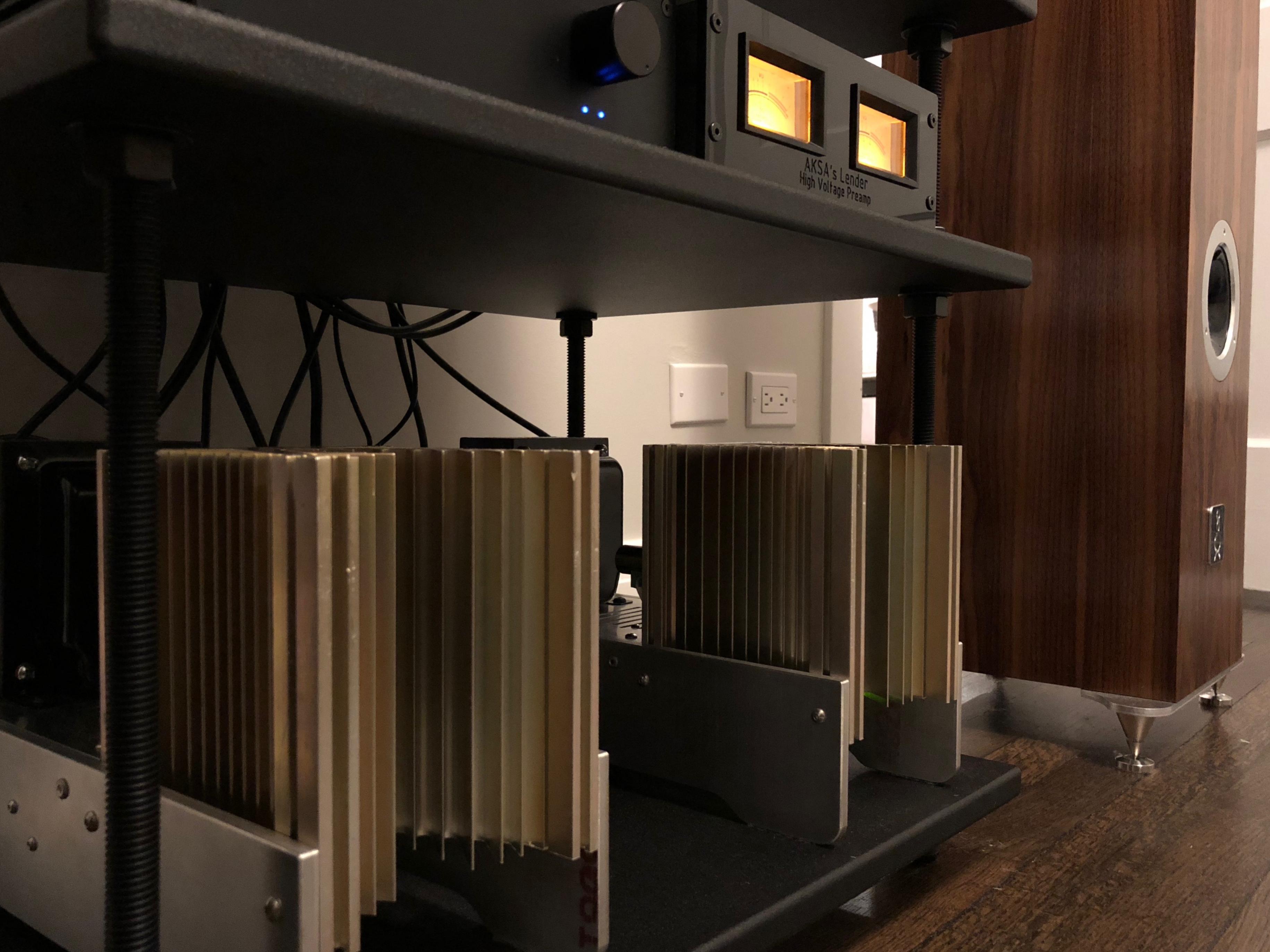

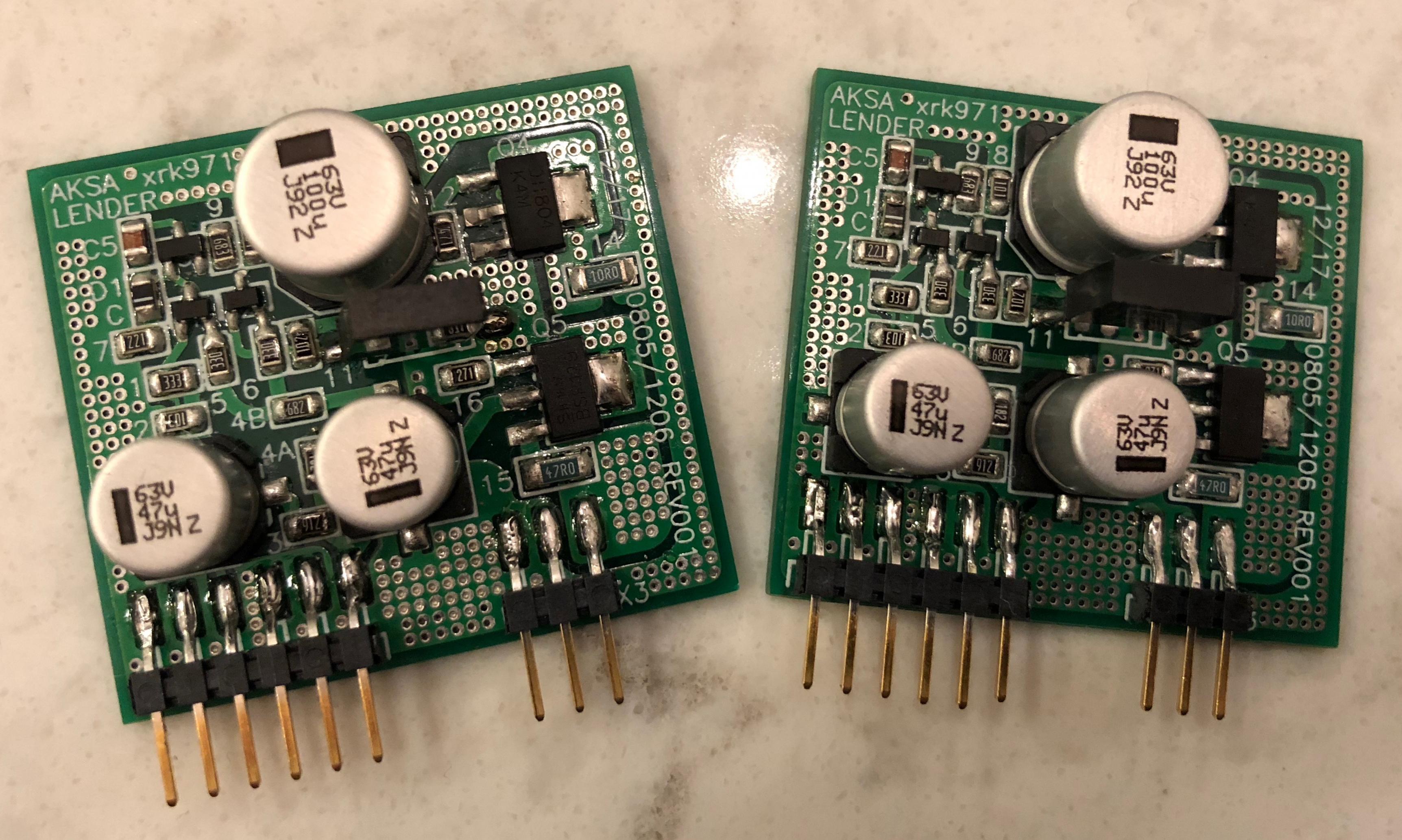

My AKSA Lender build

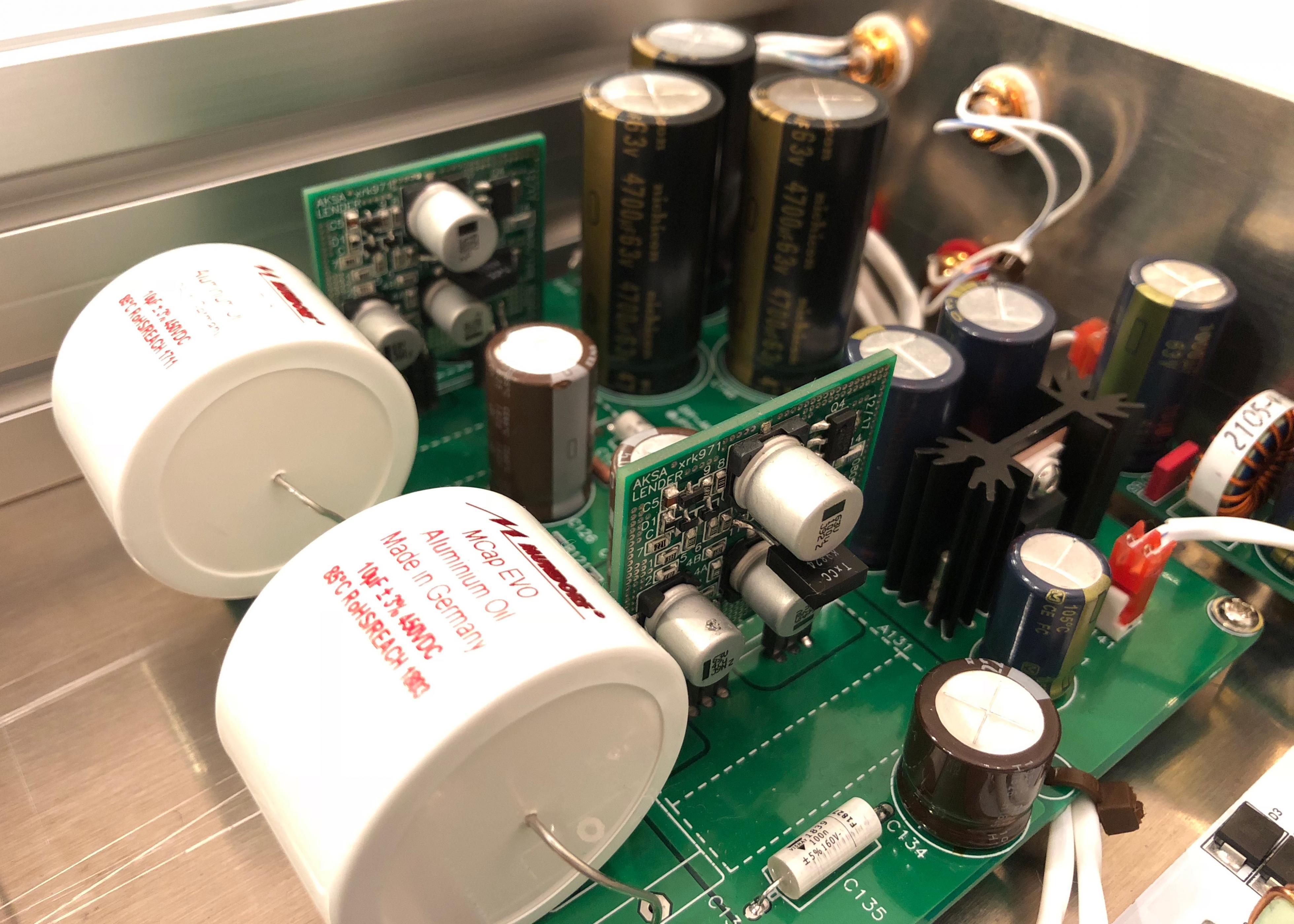

Last week I put the finishing touches on my AKSA Lender build using the 0805/1206 SMT daughterboards. I decided to finally take a break from listening to it and share my build - ok, I am actually listening to it right now!
Like many, I am using it to drive my 24v Big Mofo monoblocks. It has plenty of volts to push the Mofo, is dead silent, and I couldn't be happier with the results. The combo has displaced my M2 build and sits proudly in my main listening setup.

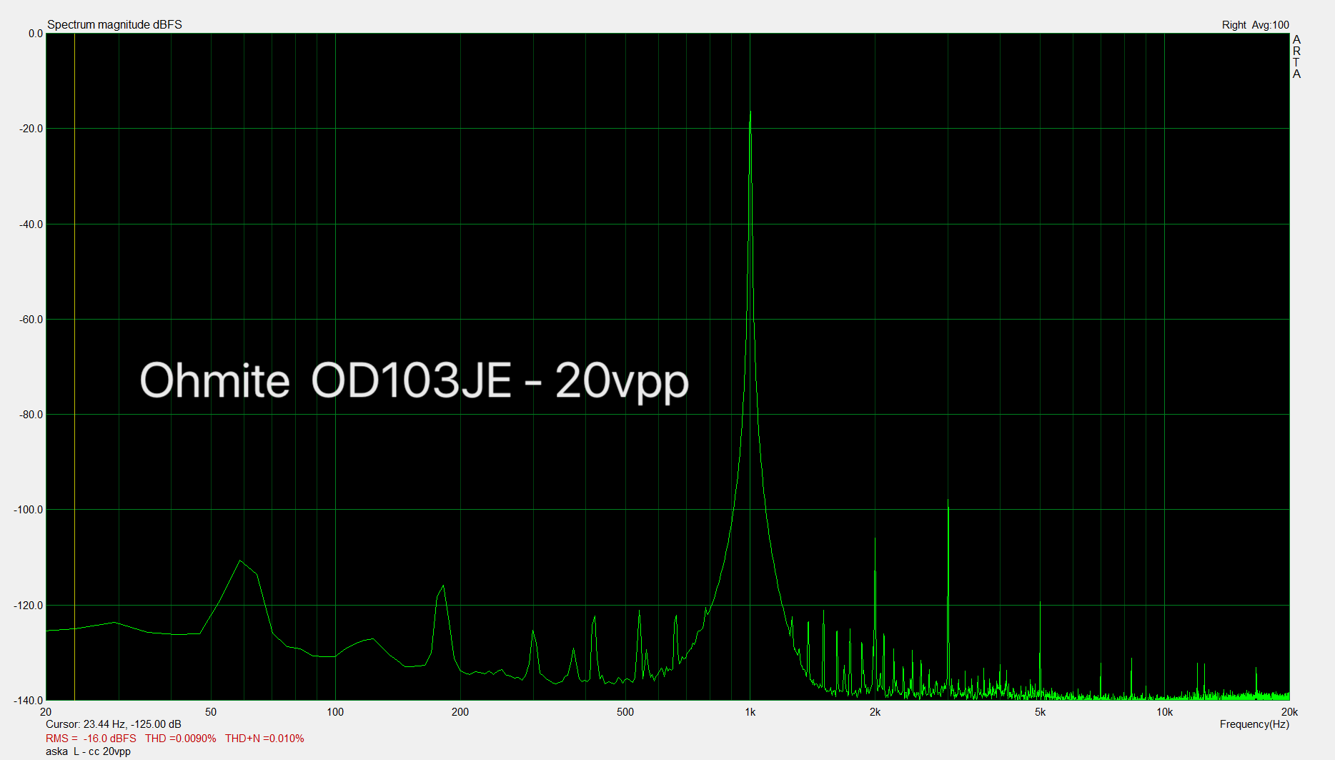

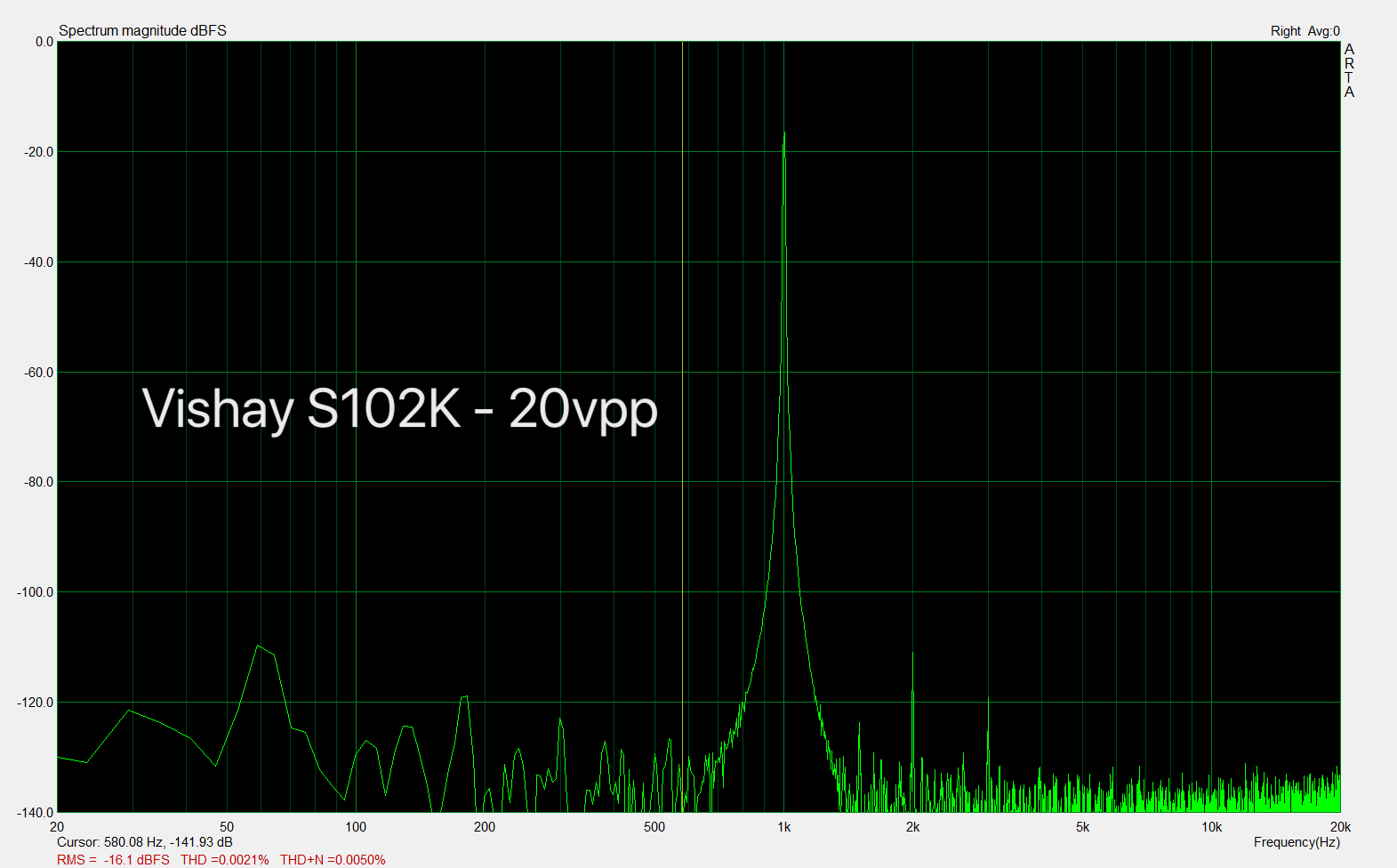

I ran into some interesting results and subsequent tweaking of the daughterboards, specifically R10. My initial selection of carbon composition resistors for R10 was whatever 2 Ohmite OD103JEs that Mouser had sent me. After using these at 5% matching, the gain between the channels was pretty far off. Since these were the only component in the daughterboard with a worse than 1% precision and directly affected the gain, I decided to order 20 of them and find the 2 closest in resistance. After finding a closely matched pair, the gain between the channels was matched fairly close, however THD was higher than I expected at 0.009% at 20vpp.
I then took the plunge and ordered a pair of 10k Vishay S102K metal foil resistors. After taking measurements before and after soldering the metal foil in one channel, I was glad I spent the money. THD dropped from 0.009% at 20vpp down to 0.002%. Overall, it was fun to spend money on a ridiculous component and directly see the results 🙂. If any one else is interested, I purchased my pair on eBay for $20.
For other components on the daughterboard, I have attached my BOM as a CSV. All 0805 resistors are Susumu RG, the 1206 resistors are Vishay TNPW e3. Some of the transistors were hard to find, but with an extra order to Arrow and using a BC860C with a smaller SOT-323-3 footprint, I was able to get everything sourced.

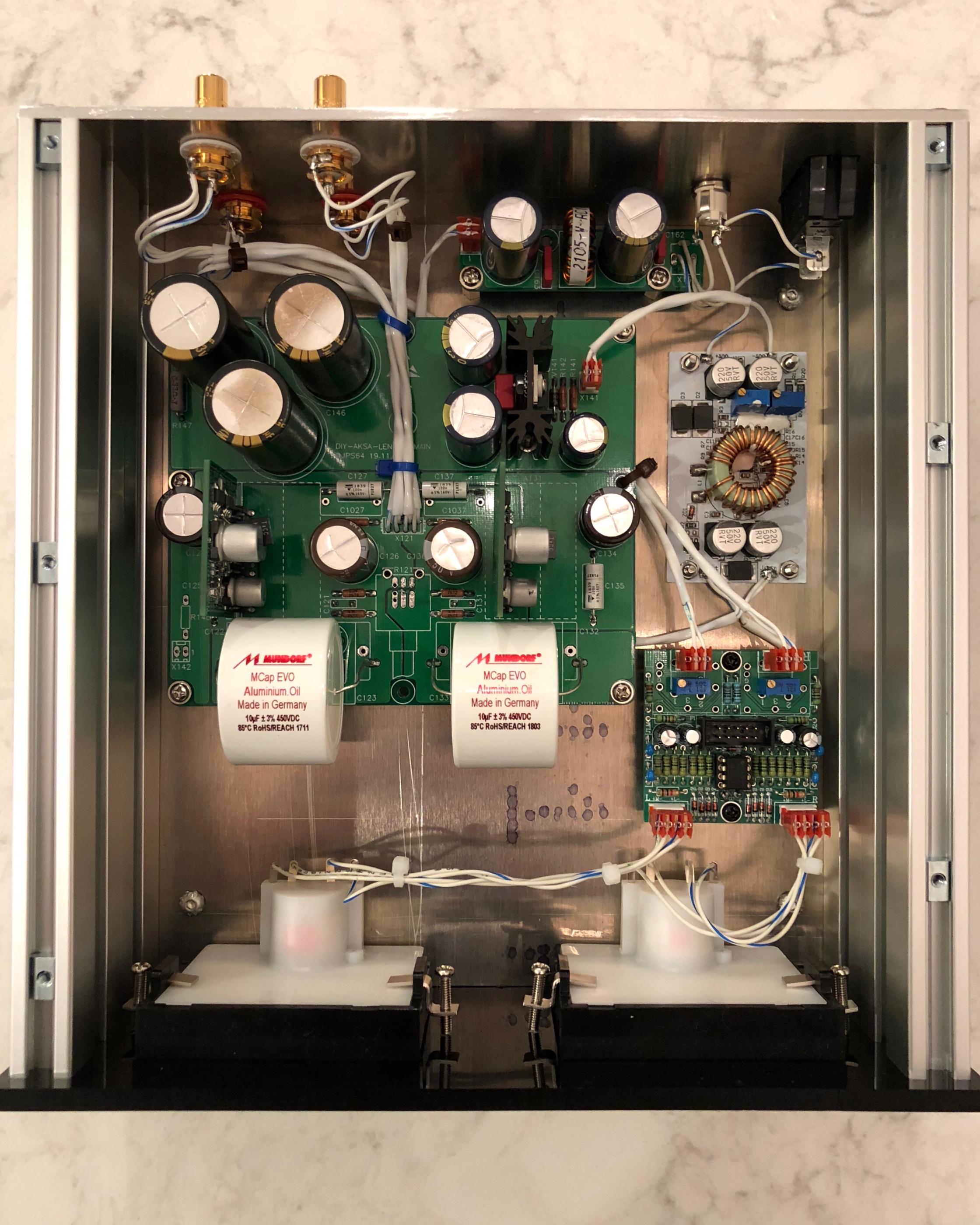

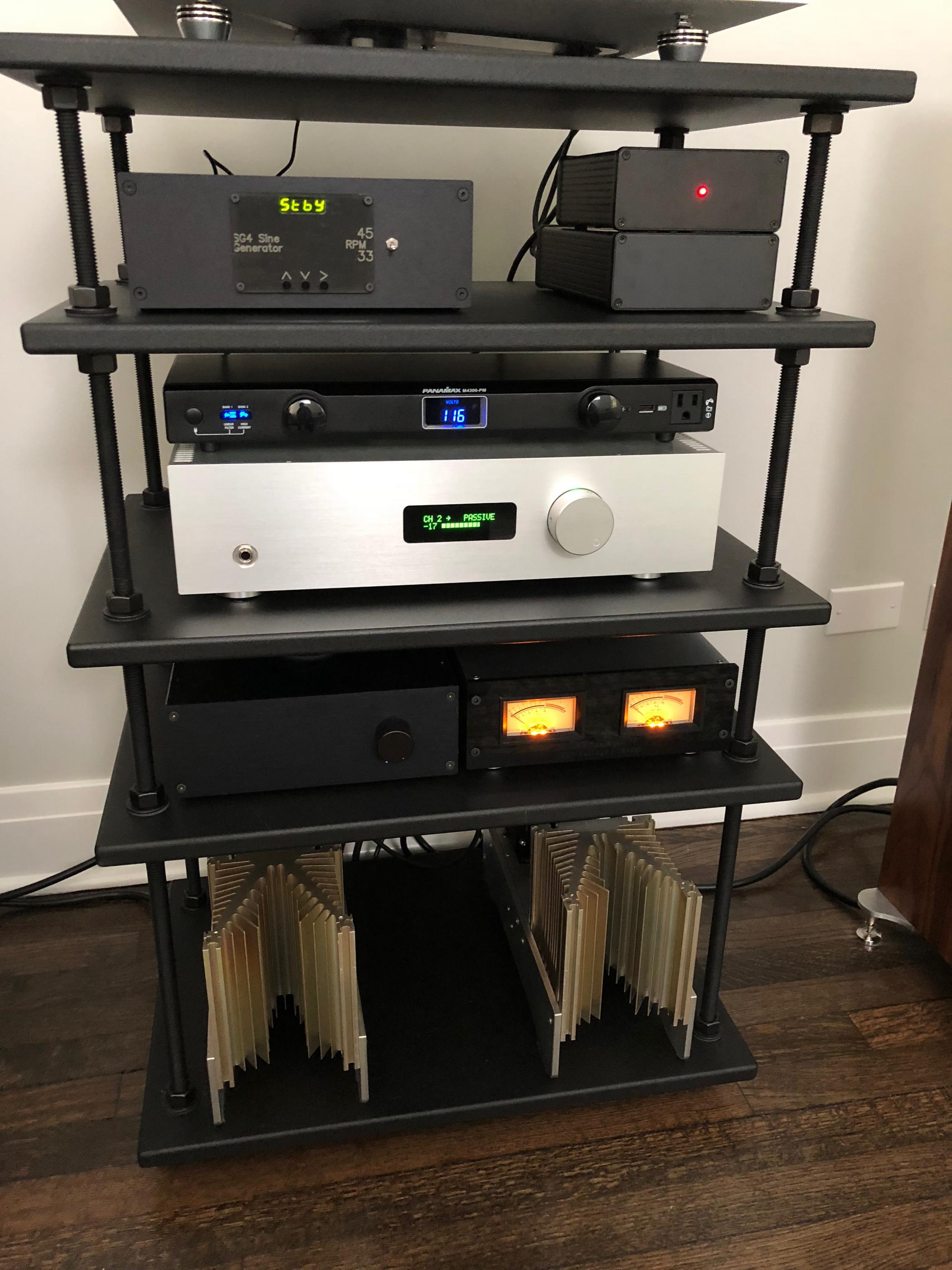

For power I am using a 19v laptop SMPS from eBay, the provided CLC filter, and the suggested DC step up to get about 49v. The cap MX takes this down to 45v and I am clipping at 1.45vrms in, 14.1vrms out.

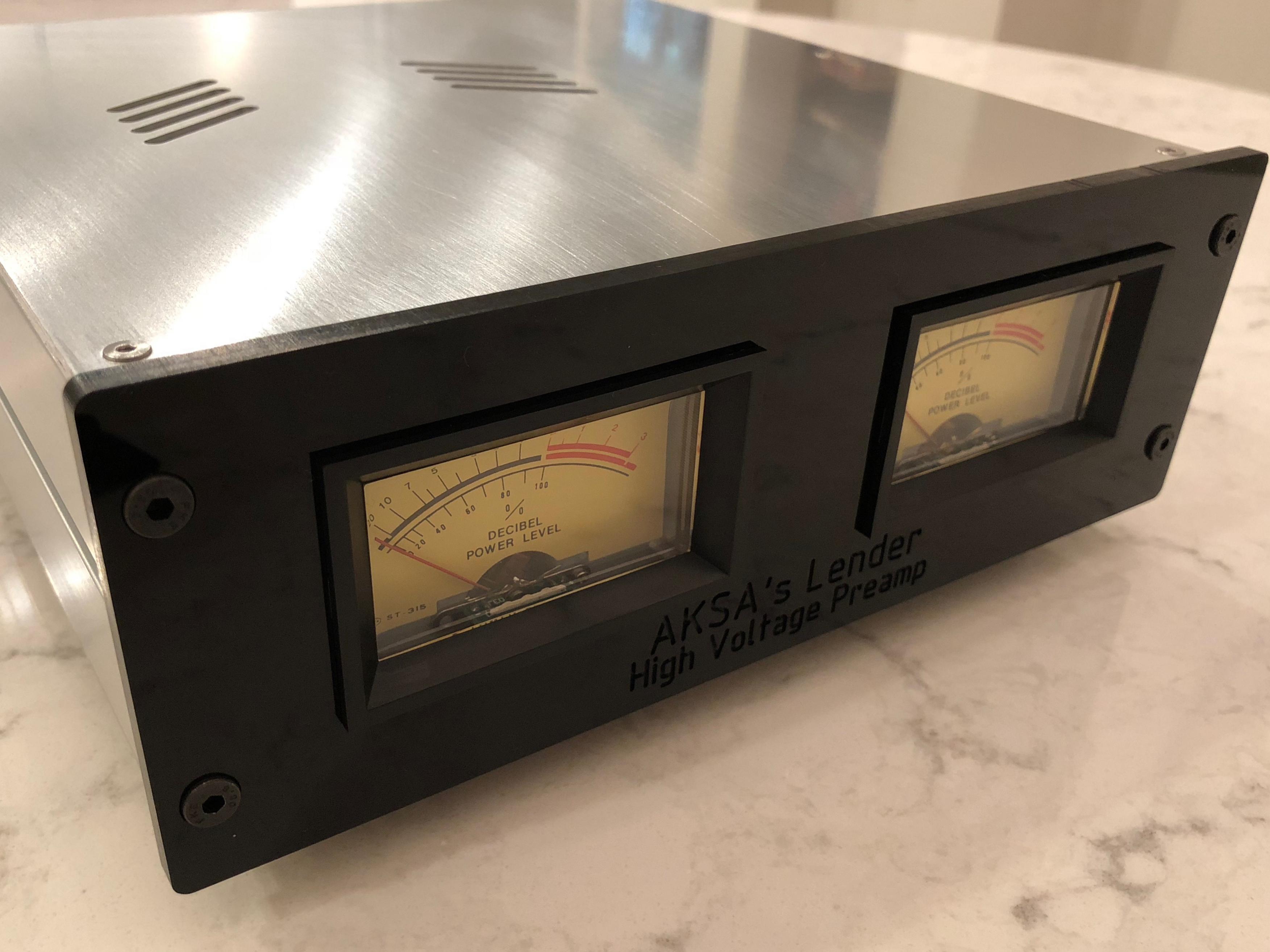

On to case construction. The front panel is milled out of 1/4" cell cast acrylic with VU meters driven by a stereo driver board from JLM Audio. The sides of the case are 15mm wide by 70mm tall extrusions from Misumi. These extrusions are great - I used them for my M2 build as well. They have holes in the front and rear that can be tapped for M5 screws and t-slots for the top and bottom for easy fastening of the panels. Top, bottom, and rear panels are 1/8" 6061 aluminum I milled. One of these days I'll find a place to take my aluminum in for anodization, but until then I've stuck with the raw brushed look.
Please let me know if you have any questions about the build or want me to go into further details!

If I may ask, what are you using for THD measurements?

How are you controlling volume as I do not see a pot? I guess your DAC is the volume knob?

My current setup is a Linear Audio autoranger, ESI Juli@ soundcard for both input and generator, and ARTA. I have the parts for Frex's EOSC10kv3 oscillator to use as a low distortion generator, I just need to find some more time for assembly.
You are right, I jumpered the volume pot pins. An extended view of my setup is attached. Input attenuation and source selection is handled by a preamp that my brother (@loafimus) and I each built earlier this year. It is based off of Jos van Eijndhoven's RelaixedPassive relay stepped attenuator and source selector and Salas' DCG3. We built it with flexibility in mind to support an external buffer such as the AKSA, adding selectable outputs. One output goes through the DCG3 buffer and the other is a passive output after the resistor ladder attenuation. More details about the preamp are on Reddit at The Super-Duper Preamp. : diysound.

May I ask which part# are these red sockets you are using on VU Meter driver board?
Great build, enjoy it!
I am curious as to why you didn't use a 33K value for R10 as Hugh suggested in post 403?
I wanted the originally specified 20dB of gain for the Mofo, so simply went with the values from the original BOM since. I figured the other calculations were for a base to modify to other gains and decided to go with what had already been tested and measured by X and others.
Glad you asked! They are TE's MTA-100 series: MTA-100 Series - TE Connectivity AMP Connectors - Free Hanging, Panel Mount | Online Catalog | DigiKey Electronics. The red ones are for 22AWG wires, they have other wire sizes available as well as 0.156" pin spacing.
They are my new favorite connectors and have been using them - in addition to fastons/quick-disconnects - for all of my wire-to-board needs. Conveniently, they have 0.1" pin spacing so are largely compatible with typical 0.1" pin headers of lesser quality. They are also locking and polarized! One would think I am a TE salesperson, but I just really enjoy them over other 0.1" crimp headers which I can never seem to terminate correctly no matter how hard I try or spend on crimpers.
The downside is since they are IDC, they do require a special tool to correctly terminate. They offer an not-so-horribly priced insertion tool that will get you there: 59803-1 TE Connectivity AMP Connectors | Tools | DigiKey.
Given my enthusiasm for them, I actually splurged for a spring-based crimp head and corresponding hand tool. Luckily the combo can be found used on eBay for around $80-100.
