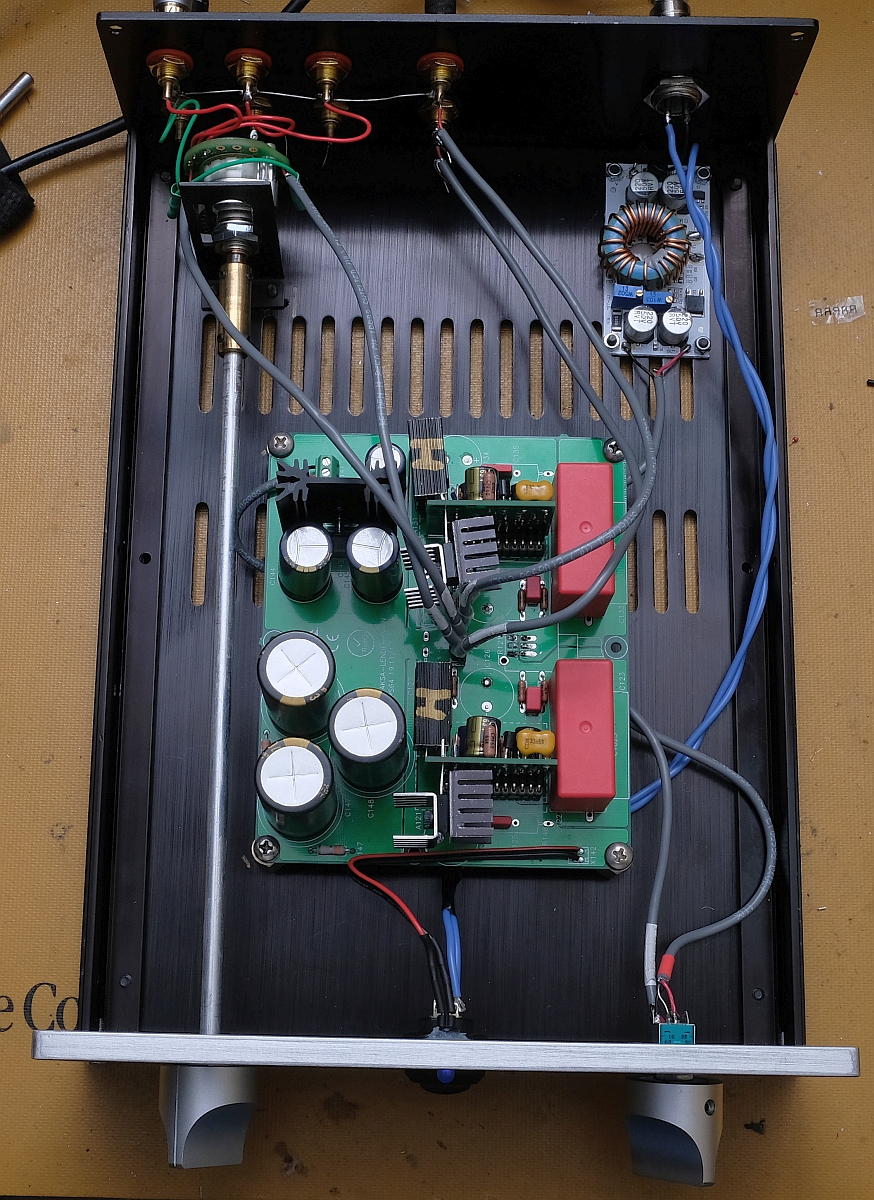

Pcgab, what amp will you be driving with the Aksa Lender preamp? The ALPHA 20 has enough gain on board (and an Aksa Lender front end built in) already.
F5/F5T primarily. Maybe vhex when I get around to building it as well.
I'll most likely build two sets of daughterboards, one with less gain, one with 'standard' gain.
I've been listening to the Alpha 20w with my B1 clone in front of it and that combo has been working very well. Source selection, volume control and fantastic fidelity.
Hi Pcgab,
I use a high gain DB set with 12K in R10 for my MoFo and a low gain DB set with 4.7K in R10 for a tube amp that has 20dB of gain and my ALPHA 20. Works out very well 🙂

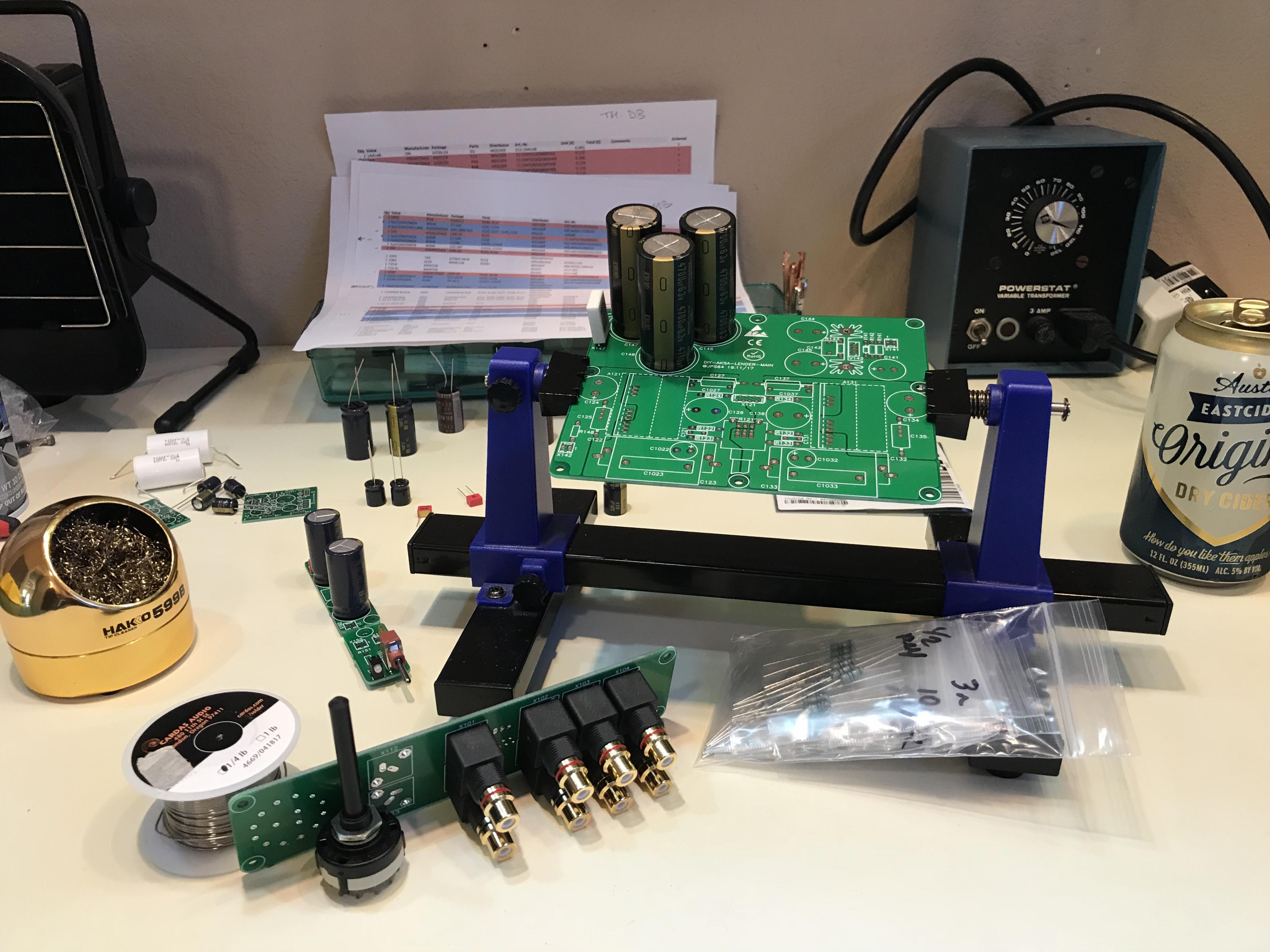

Finally got my parts orders together, still need a few details. Spent a few minutes this afternoon confirming parts, fitment, etc. Hopefully I'll sling some more solder on Sunday.
I got mostly Takman REY for the resistors, and some upgraded caps. I also ordered the RCA's from HifiCollective, I'm really impressed with the quality of these, they are ~$9 USD/each, but they are very well made, and seem quite robust.
Nice parts! Those RCA jacks indeed look very posh and well built. I see JP was designing a high end Preamp.
