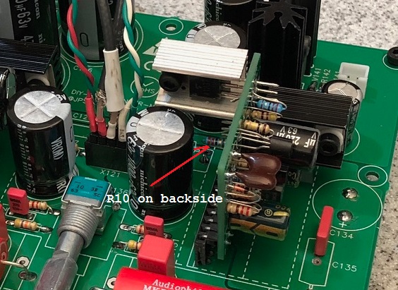

While waiting for components to arrive for my ALPHA20 project, I assembled a set of daughter boards to lower the gain in my AKSA Lender preamp. The original set used 12K ohm resistors in R10 and worked great with my MoFo amplifier, but was too ‘hot’ for my 6L6 tube amp. I used 4.7K ohm for these daughter boards. The resistor change enables a much finer volume control.
I was able to position Q4 and Q5 so I could attach small heatsinks, they get pretty warm/hot.
Nice work, Vunce. I did the same trick to get the heatsinks on opposite sides too. Those are nice coupling caps you have. Only the best here. 🙂
Thanks X.
Believe it or not, positioning Q4 and Q5 took more time then soldering the rest of the board 😱
I know how that feels. I spent 4hrs one time debugging 1 daughterboard. Could not find problem and finally abandoned it to make a new one in 30minutes. Worked fine on new one. Kick myself for blowing half a day.

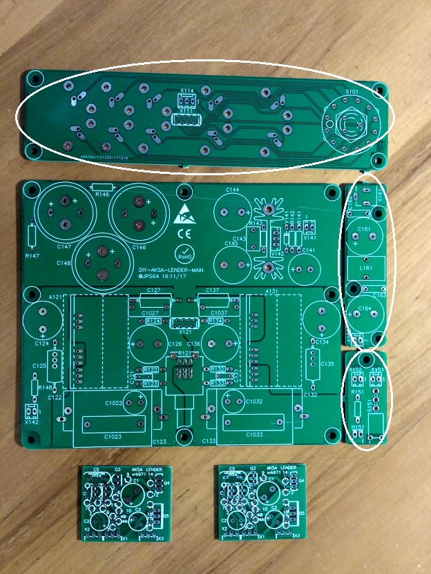

They are in the main (MB) schematic. Basically a power entry CLC filter, a Power On/Off switch holder, and a input/output panel with multi-input selector switch.
These are all optional should you need them. Some people like to have multiple inputs to a Preamp.
Ok, thanks. I believe you. Had one look at the schematic then immediately closed it again. 😱
Do I need it? When to use the CLC filter for example?
Don’t panic. Just look at the core amp circuits. The rest is just getting power to it and signal to and from.
The amp core has 5 actives - hardly anything more simple than that. 15 resistors, 4 caps, 1 diode.
