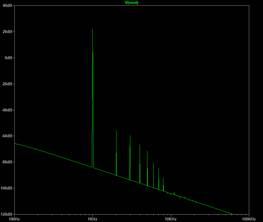

I've simulated the recommended lower current 1.46A Alpha20 8R (0.44r 0.12r) with the two options for the fb CCS resistor:
with equal current swing:
520r fb CCS: clipping at 0.72Vin +-18Vout
In the FFT a nice declining profile: H3 8db lower than H2
with H3 at -79db
output half the current swing of the CCS:
390r fb CCS: clipping at 0.7Vin +-17.4Vout
In the FFT less declining profile: H3 4db lower than H2
but lower distortion: H3 at -82db
So the one with equal currents has a nicer FFT declining profile and a little more power,
the one with half currents has lower distortion but less nice declining FFT.
So it's up to personal preference, me I go for the nice declining FFT profile 🙂

Thanks Danny_66 for the simulation comparison.
So, if I try this for my ALPHA20 the control resistor (R131) should be .44R, current sense resistor (R132) should be .12R and R128 should be 520R.

Danny:
You have plumbed this circuit well and your curves from LTSpice are pretty much what I get. Well done, this is not particularly intuitive.....
I like to ensure that the current swings are identical, so that when they both bottom out at zero mA we have maxed out the voltage output, and therefore the power. As you have found, this amp does clip on the negative half cycle first, a less than ideal situation and quite different to a PP Class A or AB. Like you, I prefer this approach not just because the output is maximised but also because the harmonic profile, which Nelson does talk about briefly but does not go into detail, it is monotonic decreasing with the equalised current swings. When you can achieve a linear decrease of the harmonic profile from H2 down to H5 you deliver a good amplifier, but to be sure you have to have a log scale on both X axis AND the Y axis. Another level of excellence for a good audio amplifier is the ratio of THD for H2+H3+H4 to THD for H2 + ........... + H15. You can select the number of harmonics in the four command line on LTSpice, like this:
.four {freq}15 8 V(Vout)
.four {freq} 4 8 V(Vout)
The top line gives you 15 harmonics, the second, four. If you can achieve second THD divided by top THD higher than 99.5%, then you have a very good amplifier. The figure of excellence on this amplifier is 0.027421%/0.027503%, which is 99.7%. This figure is at +20dBU output, which is 14.14Vpeak output into 8R at 1KHz.
