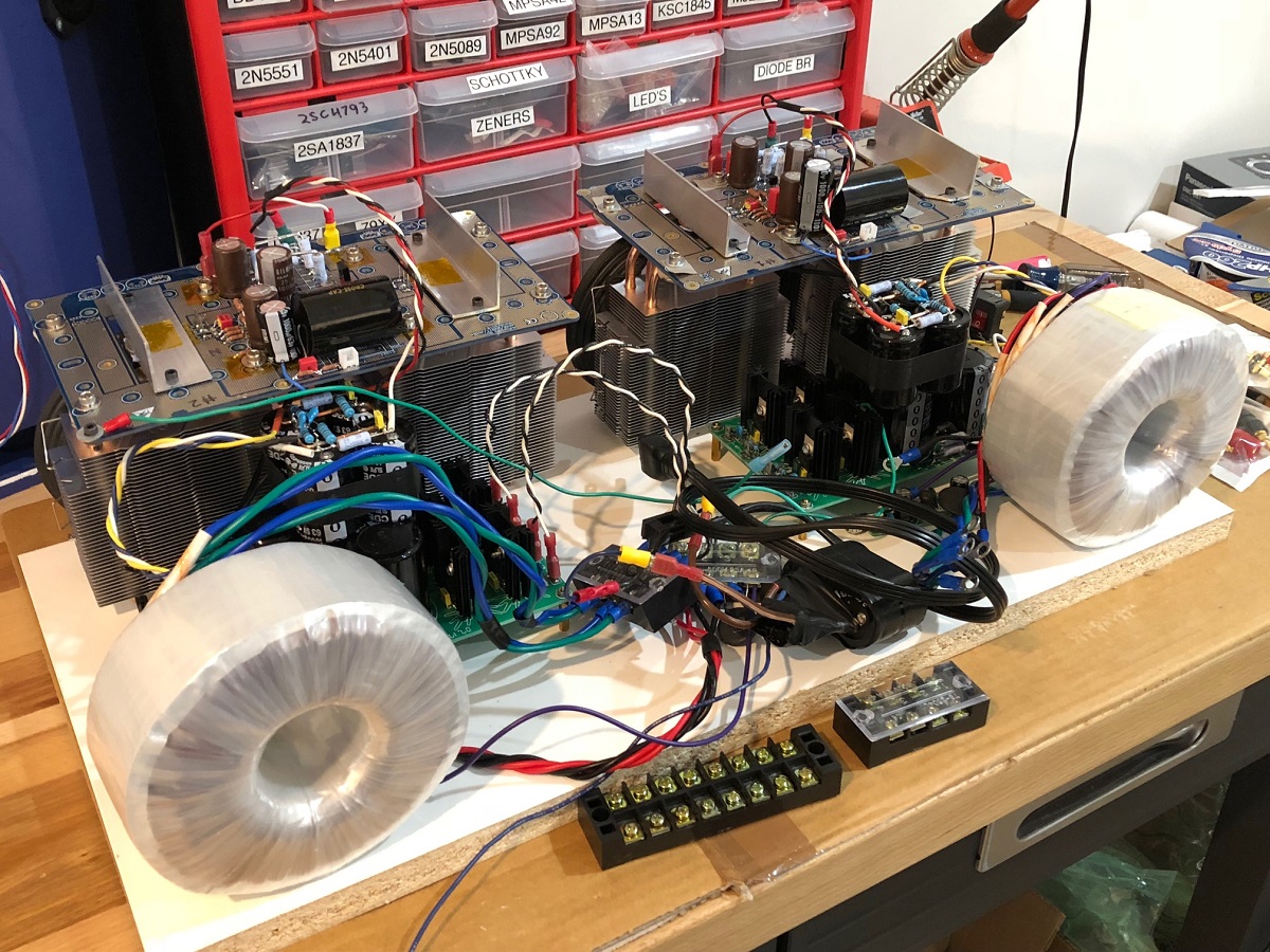

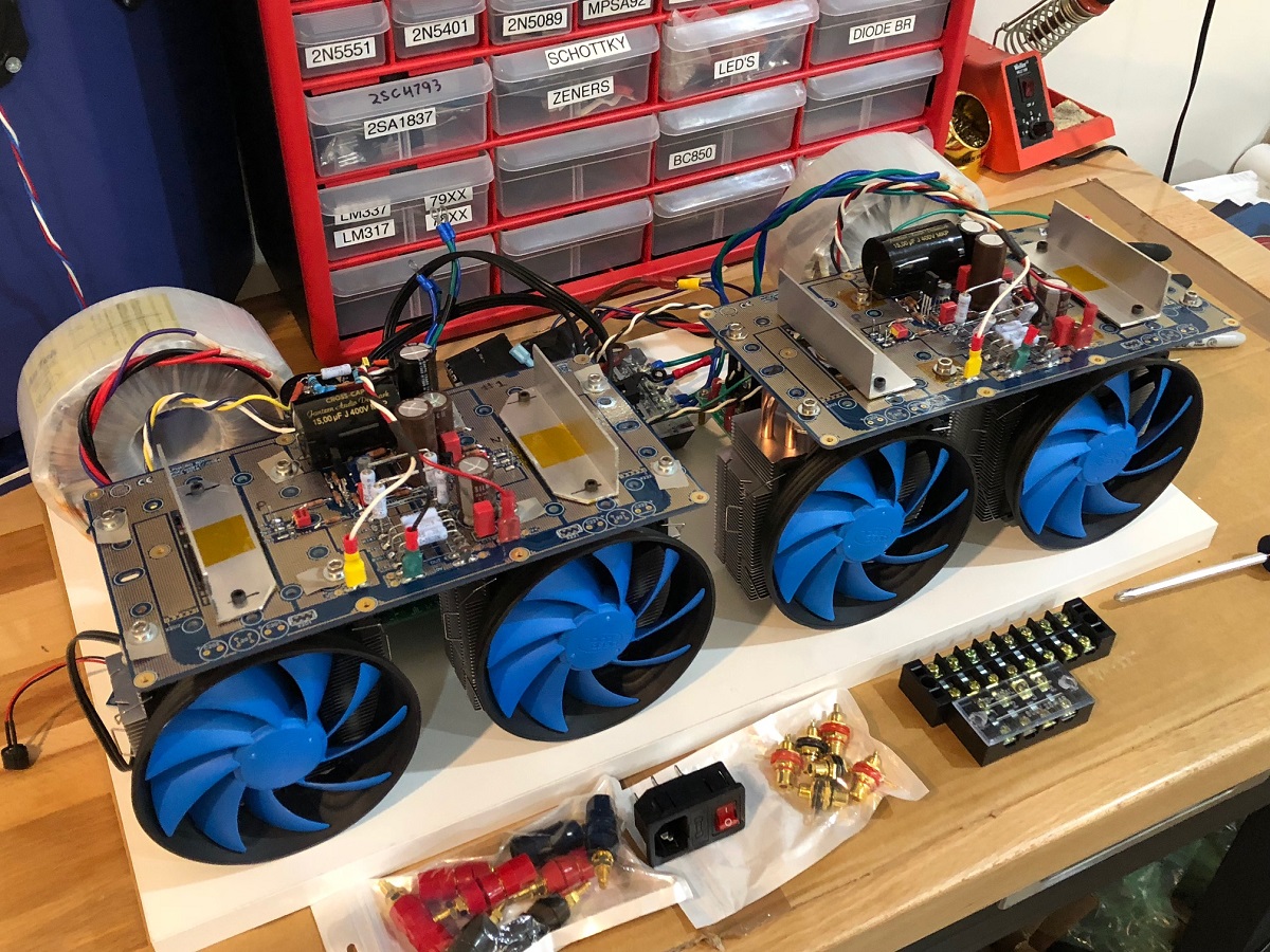

Dual Monoblock Setup for BB
Starting to think about how to arrange it all on single melamine shelving plank for a dual monoblock stereo test. Wating for more ring crimp connectors and 16ga stranded 300vdc hookup wire to arrive before being able to connect everything. I am even adding a DC blocker to the mains input.
Front:
Back:

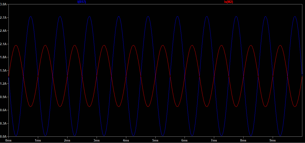

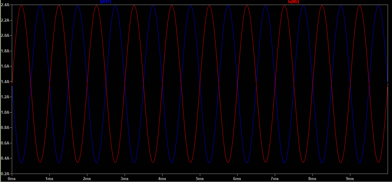

Hi X, Hugh,
I think that the schematic for 1.35amp bias current in post 1500 has a value of the CCS fb resistor R128 that is not optimal.
The current swing of the CCS and the output transistor are out of balance.
Instead of 680R it should be 900R for equal currents, see ltpsice screenshots.

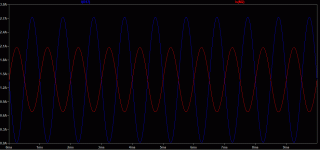

Danny
The goal is to actually have the current in the Aleph sense resistor 2x the current in the CCS resistor - that produces the most efficient output power and deepest clip. The way to check is to set R132 to about 1/2 of R131 then apply AC modulation and measure the rms voltage across R131 and R132 AF they should be about equal in voltage, which means R132 is flowing 2x the current. Proper setting of R128, partially sets this optimal balance point.
Danny and X,
You are both correct.
But it is not straightforward.
There is some benefit in adding the active CCS resistor (I think it is R132?) as low as possible because all the load current is wasted in it. In the event of 3A, for example, with 0.18R we have a loss of 0.54V. The signal dropped across this resistor is then impressed through R128 to the base of the CCS controlling transistor, so it has to be adjusted to ensure that the dynamic range of both output devices is equal, as you have in your second graph, Danny. But if R132 is reduced to the specified 0.12, at 3A we only drop 0.36V across it, and correspondingly we need to reduce R128 to ensure equal current range in the two output devices.
When you read Nelson's comment on this, he describes a subtle change in the THD for unequal dynamic currents in the outputs. He suggests you can change R128 to select the optimal value; I have chosen to keep them equal, ensuring that outputs start to switch off identically at a higher value; he seems to believe that it is better if one output has around half the dynamic range than the other but believes it is personal choice. It is easy to do this on LTSpice; simply samples the currents in the sources. But in reality it's tricky because the pmos has not source resistor on it, so it might be convenient to put in a 0.1R source resistor on the pmos and then compare the current swings simultaneously.
I think your figures are current, Danny. As you change R132 and the quiescent this bi-swing changes quite a bit.
Actually, on the 20W Alpha, I suggest slightly more current, I like 1.46A, which using a nominal Vbe of 660mV on the controlling CCS transistor, corresponds to 0.44R. This accommodates speakers which dip down to 6R at peaks, which is more suitable for most speakers with complex crossover and mechanical configurations. I break this down to two 0.22R resistors, each rated at 2W, in series. Equal current swings come in at R128 520R. Both outputs start to bottom off at 19.1W output into 8R and 6R, which is about as good as it gets. This is -17.5V trough point.

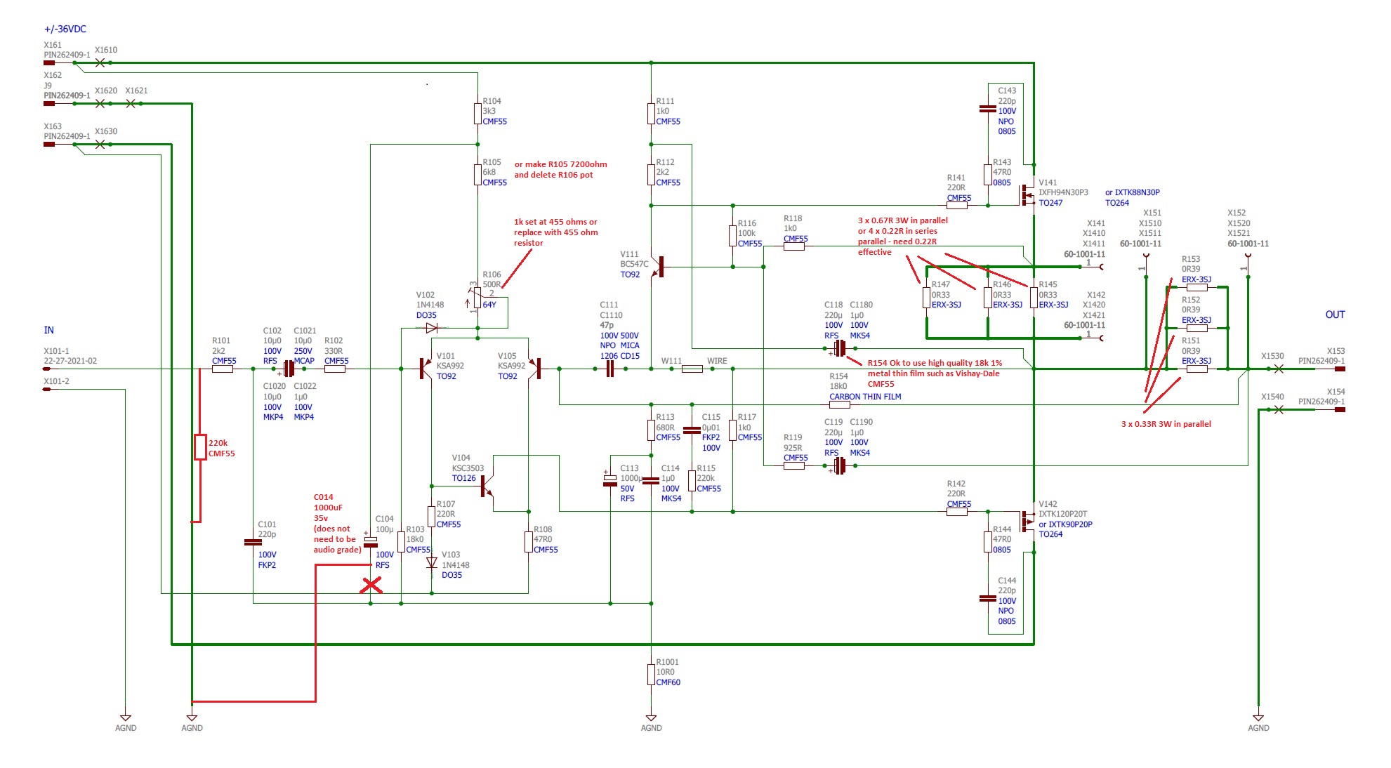

Here is the revised schematic for the Alpha BB. Waiting for concurrence of changes by Aksa.
Hey X,
What is the function of 220k resistor at the input? I missed that alteration.
It’s to reduce noise pickup when the inputs are not connected to a source. Did not seem to be an issue on Alpha 20 but B.B. PCB is larger and picks up more stuff.
Gotcha, makes sense now.
The ALPHA20 1.46A mod requires R131 value of 0.44R and R128 value of 520R, but R132 stays at 0.22R...Correct?

I believe so, Hugh can confirm. I know Hugh likes R132 as low as possible - but according to the Pass article should be about half of R131.

I can't disagree with Pass, but to add to his comment I try to make R132 as low as possible. There are different designations on the ALPHA so I call it the load current sense resistor so there is no doubt about what it is. JPS changed my original designations, so there are times when I'm not sure what's meant here, particularly as they figures are very small and the picture needs to be magnified. Not a criticism but describing what the component does is useful because the entire commentary can then stand alone.
Vunce, the 220k references the input side of the coupling cap to ground, scotches hum when nothing is playing, and permit interconnection without thumps during switched on.
