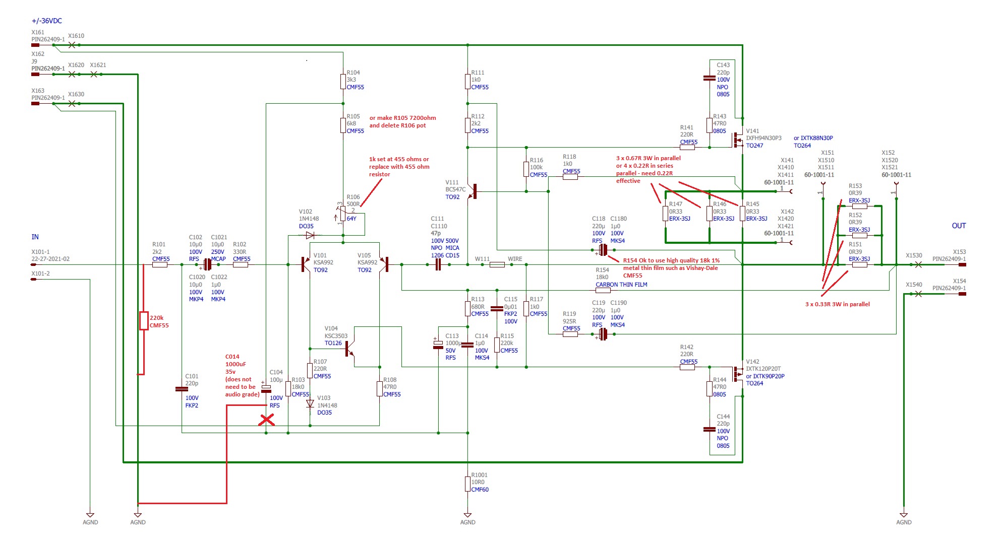

Of course - as B.B. is still in Beta test, but so far similar changes and cap on LTP is similar and source resistors are 0.22R in series parallel. Aleph feedback of 3x0.39R is correct. Could also use qnty 4x 0.47R 3W ERX in parallel. Negative lead of LTP cap needs to go to power ground but that will be fixed in production.

It’s a real simple amp to make if you look at the parts count. I can say honestly that you can skip the pots - not a single one is needed. Amazing to have an adjustment free Class A DC-coupled output amp.

Here is the revised schematic for the Alpha BB. Waiting for concurrence of changes by Aksa.
I think we can eliminate the one pot for the LTP. I have never needed to adjust it, so we should just remove it and use fixed resistor or combine with resistor above.
I have not tested the 3 x 0.33R in parallel for the Aleph CCS sense resistor yet, but believe this to be the ideal value.

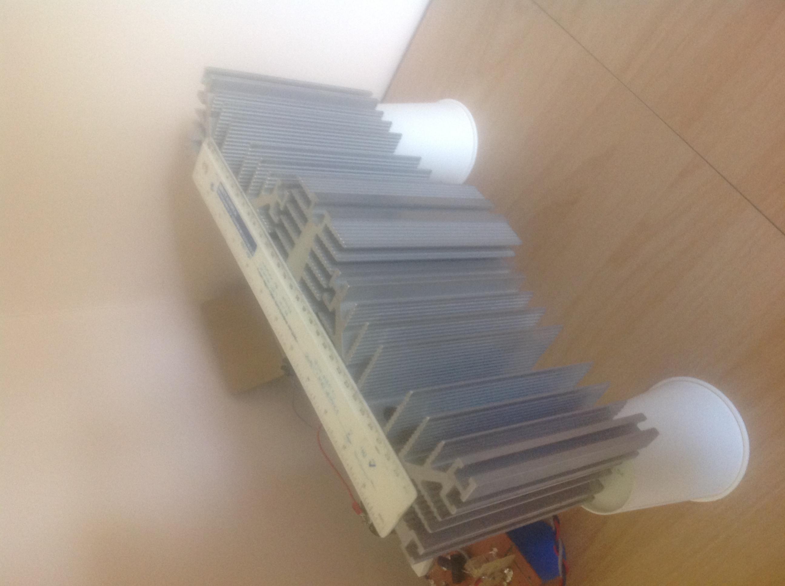

Very happy with how Alpha sounds. I have been trying to use passive cooling using heatsinks that I already have but I'm not happy with the results, too hot for my liking.picture is of the last attempt. I am still running 1.9A bias. Using CPU coolers and fans works well, just the fan noise worries me. I will keep on experimenting.
Thanks for all the info and support.
