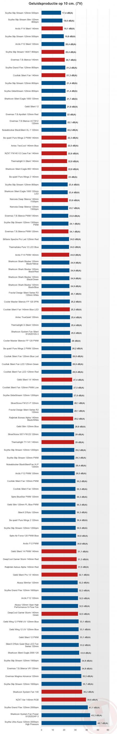

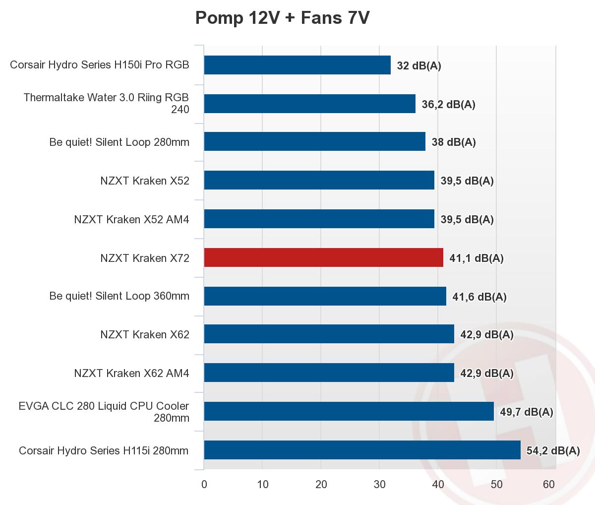

All of them. Hardware.info tests them only at 40dB and 50dB because all of them reach 30dB or over 30dB with just the pump running. Spec by chinese or marketing spec are useless, the best watercooler they tested lately was nzxt x72, nztx spec says max 34.5dB noise with all fans at max speed, in the test the usual 40dB and 50dB tests are done and no trouble reaching that level although according to nztx it is well above maximum LOLOL, 30dB being impossibly low.
Looking at their test summaries, there are several water coolers below 30 db pump running. For comparisons, the noise measured for the GAMMAXX 400 (the big brother of the one X is using) is measuring 30 db at low fan speed. These measurements are all done at 10 cm distances mind, so are probably not that indicative of a real world usage noise. That is basically putting your ear against the thing! X feels his is quiet at the speed he is using it, so i still hold that there should be no difference between air and water coolers from a usage perspective when it comes to noise.
Liquid nitrogen audio a class power amplifier noise goes down no fans needed.Looking at their test summaries, there are several water coolers below 30 db pump running. For comparisons, the noise measured for the GAMMAXX 400 (the big brother of the one X is using) is measuring 30 db at low fan speed. These measurements are all done at 10 cm distances mind, so are probably not that indicative of a real world usage noise. That is basically putting your ear against the thing! X feels his is quiet at the speed he is using it, so i still hold that there should be no difference between air and water coolers from a usage perspective when it comes to noise.

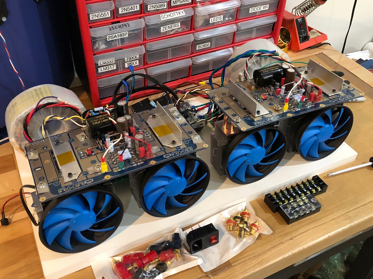

Regarding fan noise, I used a calibrated SPL meter and had to get it at least 15cm away before it would even register about 30dBA (absolute). Note that ambient sound in my room is barely below this and many times above if the laptop fan is running (annoying). That’s the slow 10% speed which was set to mininmum by adjusting the pot on the PWM all the way CCW. At 3amps bias and +/-30v rails, temp of mosfet body clamp bar never exceeded 38C. Heatsink fins were 27C. Barely warm. I have no issues with the fan noise. If you put this inside a cabinet with fan grille and exit holes probably even quieter.
The ultimate is to use heatpipe spreaders on a large passive radiator. Noiseless. But big and expensive. My coolers with fan were $50 for all four. PWM controllers are $3ea and ea can handle 3 fans. What will passive radiators for 400w cost?
Big PWM fans and heatpipes rule (sort of looks like a big airplane wanting to take off):
