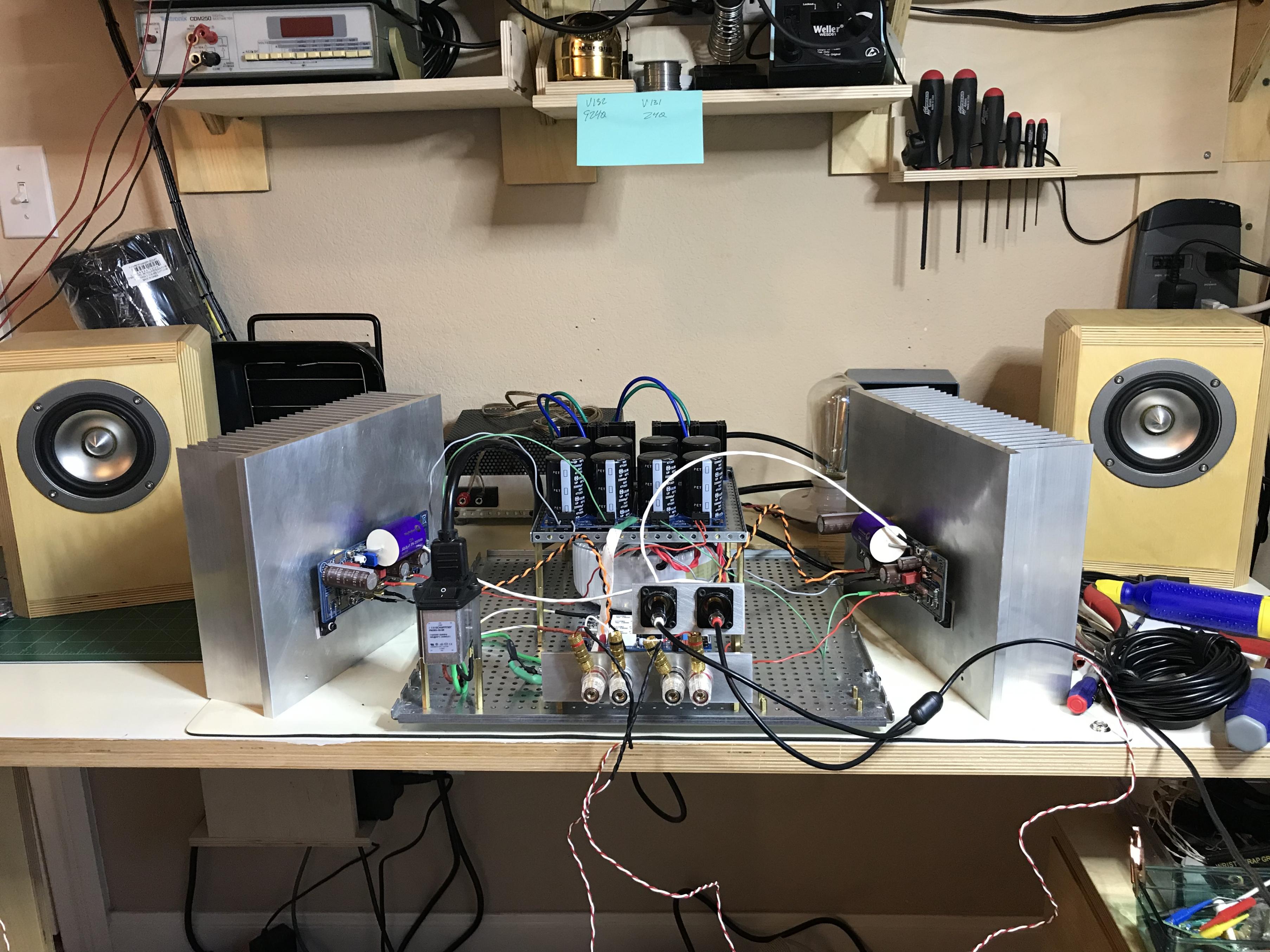

Measured one channel at a time, across R131 (0.33r MRA5). Each channel measured 0.177v.
Inputs are not connected, outputs are, didn't measure offset as yet.
~Gable
Baah, I'm a knucklehead...
Right Channel - 0.620v
Left Channel - 0.614v
I had left my mains bulb tester in series with the mains power, and the giant incandescent bulb was sucking up most of the power, as it should be.
Removed that, went through the variac, set at 120v, and now they look right.
~Gable

Haven't checked offset yet. I had just enough time on my lunch break to get those initial measurements.
May have enough time later this evening to check offset, and hopefully rock some tunes!

Off set is:
~3.9mv - right channel, input not shorted
~4.6mv - left channel, input not shorted
The move around a little, but this is stabilized after a few minutes.
First sound later tonight!
Listening to it now:
Tidal HiFi -> iPhone 7+ -> Alpha
Speakers are my bench test speakers, Tang-Band w4-1337 in non optimal bass reflex boxes.
There is a little bit of noise when no music is playing, but it's tiny. Likely the mess of wires that is the proto chassis at the moment.
Sounds class A, a definite signature I recognize. Very high frequency sounds a bit more present, but not shrill, very clear, bass is quite authoritative. Not boomy bass at all, just very well defined I guess.
A few songs in, and I am enjoying it quite a bit, I'll likely listen like this for the next few days in my office, throw lots of different music types at it.
Coltrane's 'Blue Train' album is sounding wonderful so far....
more later..

It's the second time I've used the soft start board, both times they've worked exactly as they should out of the gate (knock on wood I don't jinx the next one!).
It must be lower distortion, as the clarity is very evident. If I have time tomorrow I'll connect the alpha to my FE126 BLH's.
I have a 100k passive volume control I may throw that between a CDP and the alpha for the next few days. Or my B1 clone, that might work better.
I need to clean up the lab though, it's a mess of parts, and the 4 compression drivers I'm putting new diaphragms in...
The amp should be silent with audio input +/- shorted to each other or disconnected. Long leads passing by a trafo or mains cables can pick up hum.
I assume you did not have to adjust anything, just turn on and listen right?
Yes sir.
I'm pretty sure the tiny bit of hum is from one of the many too long wires draping all over the power supply. I'll tidy them up in the next few days. The hum is really quiet. I'll see if it's present with nothing connected.

I had them connected to my iphone, just paused the play and put my ear up next to the driver. That was the only way I could hear any hum.
