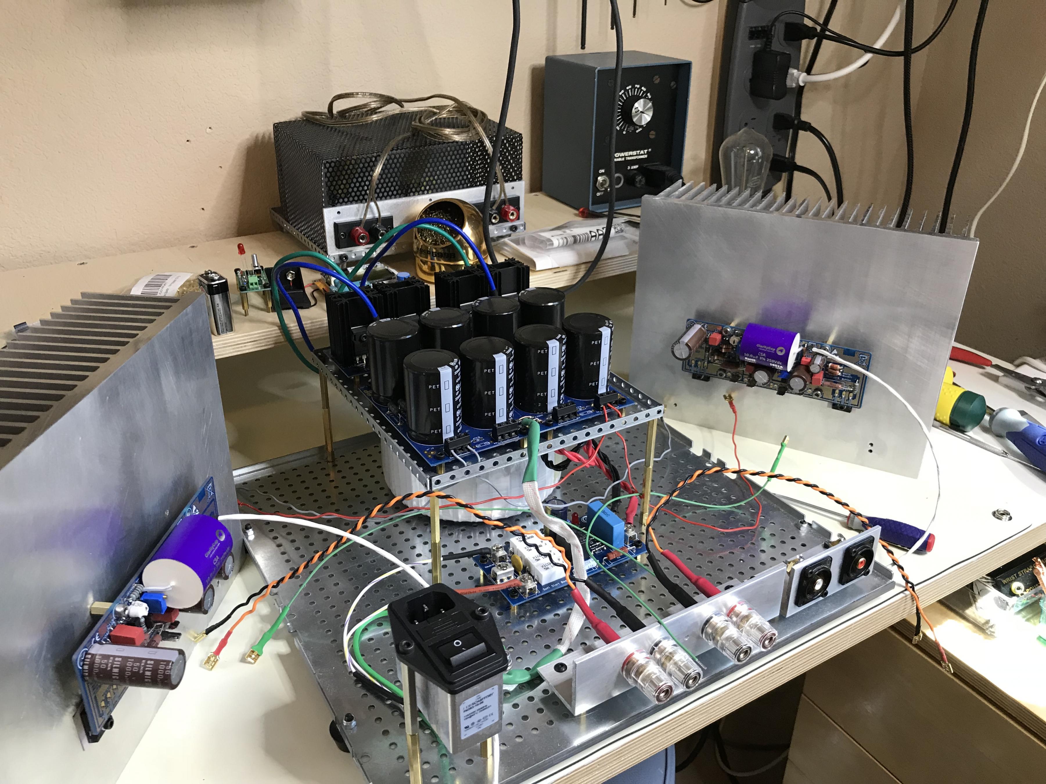

I was able to sneak in a little time over the last few days to get my heatsinks drilled and tapped, mount the boards, mosfets and start wiring the amp up to measure and first sounds.
Almost done, hopefully I can wrap it up in the next few days. If all goes well at that point, I'll start working on the final chassis.... 😀
X, et all:
Is there a post or two that discusses what voltages I should see and where, etc.?
Should I short the inputs when I check for output off set?
Thanks!
Gable
edit - Forgot the pics!
X, et all:
Thanks!
Gable

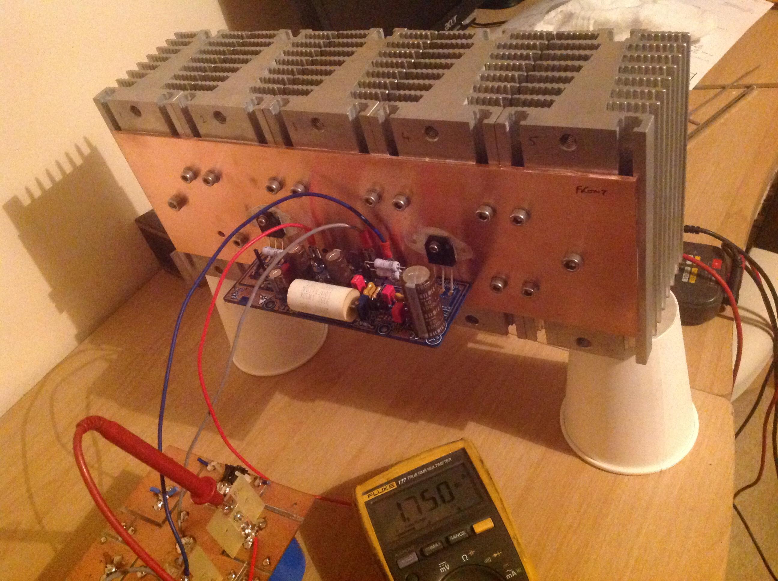

Hi all, have powered up both channels, one at a time, and I am not quite sure of the offset results. Connected to a temporary supply with 25V rails with 22000uf on each rail. Current approx 1.7A.
With shorted input to ground, meter on mV DC, no loudspeaker connected the meter dances continually between approx -25mV to +25mV.
Removing the short on the input and with DVM set to AC volts the output shows approx 26V when the input is touched with fingers and shows 0mV when finger removed, so it is certainly amplifying.
Adjusting the pot for offset appears to make no difference. Should I have a load connected to check offset? Both channels behave the same.
Regards
Alan
Regards
Alan
Beautiful open frame design Pcgab! Very tidy and organized cables.
Just look at DC voltage through R131 when you flip the switch. Should be about 0.61vdc within 2 seconds. If >1v kill power and debug. You can short audio input or simply not connect it and I got same answer. About 0mV to 2mV hot or cold or anywhere in between. It was as they say, “brain dead simple.”
0.61v over 0.47ohms is 1.3amps. Interestingly, with 0.33R it was almost the same voltage.
Of course, test one channel at a time. Verify correct polarity. +ve on right side with audio input on top.

It should not dance around with or without load. What is AC volt reading at output with input grounded?
If DC offset is 25mV and no AC from oscillation, connect a test speaker and check for sound. What is Vdc across R131? What is Vac across R131 and R132?
Thanks X!
It's 'open frame' design is intended for testing, I'll put it in a proper case once it's all wrapped up.
Thank you for the measurement tips.
Gable
Gable

So are you going to build an Alpha 20, Maty? Knowing that you can boost bias and reduce voltage to accommodate those KEFs you love. Those look like fine jazz recordings. Thanks for the tip. I now need an SACD player or can computer CD/DVD read it fine?
Hi X, thanks for the reply.
V DC across R131=0.584
V AC across R131 = 1mV
V AC across R132 = 1mV
V AC at output =2mV.
I have not yet connected an audio input or loudspeaker. Wiring is untidy, so may be oscillation.
Thanks for your assistance.
Regards
Alan
Measured one channel at a time, across R131 (0.33r MRA5). Each channel measured 0.177v.
Inputs are not connected, outputs are, didn't measure offset as yet.
~Gable
~Gable
