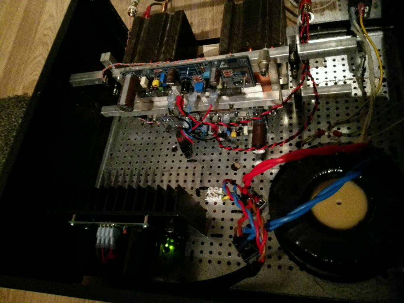

It seems so 🙂 measurements seems to be ok, 0.6v across R131 and very little dc on output.
IXTQ36P15P and IXTQ36N30P.
I was wondering that do I have enough pressure on mosfets, since plate that pushes them on copper/heatpipes gets hot like hell very quickly, while heatsinks don't heat up so quickly.
Are you using silicone heat sink spacers? I do find that torquing the bolts that clamp the MOSFETs down was important. One time I did not do it tight enough and smelled the funny “hot electronics smell” the one before puff of magic smoke occurs. I pulled the power off and discovered a loose bolt.
Tighten the clamps some more is all I can say. The clamps will get hotter because the heat to the sink and heat pipes gets dissipated very efficiently. Whereas the clamp has only slow local conduction. It may be fine. Do you have an iR thermometers? Measure MOSFET package temp.

Ok, made quick fix with 12mm aluminium bar. I have active system and tried it to lower end (20hz-800hz).

The aluminum bar/clamp does get hot, but the cpu coolers work very well with a slow fan blowing across them.

It's funny how those heatsinks are actually coldest place, clamp is MUCH hotter and capMX quite warm also. Effective little sinks. 140mm Noctua seems to work well and quietly. Toroidy's trafo is also super quiet.
Edit: I'm with higher bias right now, don't have right resistors at hands.
