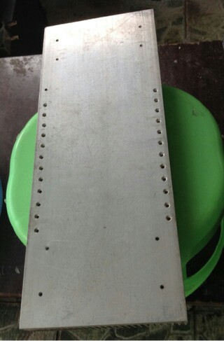

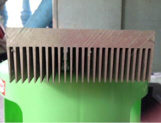

is this hs is enough for one channel alpha 20 ?
i would mount then on top of my case .
dimension 300x120x45
