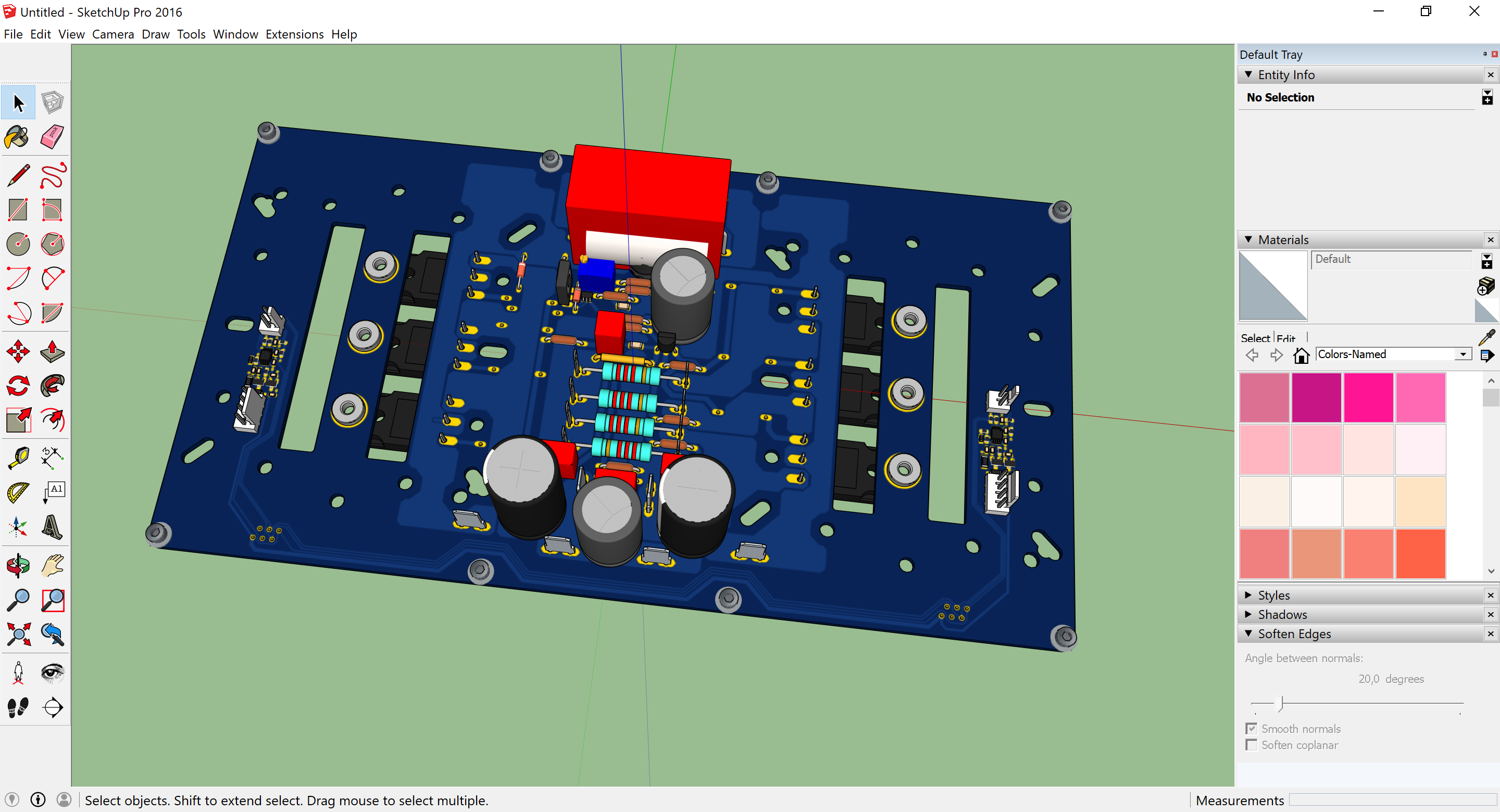

Big specification submitted for control, ready to work on BB.
Progress:

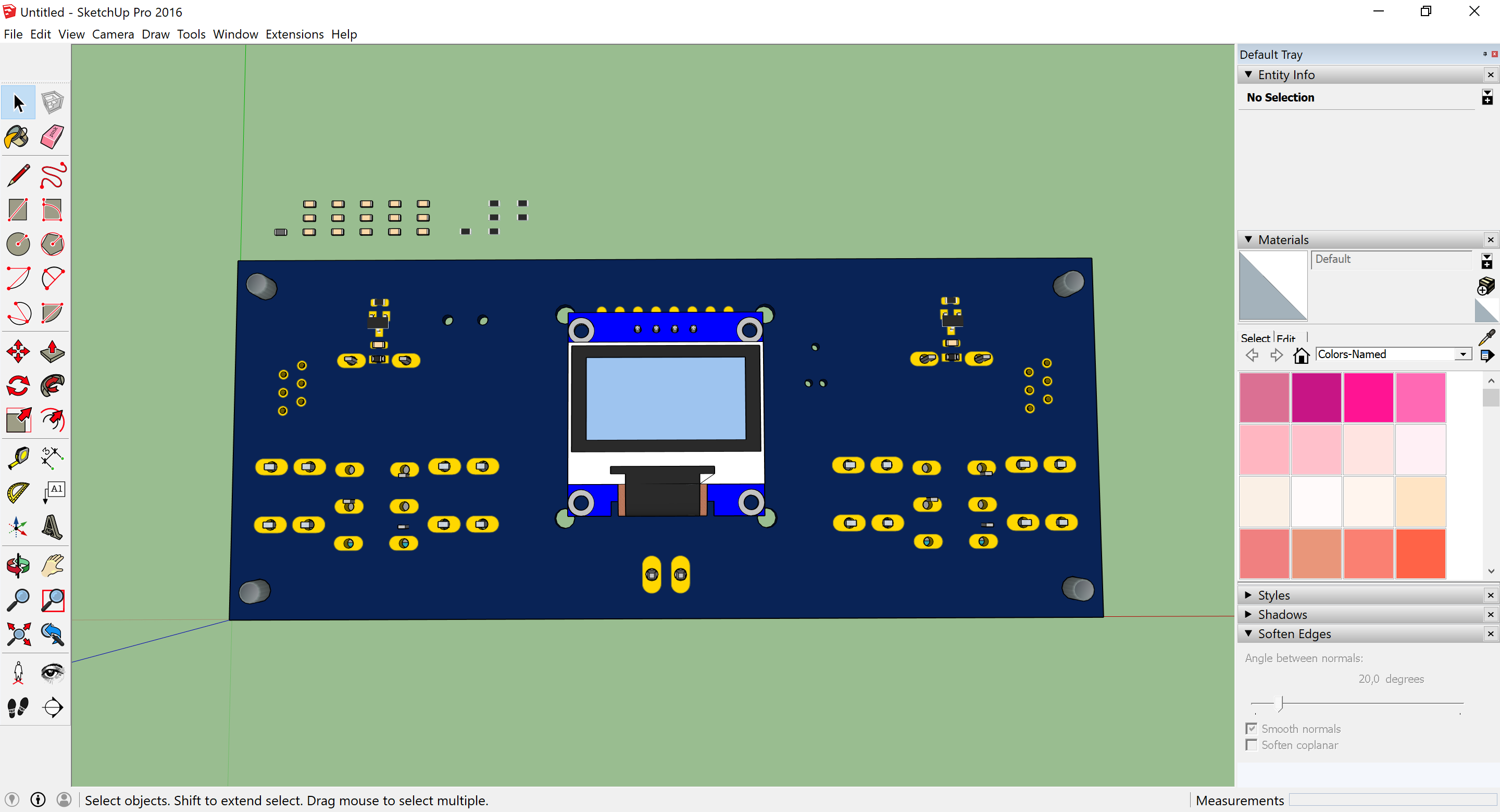

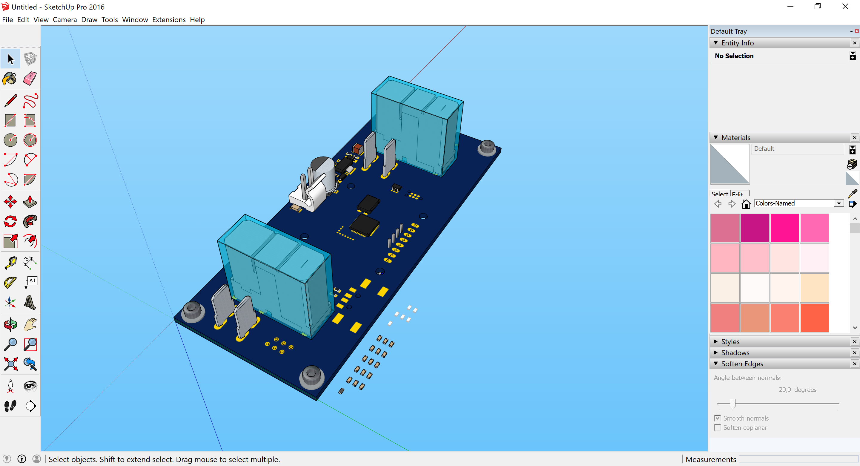

- I´ve still to clear and definitively fix universal clamping solution (also usable for liquid cooling systems): I´ll order a 3D printed mockup and different CPU fan cooler beginning next week and it´s not cheap (perhaps directly PCB?)

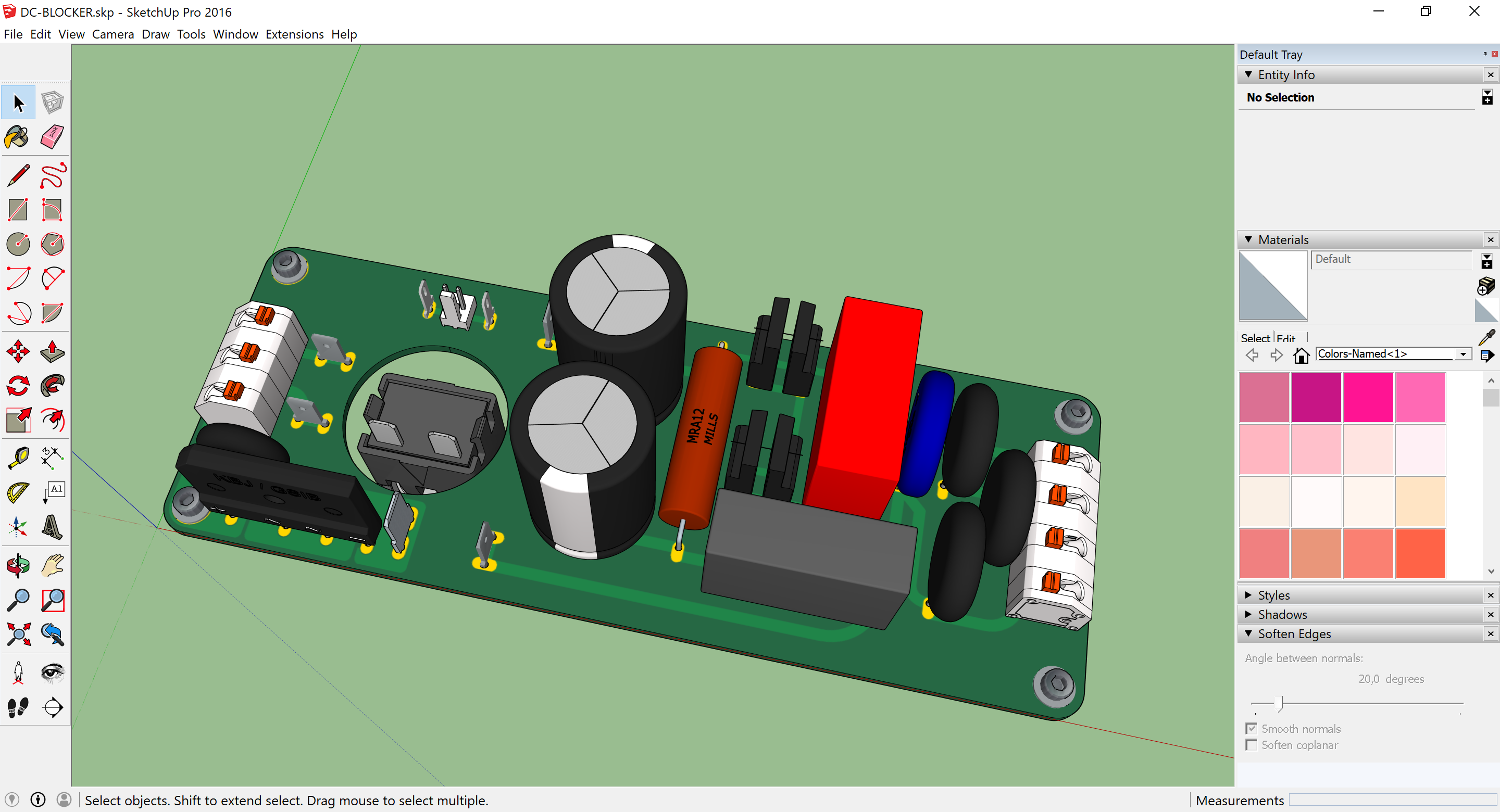

- today I´m working on the µC fan control: thinking about specific board including main filter, main switch, inrush current limiter, DC blocker...
PWM supplies needs some strong filtering, not yet implemented on BB board.

Wow, that's like a commercially idiot-proofed fancy eye-candy solution there. Very cool.
I have a 3d printer but the nozzle is clogged and I never had a chance to fix it. One of those things on the "to do" list...
Maybe the GB can crowd-source you with the 3d printing costs for the pathfinder? How much are we talking about?
Basically, we make that part of the cost of the GB PCB's for the ALPHA 52W BB - and share the cost for all who want to participate in the GB.
Thanks for all you efforts. Looks wonderful.
Yes, JPS, it looks wonderful, very neat and tidy.
I really prefer however that there only a single pair to avoid the matching issue. That pre-empts 480W devices, or even 1040W versions from IXYS.
If you have three pairs they will have to be carefully matched of course but it's absolutely no problem if you can match them from a large sample.
Thank you again, fantastic work,
Hugh

I think that’s a good idea to spread the cost throughout the group buy so JP doesn’t foot the bill for our pleasure.
I would also like to see single robust output devices.
And, a separate power supply for the fan controls so noise issues don’t corrupt the amplifier.
Fantastic work JP!

I think that is why the fan controller is a separate board:
664253d1519376304-aksa-lender-mos-hybrid-aleph-alpha-amplifier-fan_1-png
