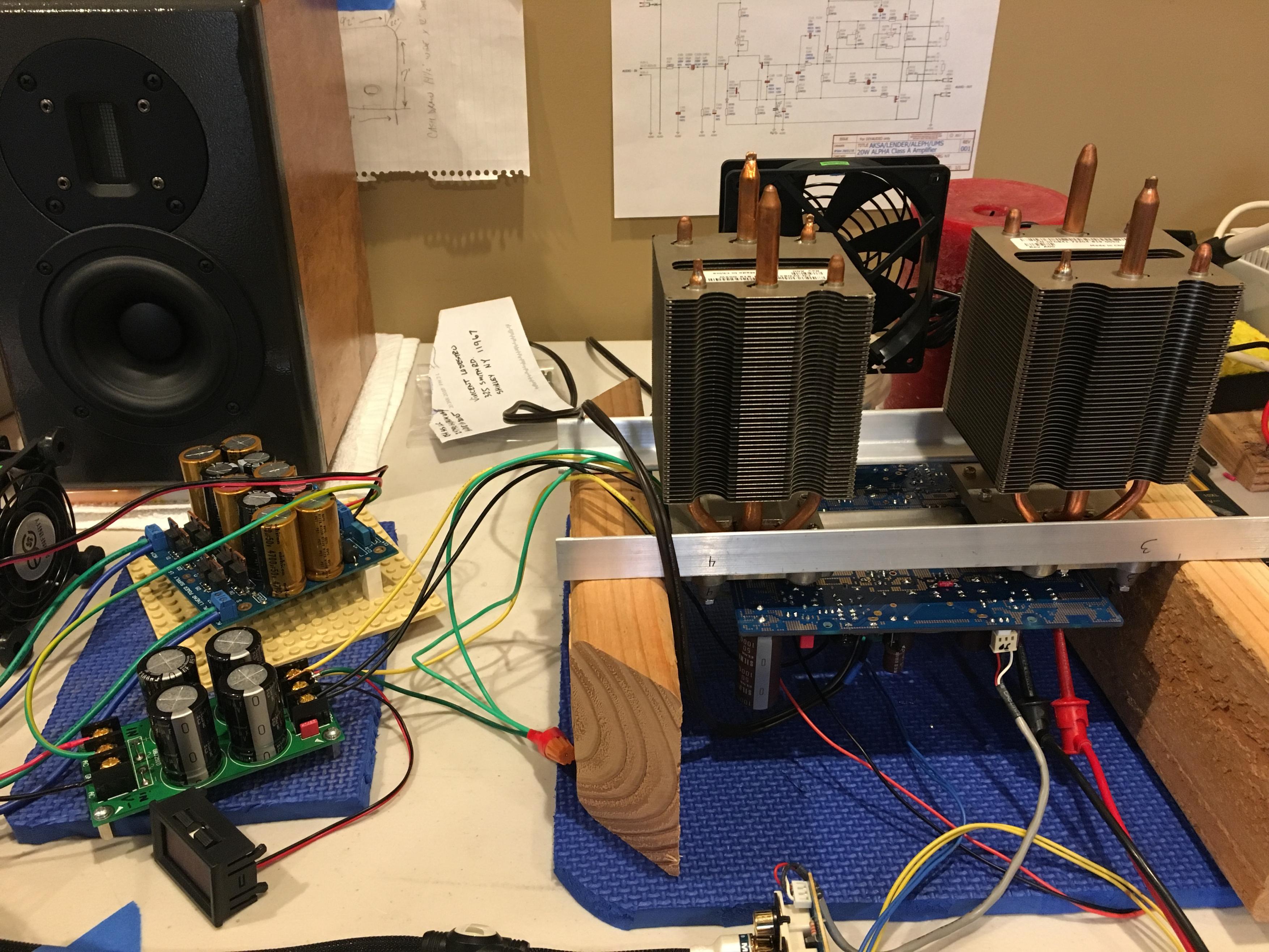

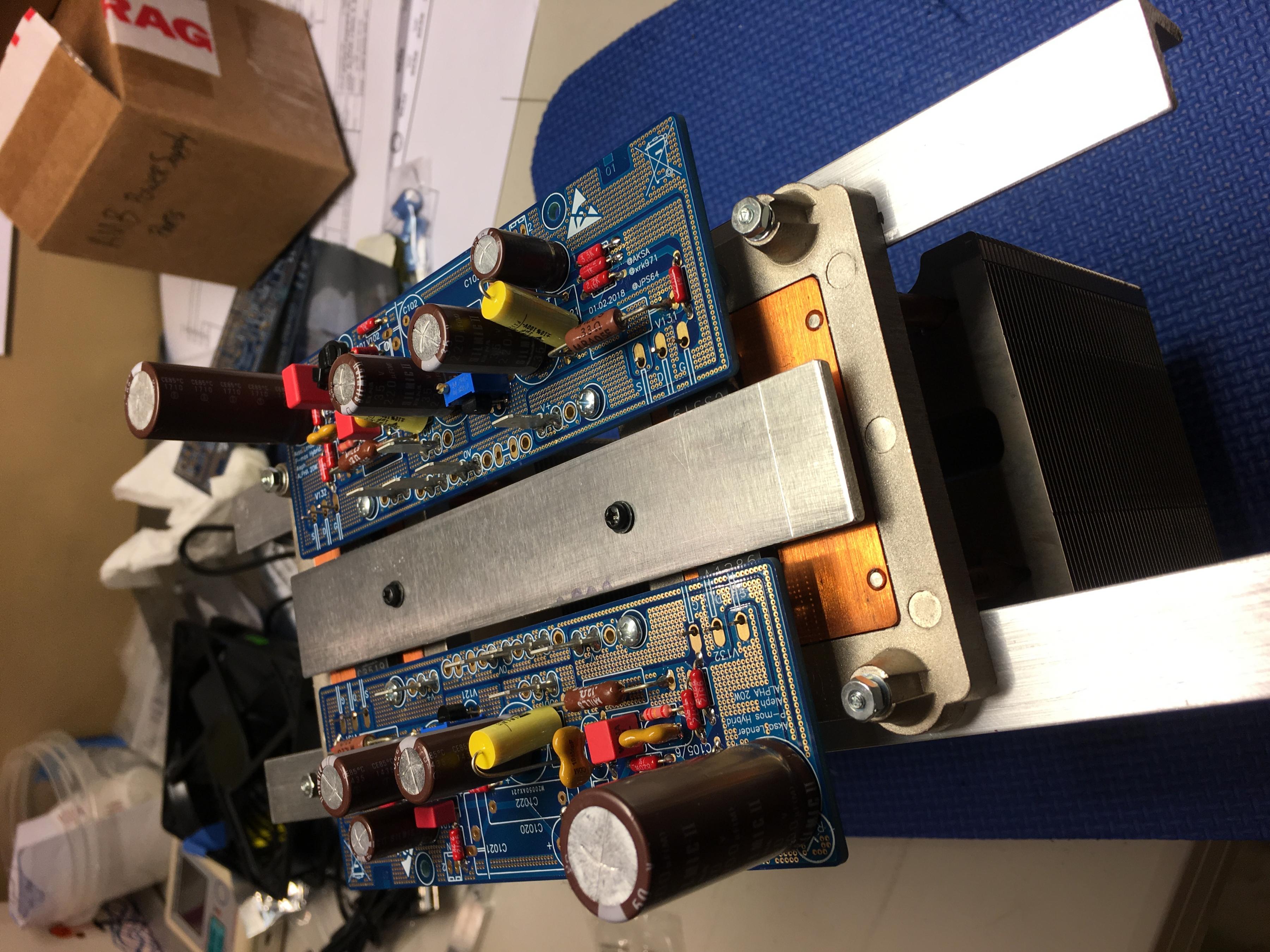

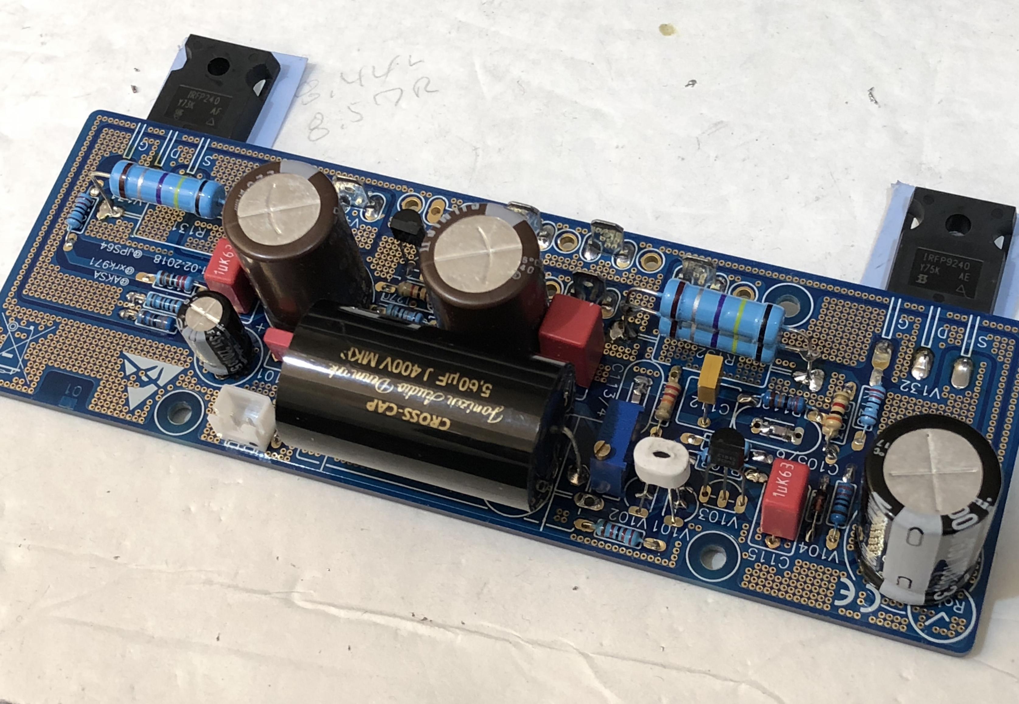

I swapped out my input caps (10uF Silmic II and Panasonic 3.3uF 250v MKT) for a Jantzen 5.6uF 400v MKP. And changed the source resistors to metal thin film 1%. It measures the same as before. Listening to it now, I think the sparkle of the highs is better. It’s subtle but there is a difference.

Hi Vunce, great work, have you any pictures and how is the amplifier performing?
Regards

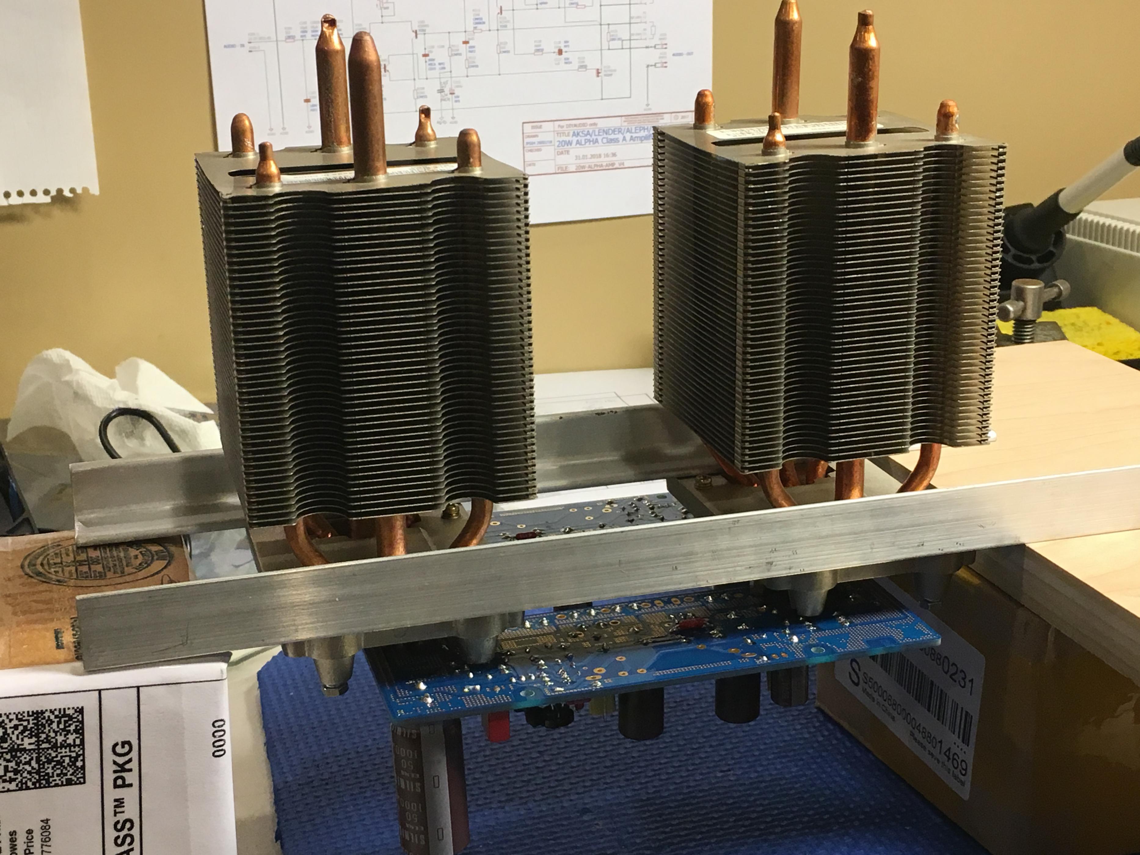

The amplifier is performing very nicely. I’m using speakers on the bench that are not an easy load (4 ohm, low 80’s sensitivity) to an uncomfortable listening level. So, this amp will have no problem “rocking” with 8ohm, 95db and up speakers.

Brilliant, Vunce,
You have marvellous cooling, too. Solid heatsinks, do you cool best with the fins vertical? I assume no fan on them when installed in the case?
Yes, 4R is not the forte for the ALPHA 20. It's a 8R amp. Theoretically you could double the current by halving the Pass CCS sense resistor - no other changes - and it might be OK with those large heatsinks to cope with the heat too.

I estimate your heatsink around 0.30C/watt.
With the dissipation of both outputs using 24V rails I estimate each module will create around 75W.
This would increase the heatsink assuming even heat distribution along the heatsink to be 75 x 0.3 = 22.5C.
I assume that inside ambient temperatures in Java would be around 28C. So final temperature would be 50.5C, 22.5C over ambient.
This is acceptable. It will be quite hot but modern mosfets will withstand this temperature for about twenty years.
Go for it - but you will need TWO heatsinks, one for each module.
