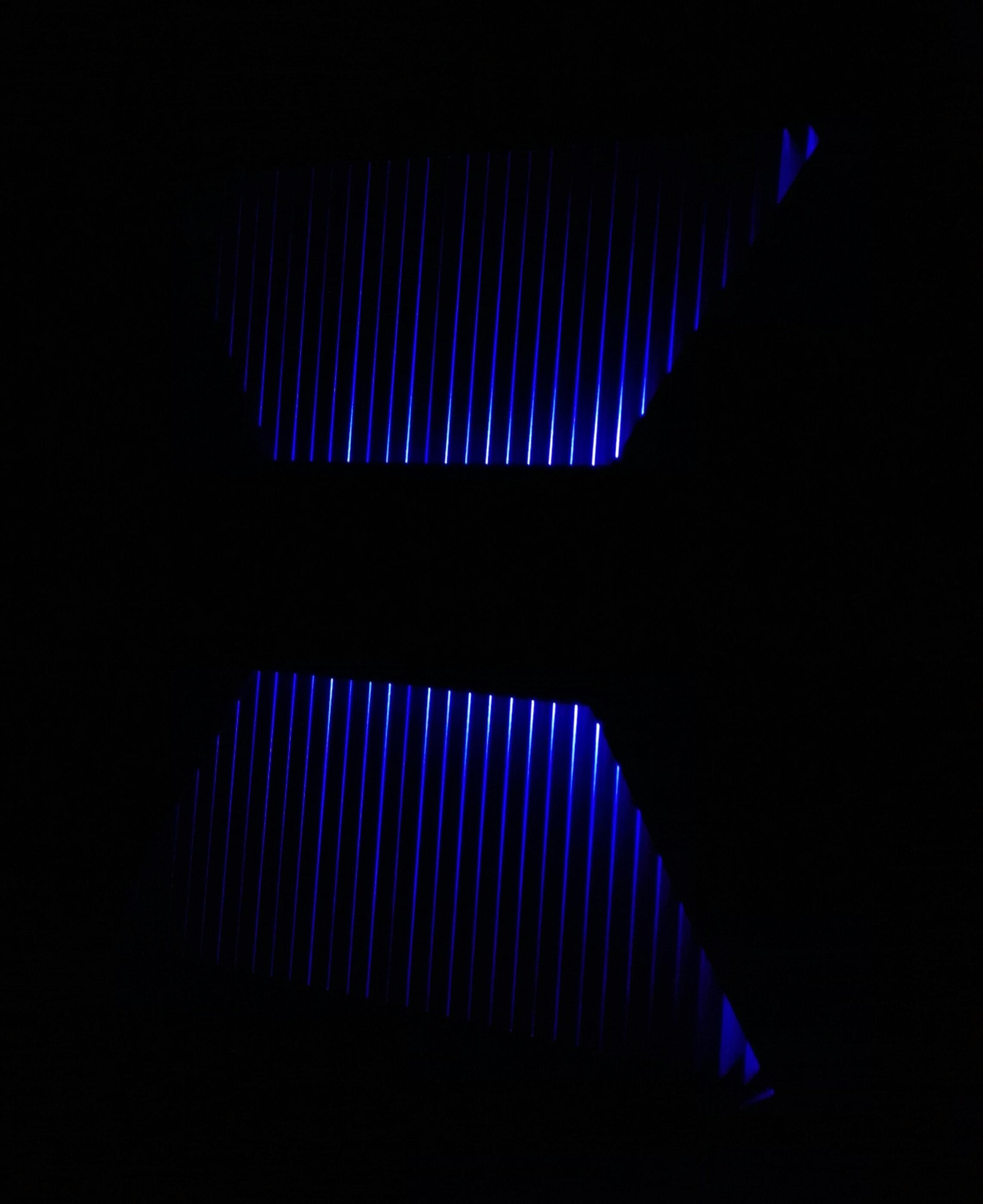

There is some case prototyping to do, but lacked motivation today. Instead I was just sitting with a cup of coffee and thinking about casing. Image is too dark, but I was wondering that I might add some kinda "shield" for heatsink, theres some space between shield and sink for ventilation. This was just a cardboard version and some exploration with power indicator light 😕 blue leds were the only one at hand. This is probably why Im so slow builder..
Sorry about constant off-topic, I'll stop it now 🙂

That’s a nice blue glow effect Juntuin. Very stealth understated high tech. I am listening to my ALPHA20 at present with a Cayin N3 as source. Interestingly, the Cayin being a portable has the most advanced DAC of all my hardware. Ak4990EN and a TI OPA1622 output stage which lets the N3 drive the ALPHA20 to clipping, if desired. The sound is very addictive. I have work to do by find myself lingering in front of my ScanSpeak 10F/8424 & RS225-8 FAST speakers for a lot longer than I would have liked to. Norah Jones sounds sublime on it.
