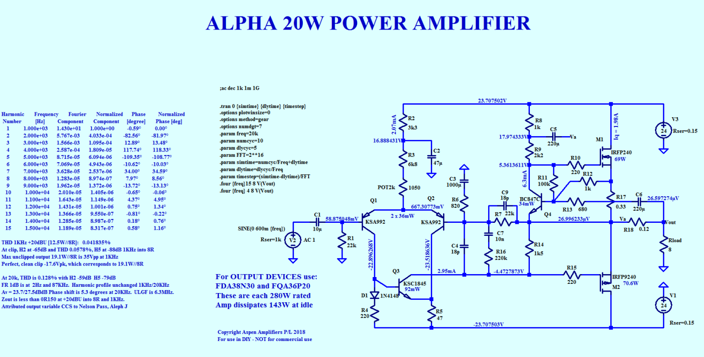

I would refer you to the GB thread for build questions. It has been a while so I do not remember why I would have bypassed C111? I would go with the schematic of v2 shown at te bottom of Post 1:
Aksa Lender P-mos Hybrid Aleph (ALPHA) Class A Amp GB
Maybe Hugh recalls what we were doing there - but it seems I have a 22pF cap n parallel with the feedback resistor. Let me go home and look at my build to see what I did. I think what you see there are experiments we were doing on v1 to see what kind of compensation cap should be used there. I would stick with 47pF silver mica.

Edit, the search feature was useful. From post:
Aksa Lender P-mos Hybrid Aleph (ALPHA) Amplifier
This was the mod that Hugh said gave extra clarity. You should probably build original amp per schematic first and once working, make this mod. Yes, jumper the cap C111 pins and add parallel cap to R154.

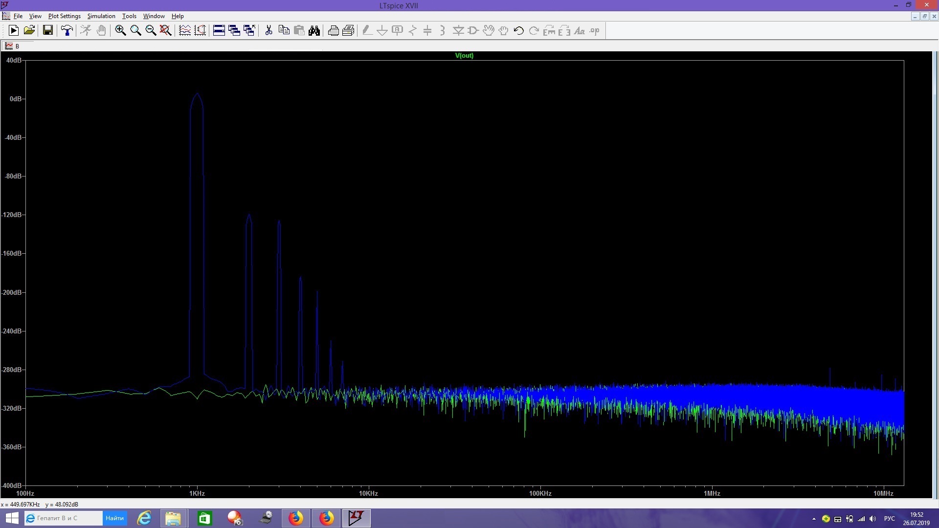

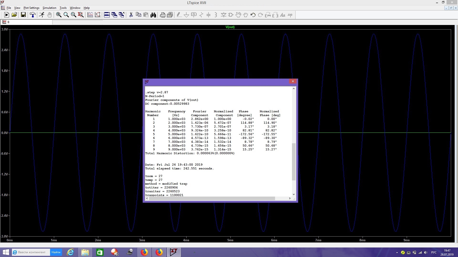

Never measured distortion at 2.87 volts. I decided to try to compare with your amplifier. Push-pull output stage. My amplifier is not covered by a negative feedback loop. Feedback is only local. The load is also 8 ohms.Gunfu,
This is a single ended Class A amp with an reactive CCS (the Aleph part of it), not a push-pull amp.
Please enlighten us with what is missing in the model below:
And BTW, the measurements match the model very well - only 2nd harmonic and a little 3rd, no nasty higher 11 and 17 harmonics of any significance.
Yes, but if you look carefully and compare with your diagram, you will see that the number of harmonics is 7, not 9 and even the second harmonic and the third and the more the following high-frequency components have a lower level than the noise, for example, in your amplifier -130 dB .
The fourth harmonic has a level of -180 dB, and this is the result for a circuit without total negative feedback.
If I repeat your diagram in LTspice, then the result will exactly match your measurements, I have already checked it repeatedly with different diagrams.

If on the forum all amplifiers would have similar characteristics, I would also very much like to lay out my scheme for discussion.
I don't know why, but your 2.87VRMS is -20 dB lower than my 2.87VRMS. This is where the real secret squirrel is hidden.

Just incase we might lead people astray - I checked against the sim and don't believe we should be jumpering across C111 for this mod. Just leave C111 disconnected/unpopulated and install new cap across R154.
