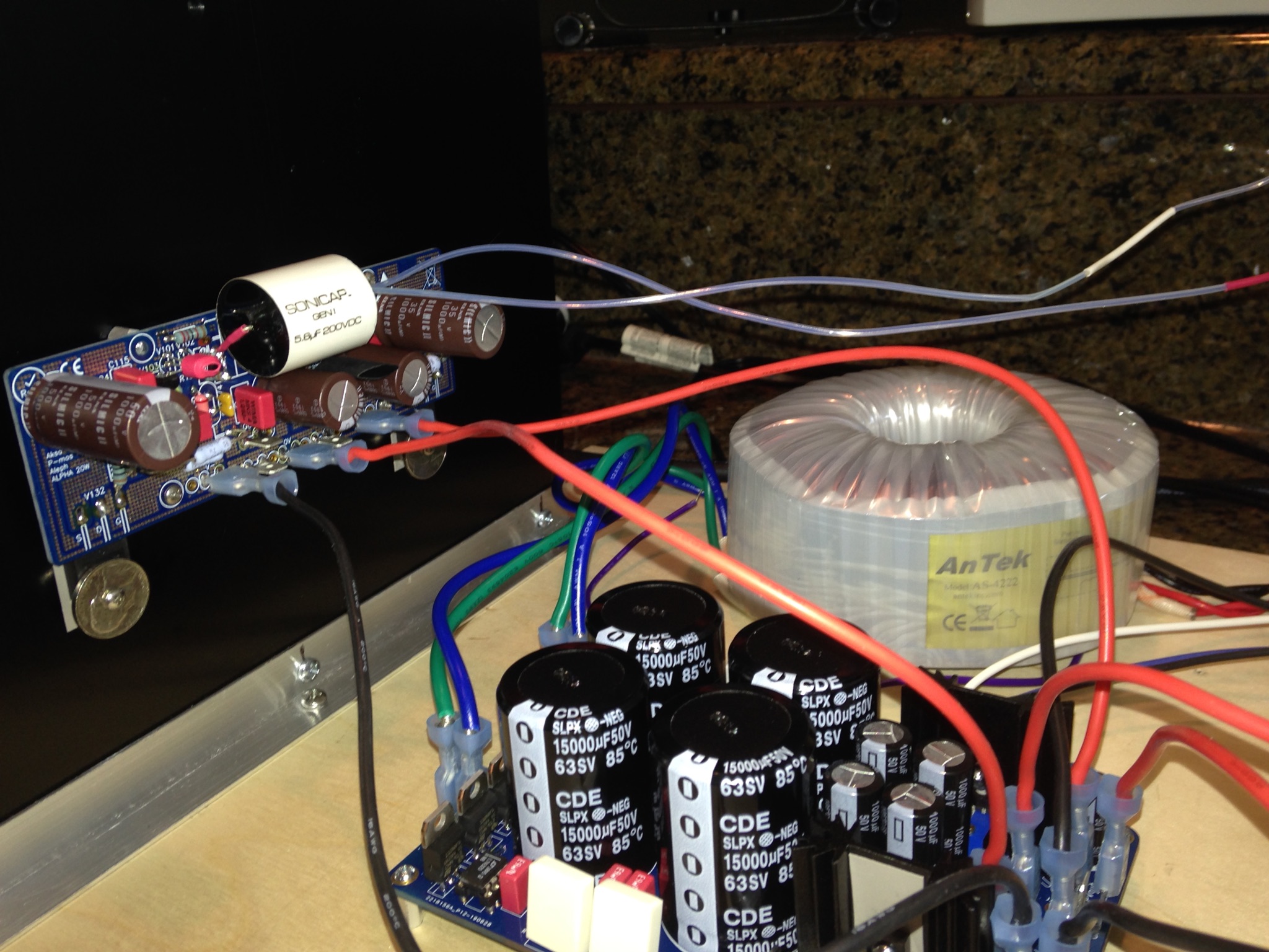

Hi Aive,
Very nice work! Sorry about the mixed MOSFETs - some fuses would have probably prevented the total meltdown. We might have to consider adding fuses at the output of the SLB in the future.
You have one ABB with heatsinks up and another with it down - that threw me for a loop there. Glad that it works well with the SLB - and this basically shows what the ABBB is like, but just more compact and with DC offset and turn on delay SSR built in.
Hi Aive,
Totally my silly mistake - still not sure how it happened, I was double checking every component before soldering. Must've been tired (that's my excuse) >< Luckily no speakers were plugged in, it was just first powerup on the bench. If I had a variac might've been safe.

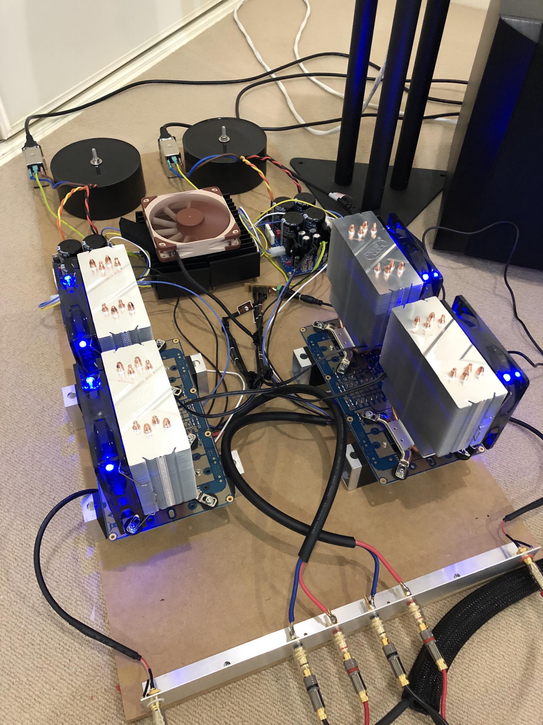

Was a great project Hugh I had a lot of fun and late nights putting it all together - you were right weeks ago, it's a big job but very satisfying
I couldn't dial up the volume late last night, but plan to have some good listening time this arvo
Oh I'm in QLD btw, which is hot too

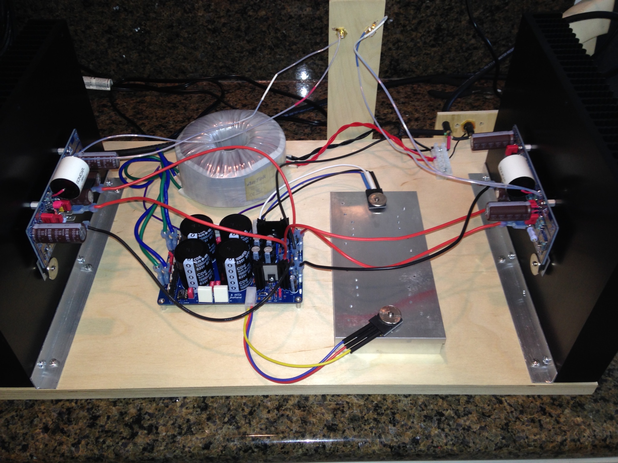

Curiously - one channel's FETs are ~5deg C higher in temp at the heatsinks compared to the other channel.
Bias measures about the same between channels, 0.6 vs .61 V across R147/46/45. The higher temp channel has the slightly lower voltage oddly enough..
Anything to be concerned about? Could be mechanical/mounting related....

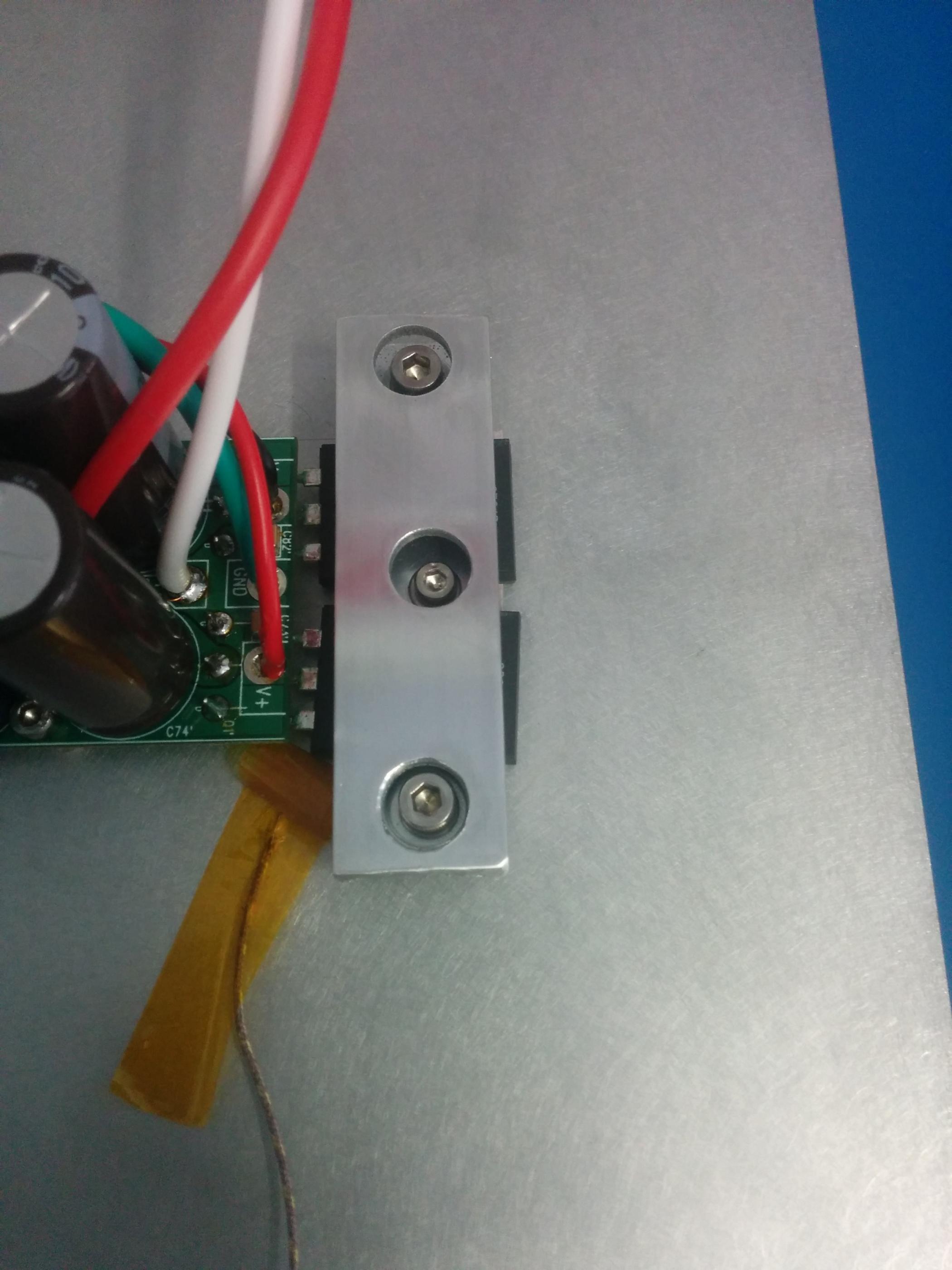

If your heatsink pressure from clamp bolts is not the same the temps will be different. This is normal - but indicates you can perhaps tighten the bolts a bit or use more evenly spread heatsink paste.
Thanks for the tip - a mate also suggested same thing. I’ve tried retightening and the difference has reduced. I just didn’t get the FET mounting heights exactly the same across boards unfortunately.

I did a high bias class ab amp (The Wire - LME49830 + lateral mosfets) a few years ago and played around with clamping the fets down in that build. See attached some photos I dug up of the final clamp I used. I was inspired by EUVL's Linear Audio article regarding the design decisions in the F5X chassis
