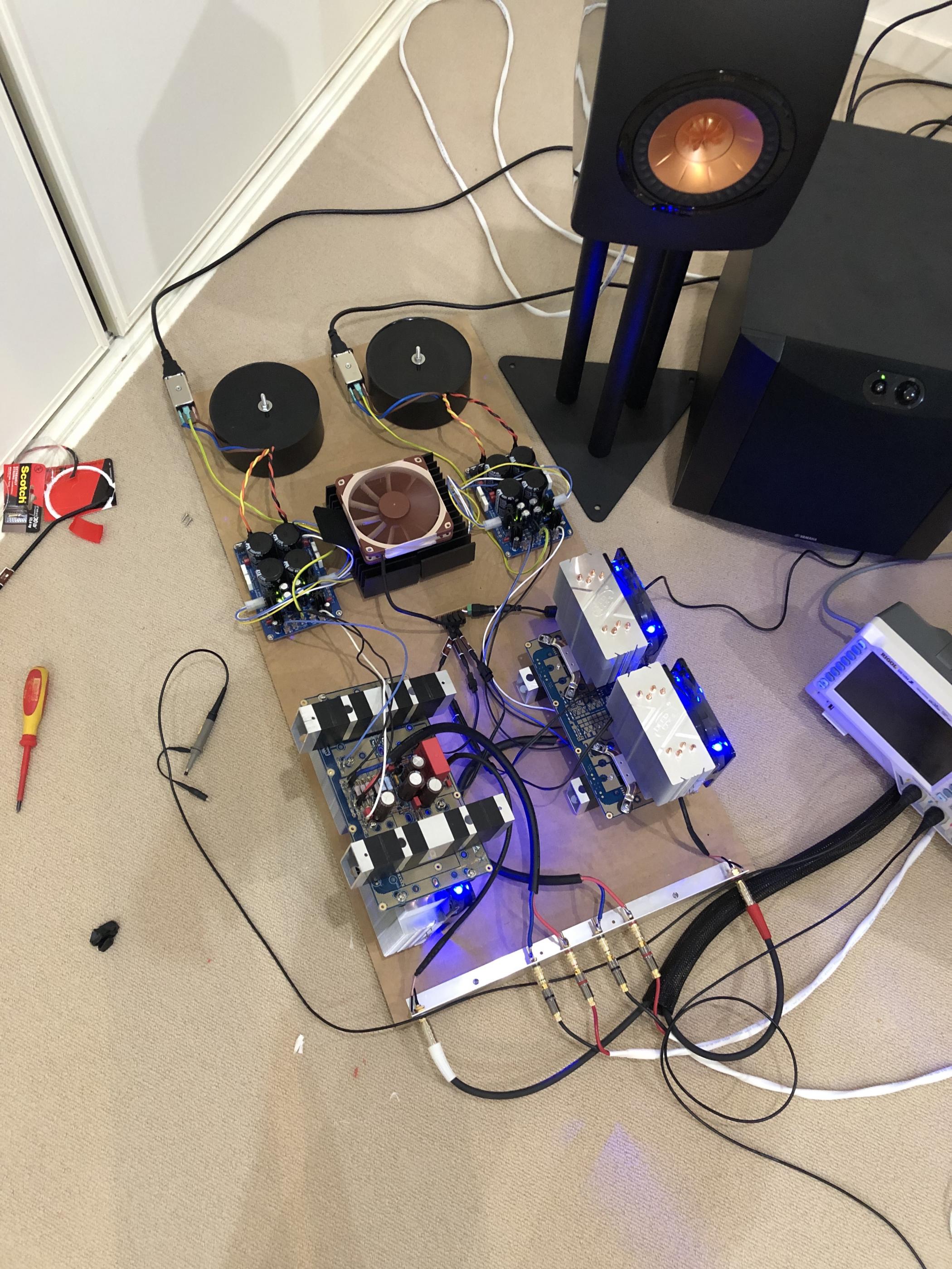

Looking good, and are those Nuvotem Talema potted transformers?
Yah from RS - one hums quite badly up close, but they were relatively cheap
500VA, 32V no load secondary ratings. Seemed made for the ABB.

Can we ask what trafo's you ended up getting?
Zman01 has some experience getting 500VA (?) Toroidy's shipped to AUS then hand-carried (I feel sorry for his friend's back lugging these around) to Dhaka - LOL
Yah I got these as shown in the previous build photo: 0500P1-2-030K | 2 Output Toroidal Transformer, 500VA, 2 x 30V ac | RS Components
The RSPRO branded version of the same unit is: 2 Output Toroidal Transformer, 500VA, 2 x 30V ac | RS Components
There's also non-potted versions available at RS.
Quite affordable compared to other options in Australia

She's alive!
Sounds gorgeous Thanks to all involved in its design.
Congrats Aive!!
Another Alpha BB is born
What is the working voltage you ended up with?
