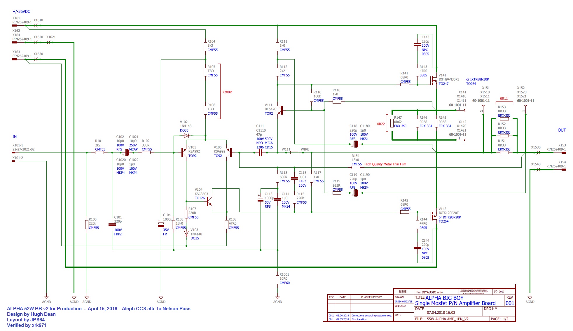

Hi, BB BOM specifies IXFH94N30P3 but I went looking for something with a TO-264 package to match the P-channel.
Would IXFK170N20T/IXFX170N20T be appropriate replacement? It has very similar transconductance and is available in TO-264. Ciss is very different to the P-channel though, but that is also the case with the IXFH94N30P3.
Thanks :)
Founder of XSA-Labs
Joined 2012
Have you tried looking for MOSFETs specified in schematic for Alpha BB? There are TO264’s there IXTK88N30P and IXTK90P20P:
675435d1523845018-aksa-lender-mos-hybrid-aleph-alpha-amplifier-alpha-bb-production-schematic-v2-jpg
