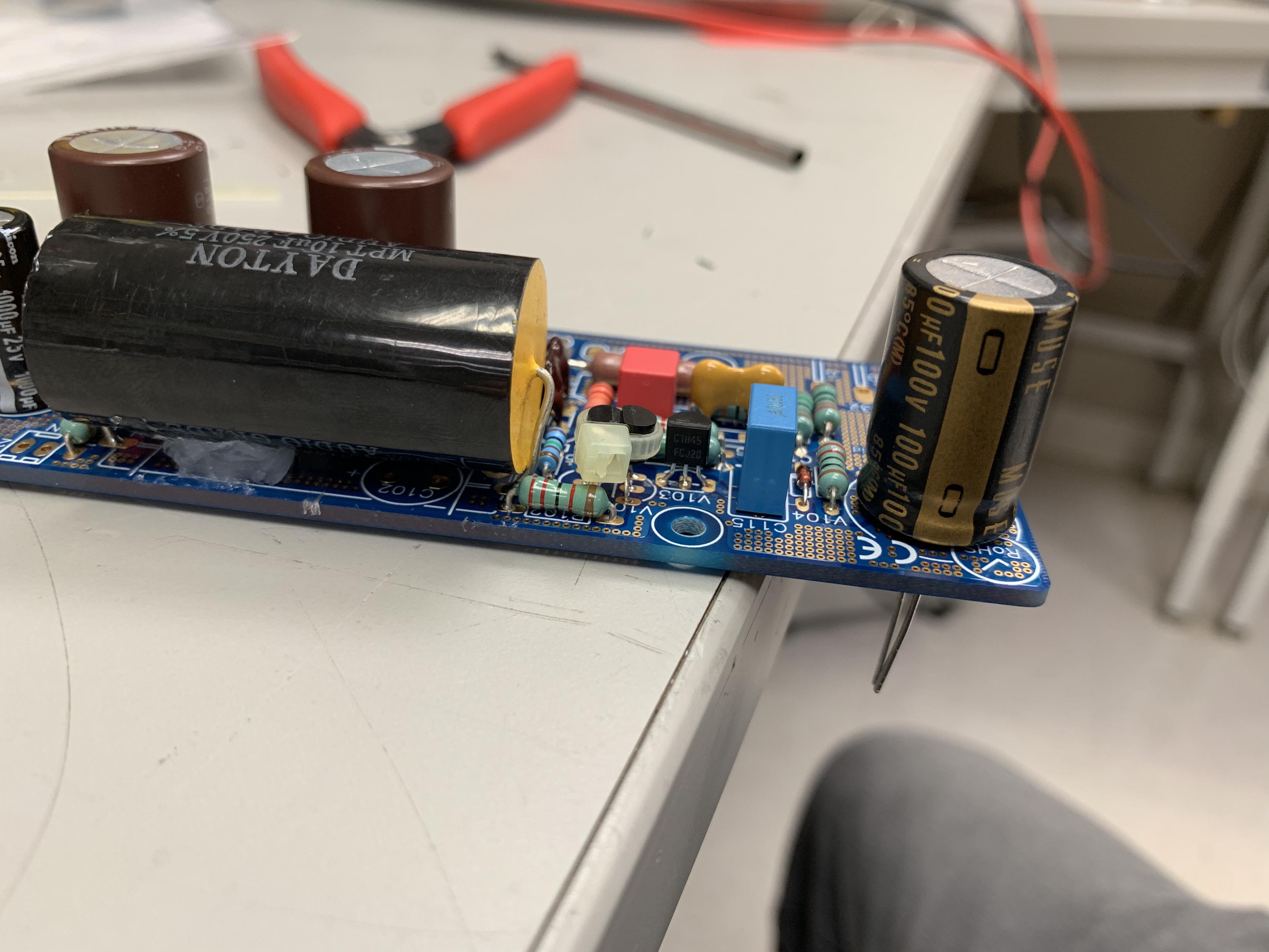

Nice that you are getting close. Shrink tubing over the transistor pair works too vs zip tie. To get started, a 10uF electrolytic cap for input coupling works well to tell you if its working. And a 10uF Silmic II for $0.10 sounds darn good.
I do have a couple of 10uF Silmic but didn’t think there was room. Should I snake the leads under the Dayton or the back side of the PCB to C102?
If you do use an electrolytic cap for input, I believe the polarity stenciled on the board is reversed.
Thanks, Vunce. Yes, the positive side should fave the input transistor. Although the DC level there is 50mV so would probably work either way.
Oh man! I've had my input caps reversed this whole time...
Apparently no ill effects with them reversed though. Still think the amp sounds fantastic, but I'll have to turn them around and have another listen.
