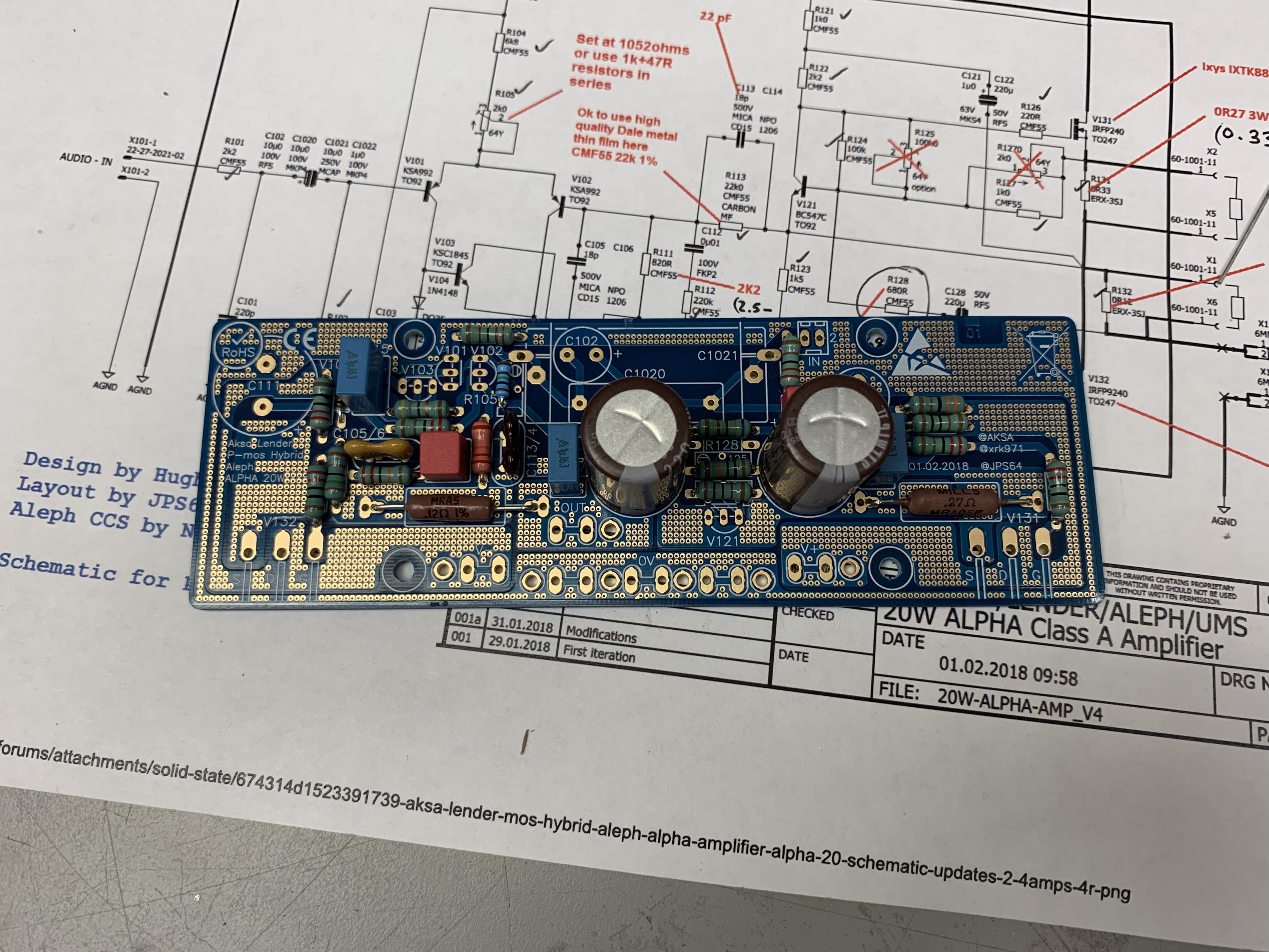

Thank you for the feed back. I have started the build of the 4R using 22k/2.2k for R113 and R111. I’ll try a couple values for the bypass cap for R111 and maybe a few R in 128.

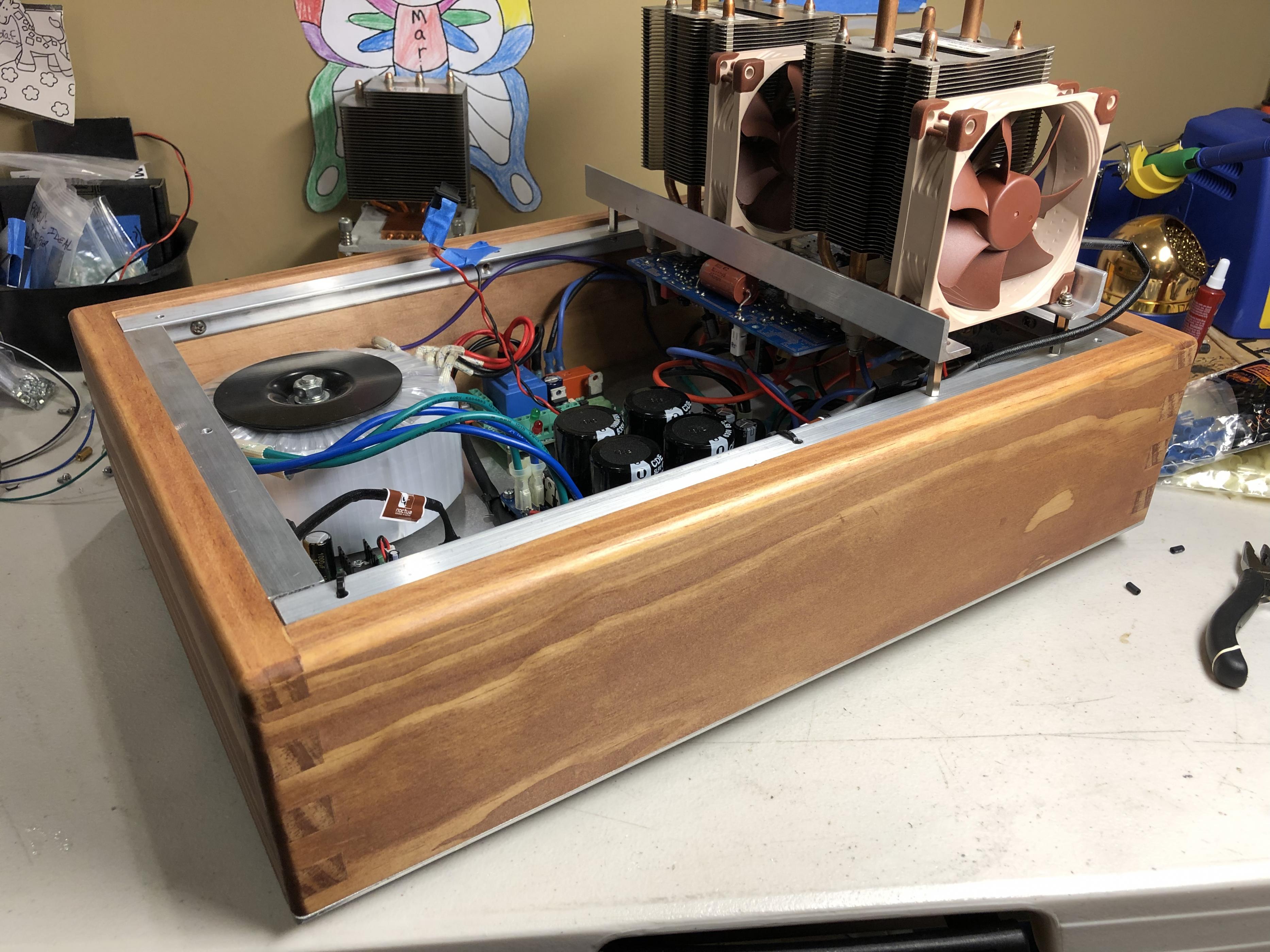

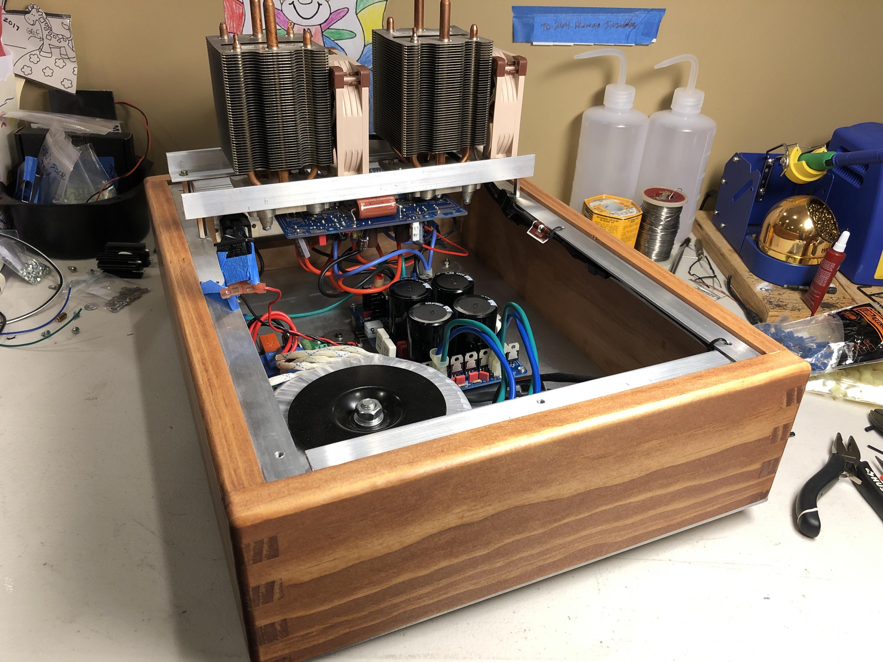

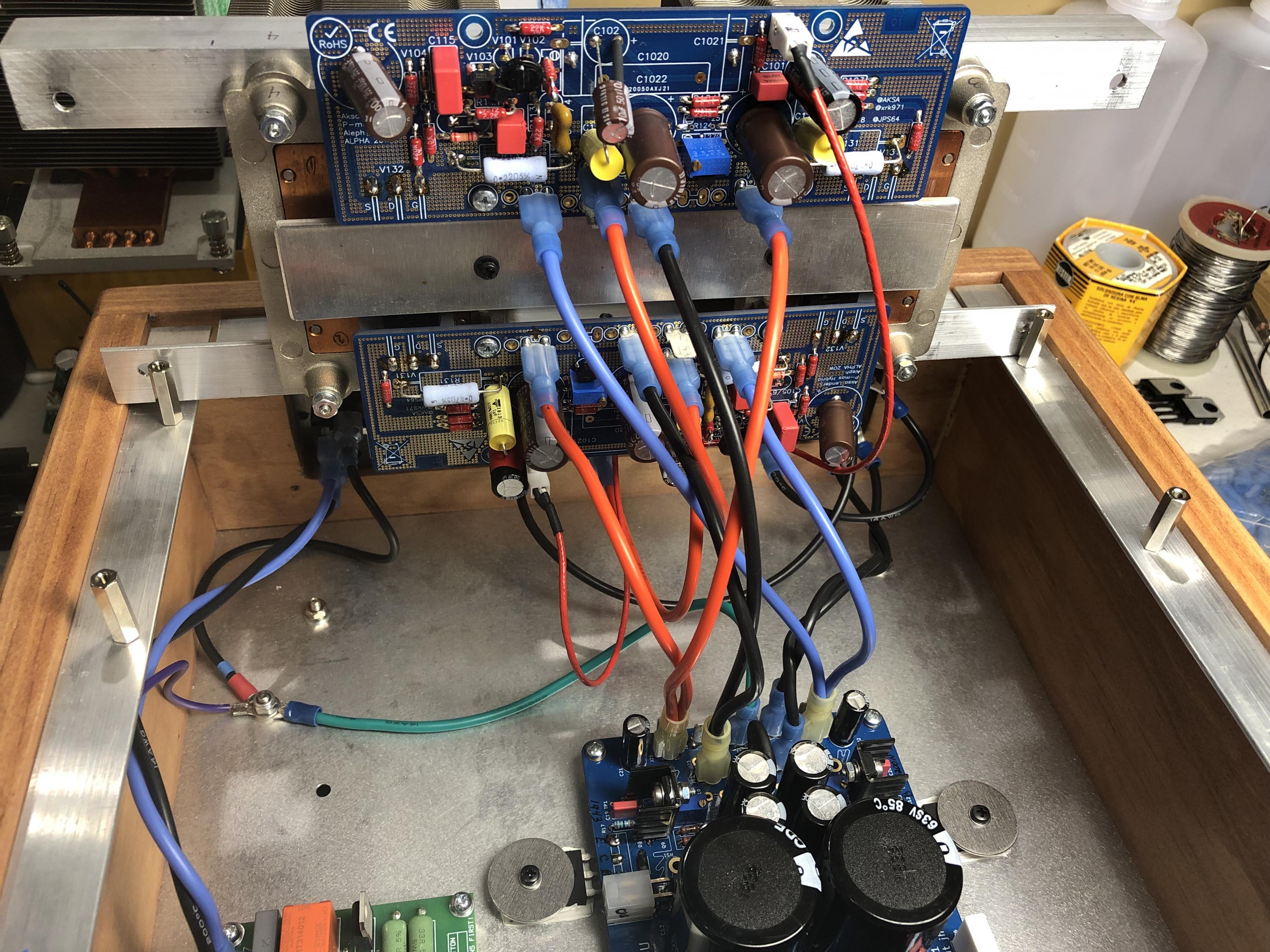

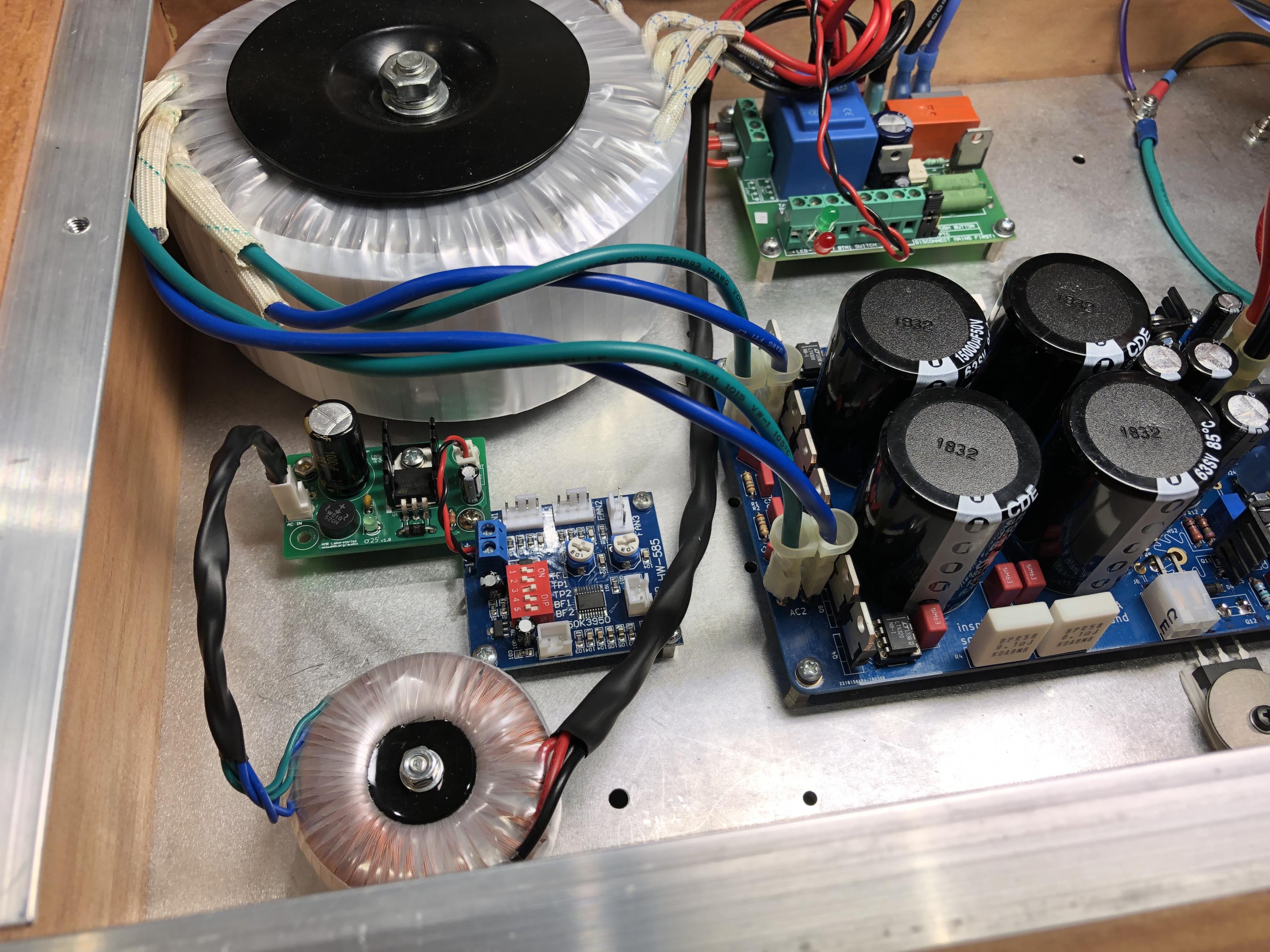

Hello Alpha Builders,
I’ve remodeled my Alpha20 to utilize the new SLB psu and also added a regulated linear psu to power the PWM fan controller.
I’m happy to report that the “remodel” was well worth it! The amplifier is much quieter at idle, almost silent. Revisiting this project has me thinking that I’ll build another set of boards following one of Danny’s 1.95A, 4R/8R models. (Thanks for all the Alpha20 modeling you’ve done 🙂)

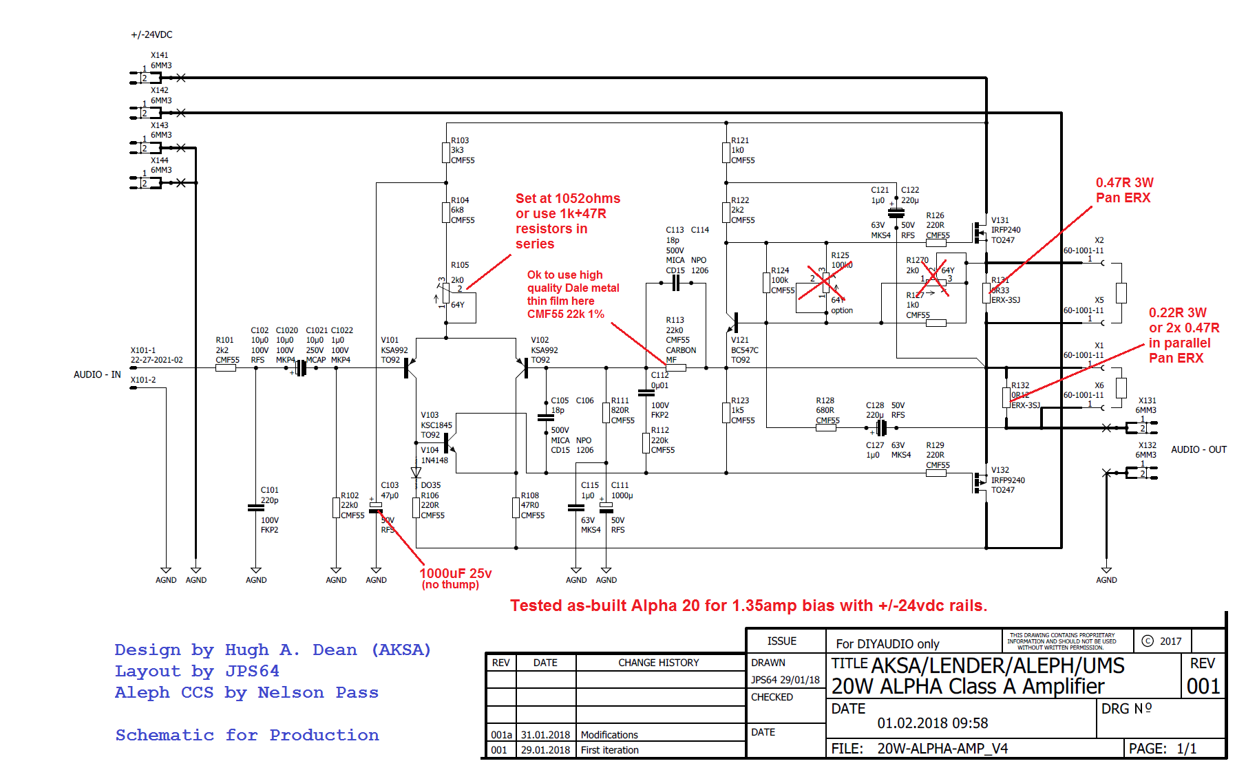

Hi Raptor Lightning,
I, like yourself will be building an Alpha 20 so I asked similar questions way back when. It is important to know the impedance curve of your speaker. My impedance nadir is 4.8 ohms (and only over a limited bandwidth, i.e. 100-300 Hz), as such I can get by with a bias of 1.96A which helps from a heat dissipation standpoint as I can get away with passive cooling. I would double check the impedance curve of your loudspeaker as there are several versions of the Alpha 20 you can build from a low bias of 1.35A to higher biases of 2.4A. The frequency range over which your speakers are dropping near 4 ohms will also be very important to ascertain. If it drops to 4 ohms at frequency extremes (i.e. 20Hz or 20khz), it obviously doesn't matter. I would take a close look at the impedance curve in the musical region (i.e. 50hz to about 5+khz) and then build the right version of the Alpha 20 thereafter. Obviously the 2.4A versions need an enormously large heatsink but a better option is active cooling.
Using the schematic on post 2780, as well as the changes mentioned on post 2789 and reading through Danny_66's post 3201, I determined that for my purposes, I can build an amp that has about 94+ watts of heat dissipation/ch (+/- 24V @ 1.96A) and can be passively cooled using a 5U/400 chassis. I will be using an SLB supply as you are planning. For a soft start I have Neurochrome's excellent ISS board I have already built.
Regarding the input impedance, please understand that 20k ohms is not really that low (especially in the solid state world 😉 ), and in my application, I am using a TAPX preamp which is an autoformer based volume control that provides all the advantages of a passive pre along with a very low output impedance (typically less than 1 ohm in my use, given that my dac has >2V RMS output and my speakers are 96dB efficient). I would look into it if I were you or drive the amp directly from your DAC (if it has its own volume control). Of course the other option is to use an active preamp.
But as Hugh said, the amp as currently designed, particularly with the input stage and feedback circuit is a done deal and a redesign would mean a rebuild as well as further measurements and testing.
