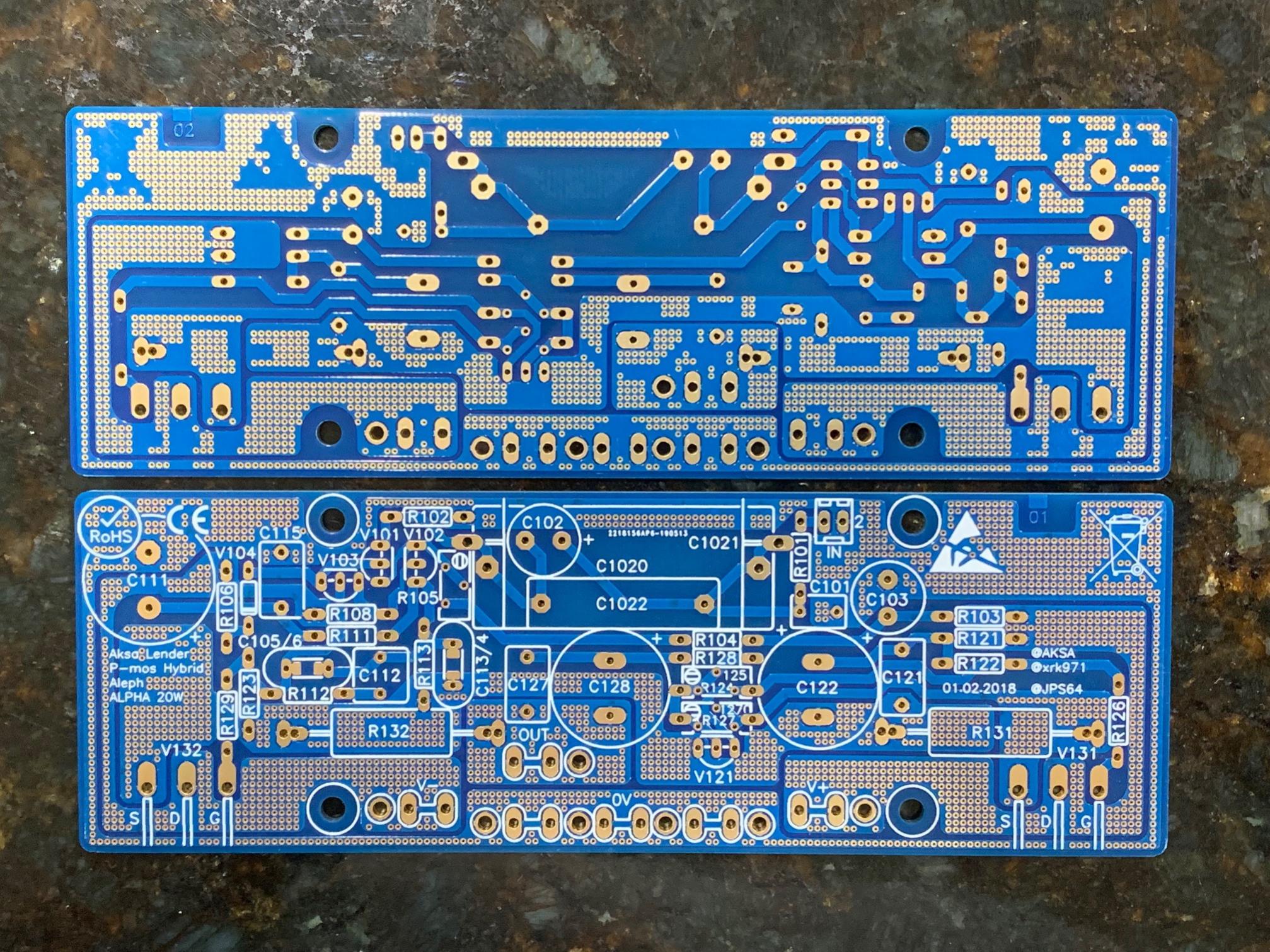

I just received a new batch of Alpha 20 PCBs, in case anyone was looking to try it. They recently ran out of stock in my shop. A great amp to pair with the new SLB power supply.
Very good DIY Class A project, even for beginners. 🙂
