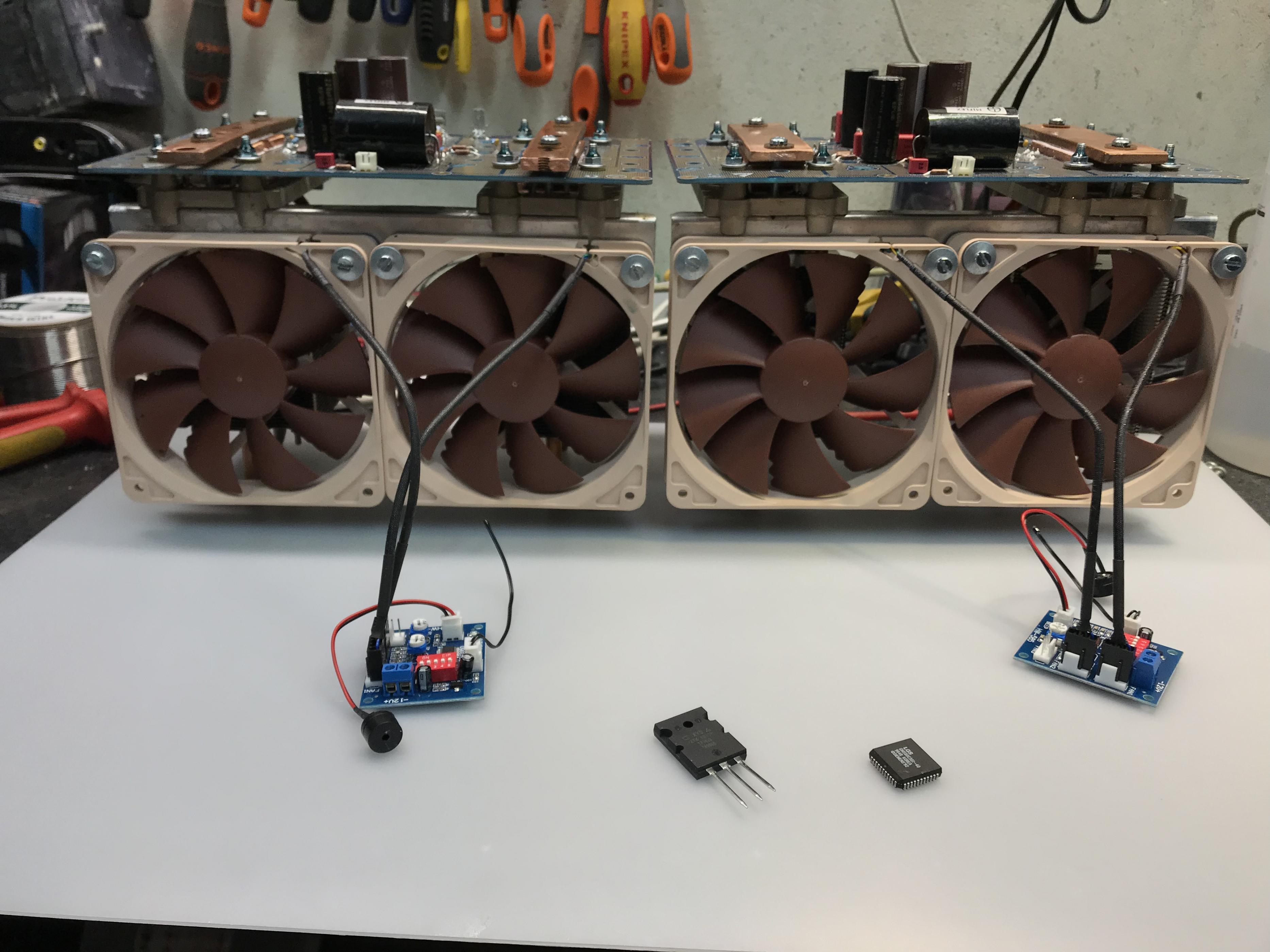

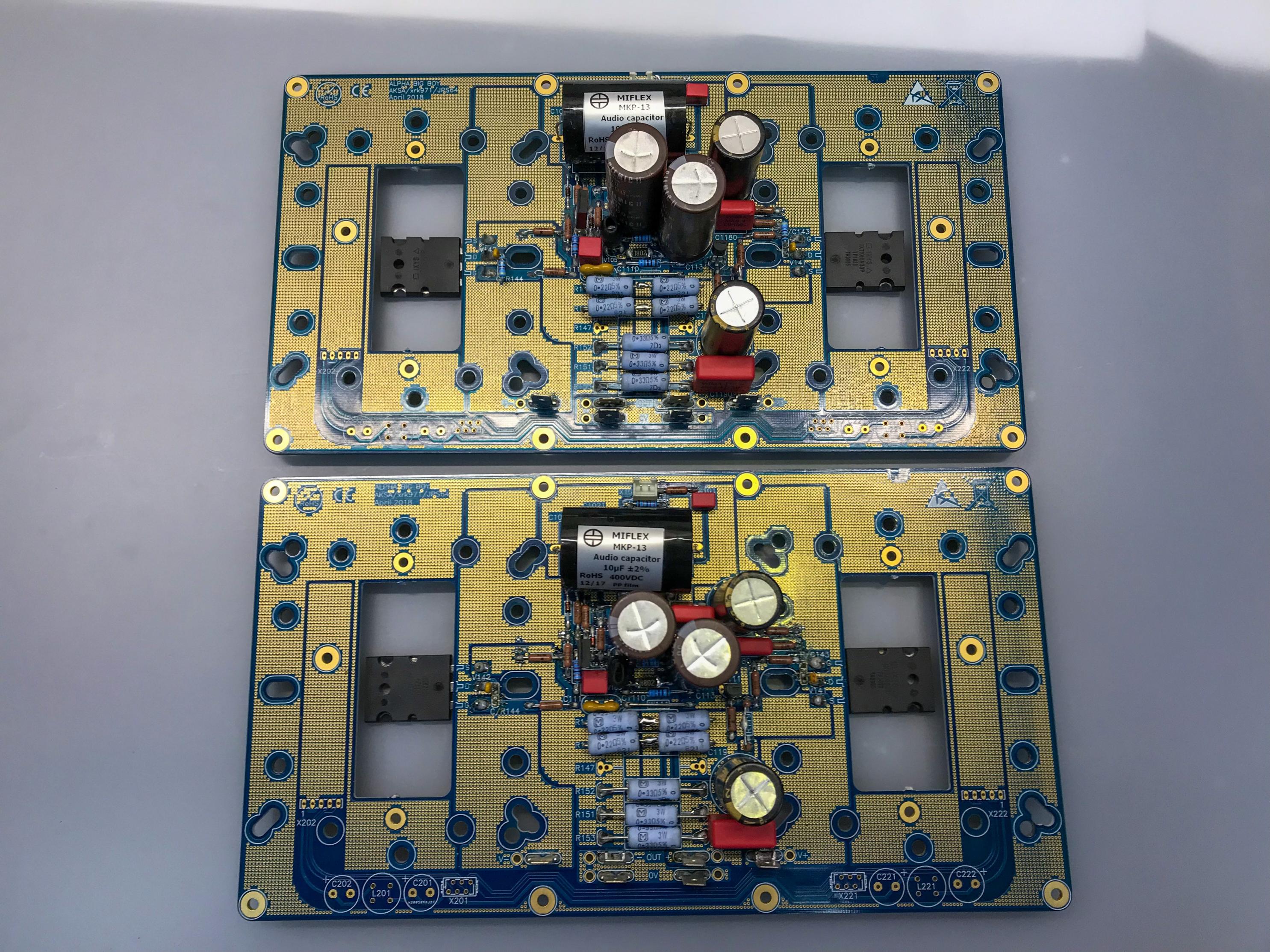

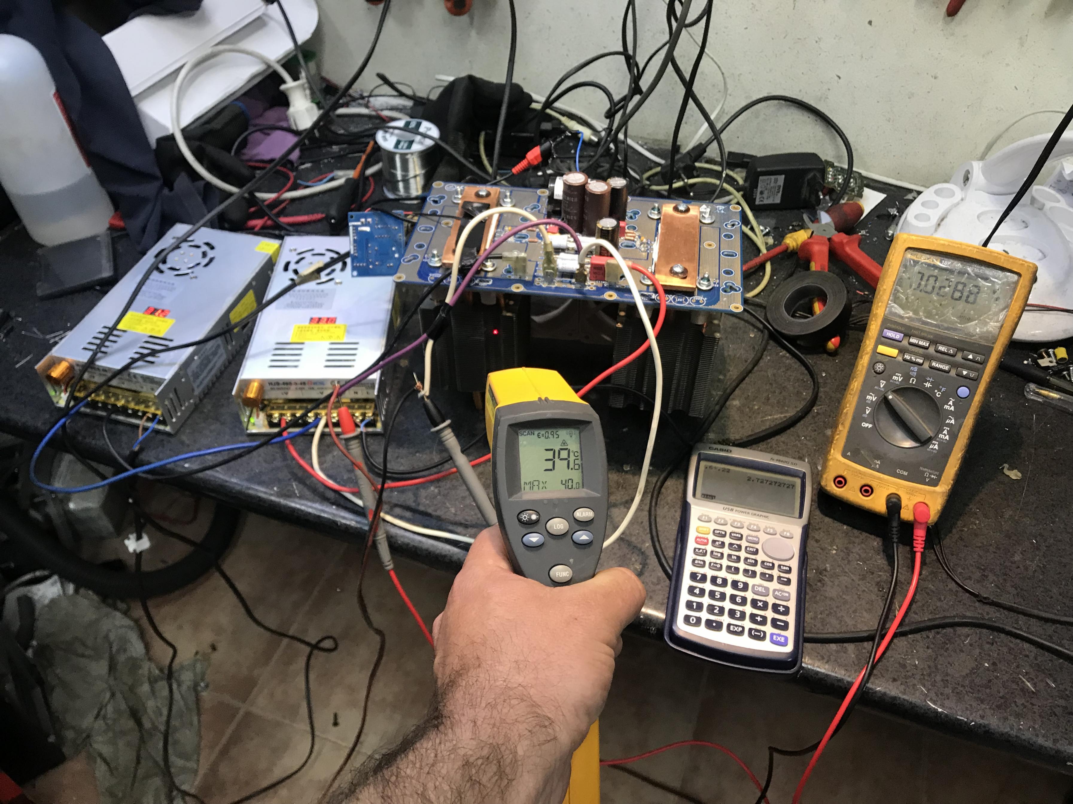

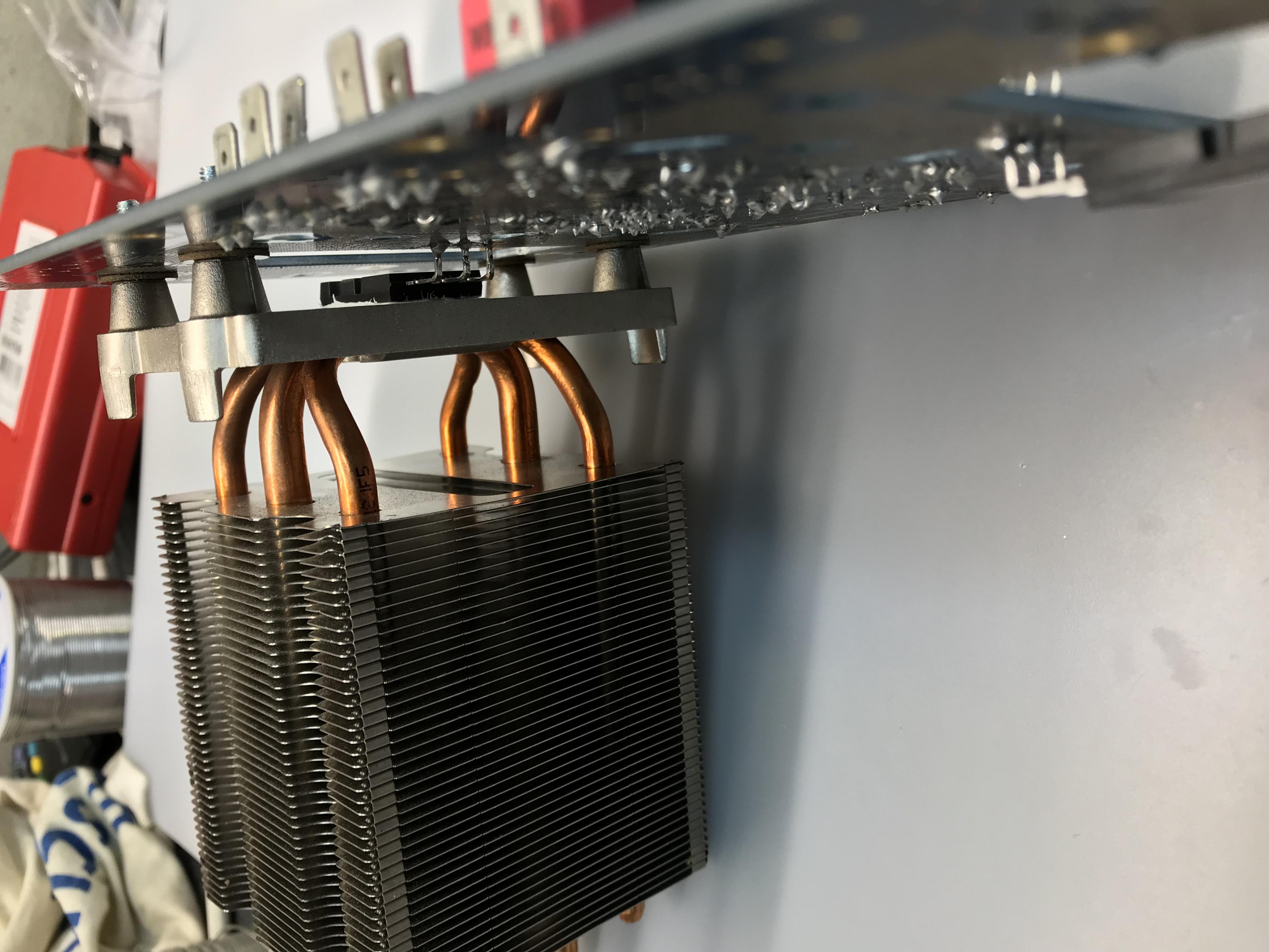

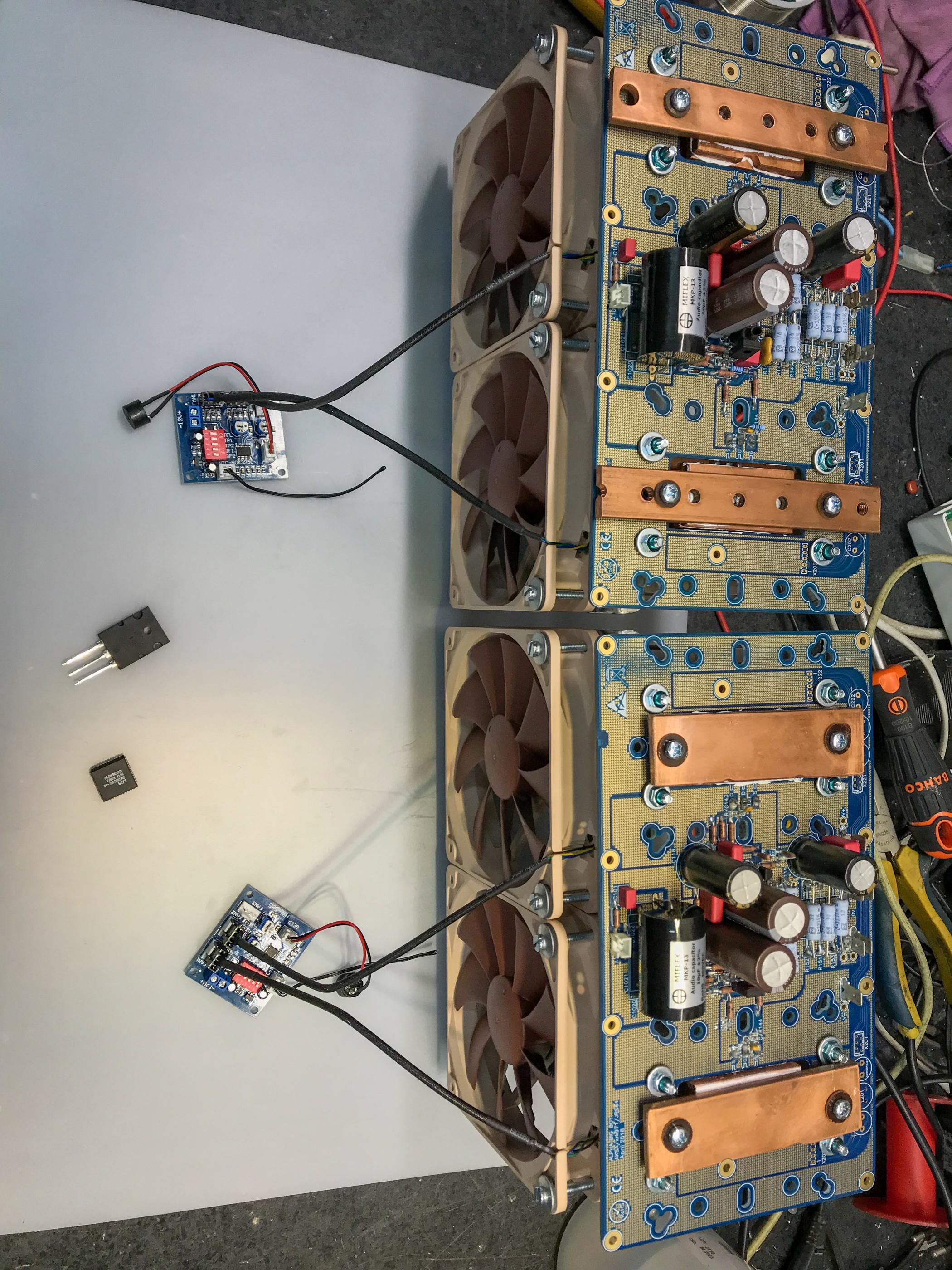

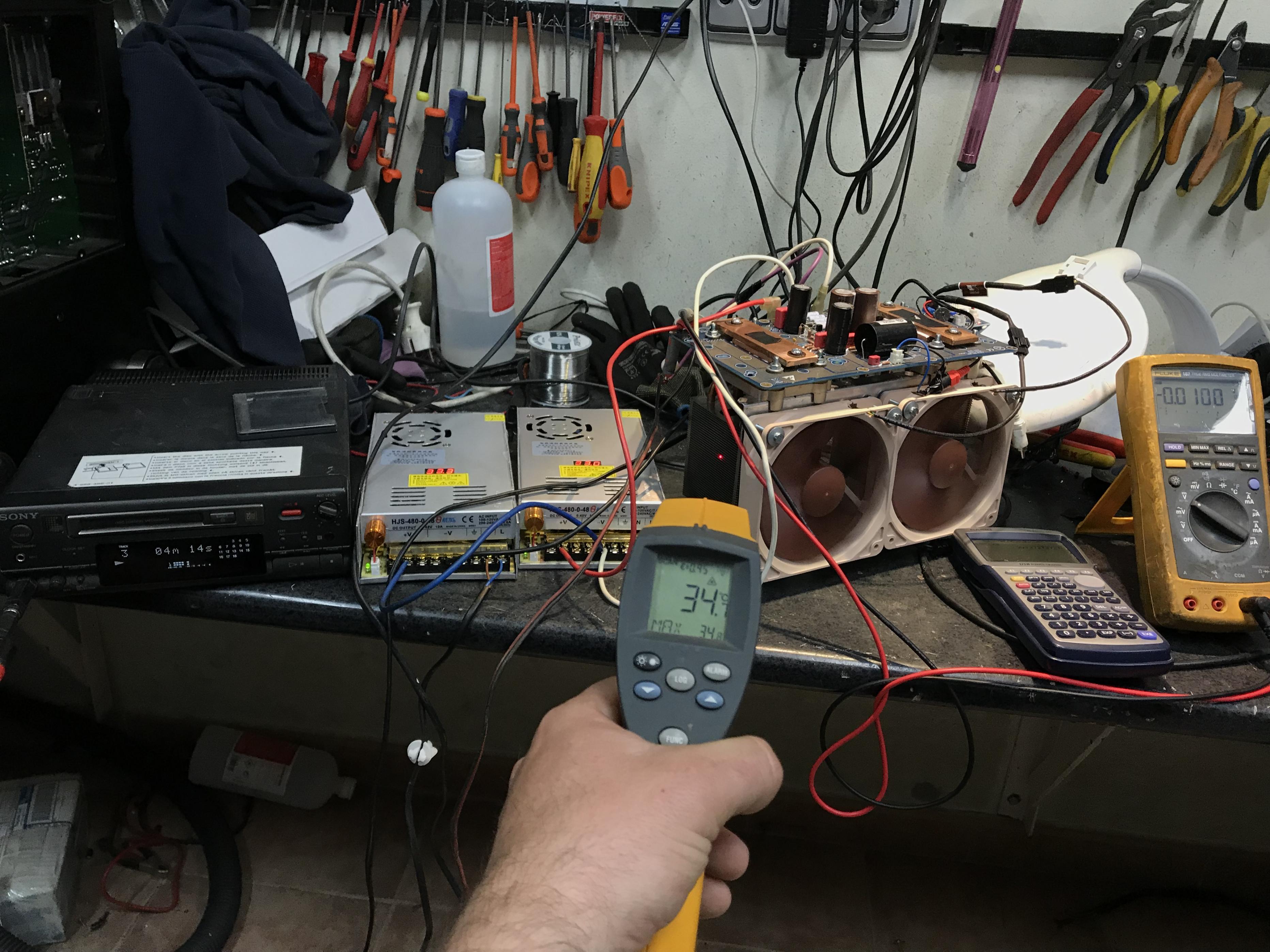

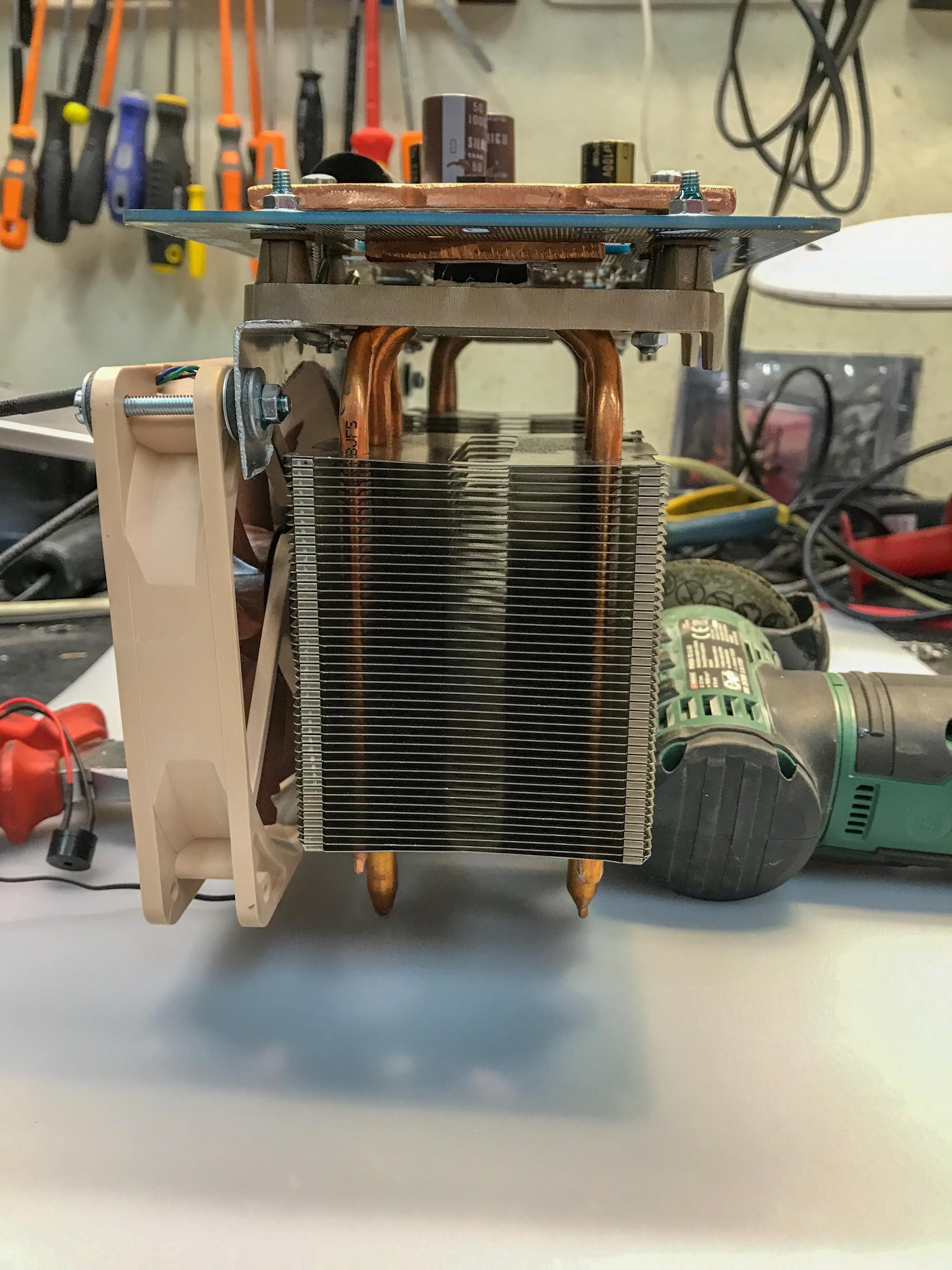

I Already have the two channels mounted. I have tested Them with two 10th Chinese commutated sources each and to test they Are worth. I get on the exits 10mv and 1MV respectively and without any noise. Here are some pictures of the process. And test to see if they worked. Now It's my turn to make the power supplies and the real ones for the speakers. Sound is good for now. The test I made a +-33v and the temperature in the radiators was about 42 degrees centigrade. The ambient temperature was 22 degrees in the test and the fans are very quiet too

Outstanding work, Antonio! Very well made and clear photographs of how you went about the project. Thank you for posting your results!
Do you have a metal brace on the mosfet, holding it against the cooling pad? I suspect you have something, but it's not clear in the photo.
Is this the best sound you've had from a Class A?
Ciao,
Hugh
Ciao,
Hugh
Thank You Hugh. The truth is that it sounds very good. It'S The first Class I have. The others I have are Class AB.
Between the transistor and the copper waistband there is a copper block to push it when tightening the waistband screws. In This Picture it looks better
Nice work Antonio! Great to see someone else using the CPU coolers and Noctua fans. They are a great combo for the 21st Century Class A amp.
