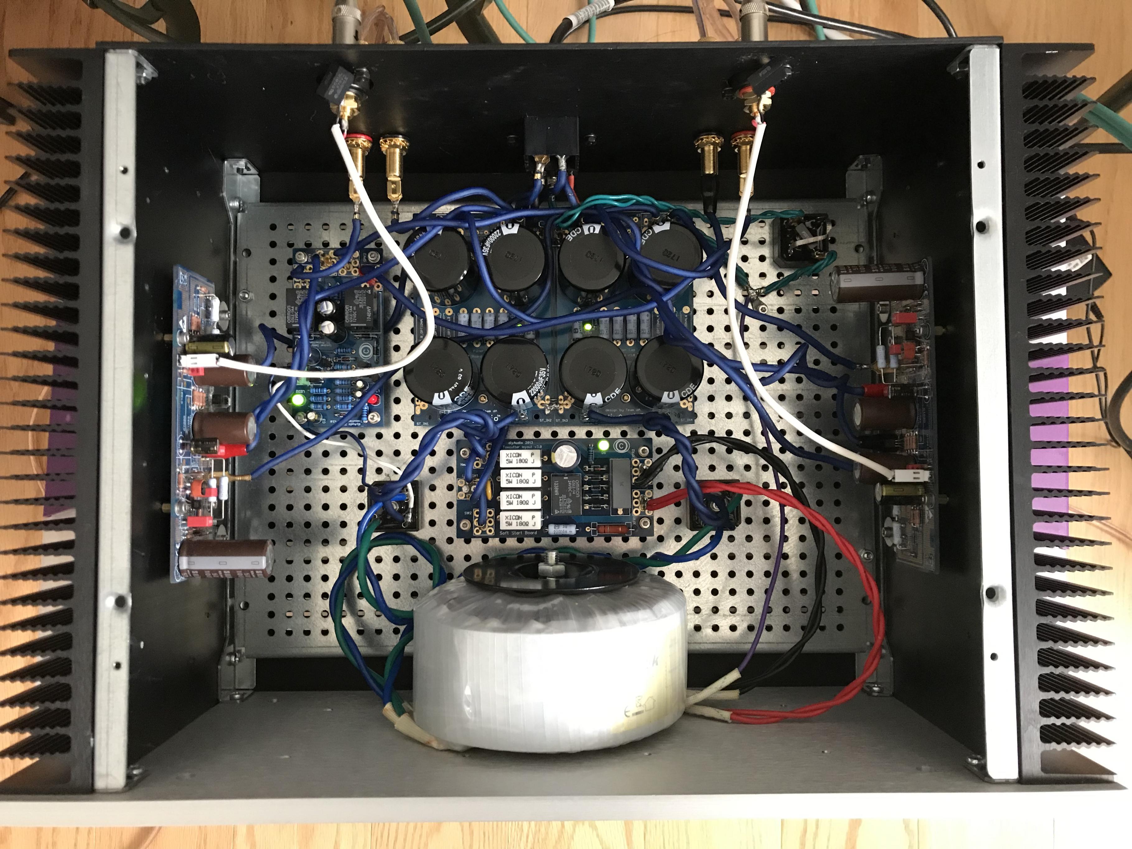

Finally spent some time listening to my Alpha 20w today. I have to say it sounds very nice from what I can hear. Unfortunately I have a hum that I can’t get rid of. I’ll list what’s happening and what I’ve tried in hopes anyone has some ideas.
- Only present with source plugged in to inputs
- Hum does not change with any source i’ve tried: iPhone, laptop w/ Sabre DAC, AKSA Lender Preamp with CD player.
- Does not change with change in volume
- Is equal between both speakers
- Did not change with a change in my grounding scheme
- Grounding Scheme 1 - star ground all grounds to CL60 thermistor, thermistor to case
- Grounding Scheme 2 - star ground all except PSU ground to case. PSU to thermistor. Thermistor to case at star ground.
- Tried switching transformer primaries. No change in hum.
- Tried a different outlet. No change in hum.
Does the hum disappear when you ground the input HOT pin?
If no, you may have insufficient ripple rejection, so you need either bigger C or bigger R between or both.
If yes, you have an earth loop between source and amp via preamp.
Fixing hum issues on audio amps is a black art and easily the most issue of building your own system.

Jwjarch,
Sorry to hear about the hum issue. What power supply are you using? I suspect you have a single transformer with dual secondaries forming the dual rails shared between the two channels? Does hum go away if you unplug one of the input RCAsl for one of the channels? If so, that’s a ground loop that’s hard to get rid of without resorting to dual trafos and monoblock design.

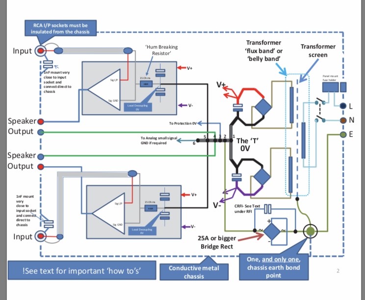

I had to do ground lift resistor to Alpha 20 to get it quiet, and do it right with lifting one capacitor leg also out from pcb and wire it behind resistor. Where this wire travels makes difference also, because it seems to pick interference easily. I can check that connection later. B.B. have build in ground lifting resistor if remember right?
Okey, it should all be somewhere in this topic. I had 100ohm ground lifting resistor where 0 enters the pcb, then C101 negative leg soldered out from pcb and wired to the otherside of that resistor. Does that sound even remotely correct: X, Hugh? I can't remember good enough to be sure.
Earth loop should be around 10R; 100R is a little high.
The signal Earth should include fb shunt resistor, input ground leak, and the LP filter cap. The float resistor should run from the precise center of the power ground, which is normally a track connecting negative of positive rail and positive of negative rail. This point also connects to the cold speaker connector.

No more hum!!! After trying a few more different grounding schemes I have success. I used a loop breaker type scheme based on this image that I found in the chip amp forum. There is still some barely audible noise when I put my ear up to the speaker but I’m hoping my final wiring cleanup will help bring that down even more. So excited to have solved this issue!!!

Wonderful results, JW, and a great idea by adding the earth float resistor and the input RCA caps to chassis! That schem you supply is excellent, thank you for finding it.
