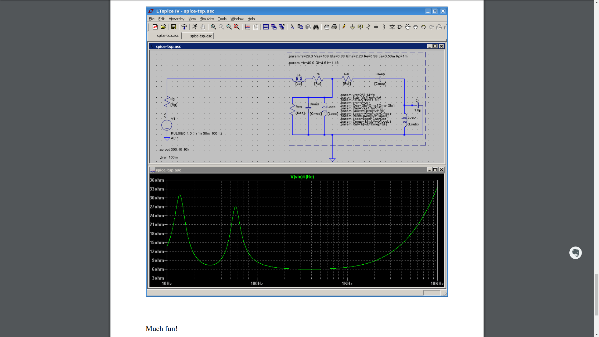

Danny can you simulate the amp with a loudspeaker as load ? there the png
I think i goto bed.
