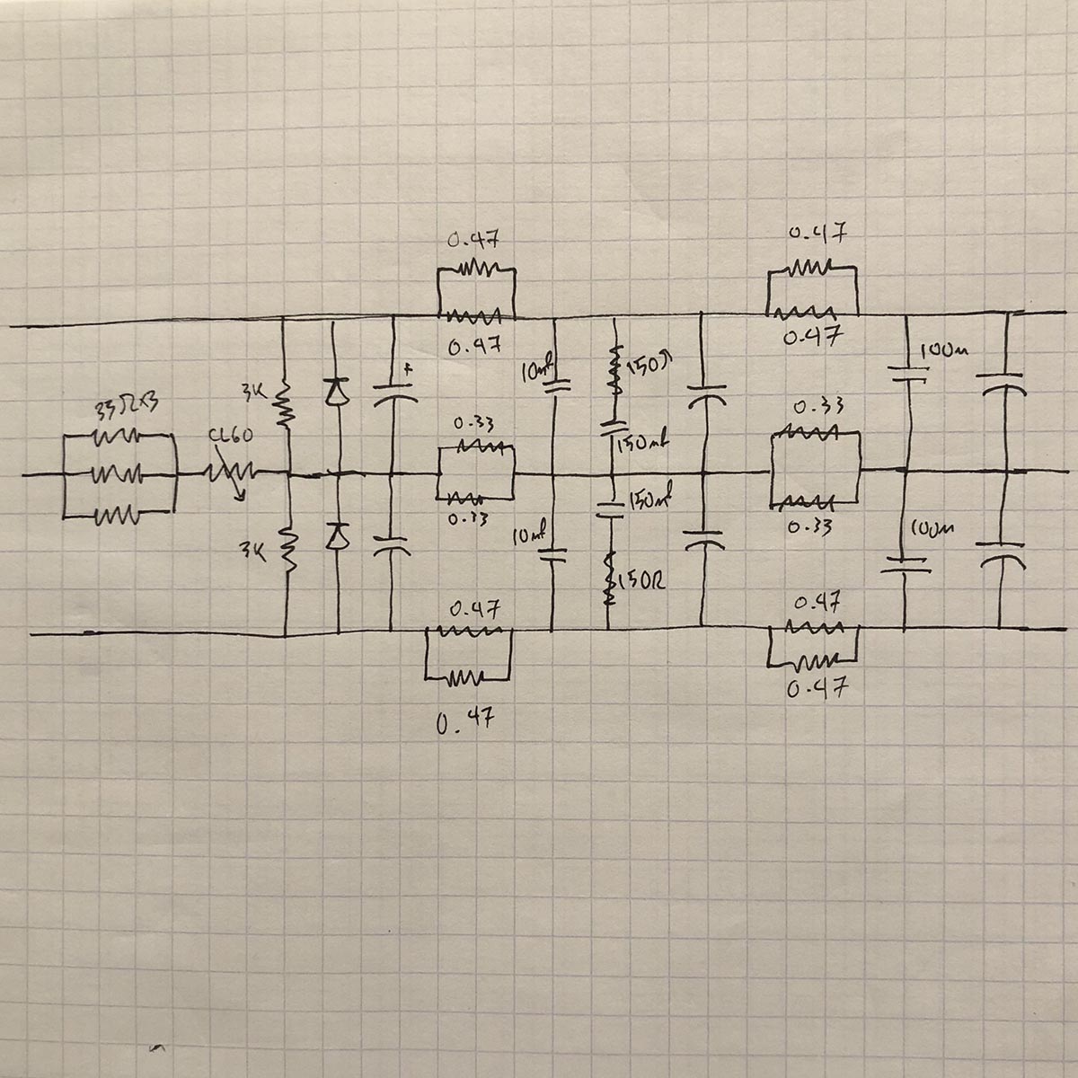

Atatched is a diagram of how I wired the amp.

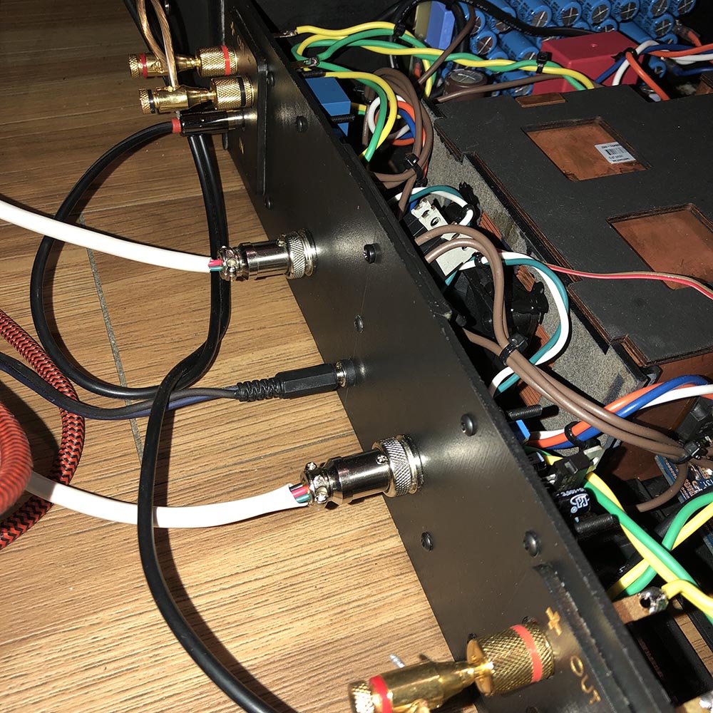

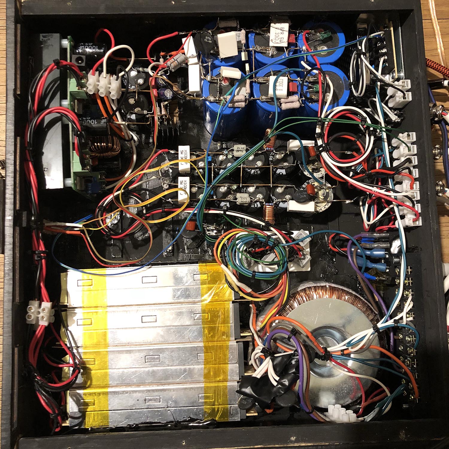

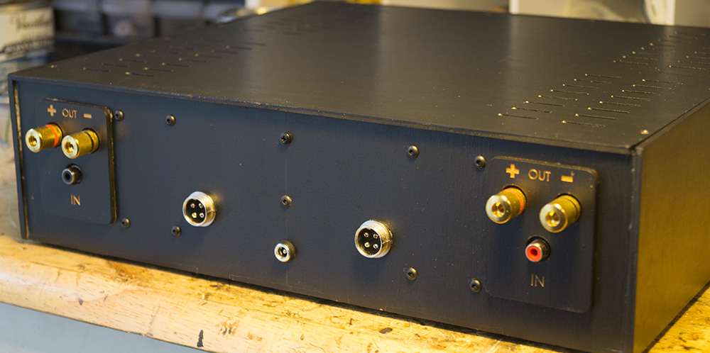

The Amp is actually two parts (two separate boxes), one power supply and one the amp itself, they connected together via 4 Pin Aviator connectors ( same thing they use in CNC machines)
In Power Supply box I have the SMPSs > DC Boost > Cap MX > modified F6 CRCRC Filtering caps and Ground Bridge w CL60.
In Amp Box I have the power > CRCRC Cap Array > Amp, and I have another ground bridge w CL60, that cap arrays and amps are separately connected to it.

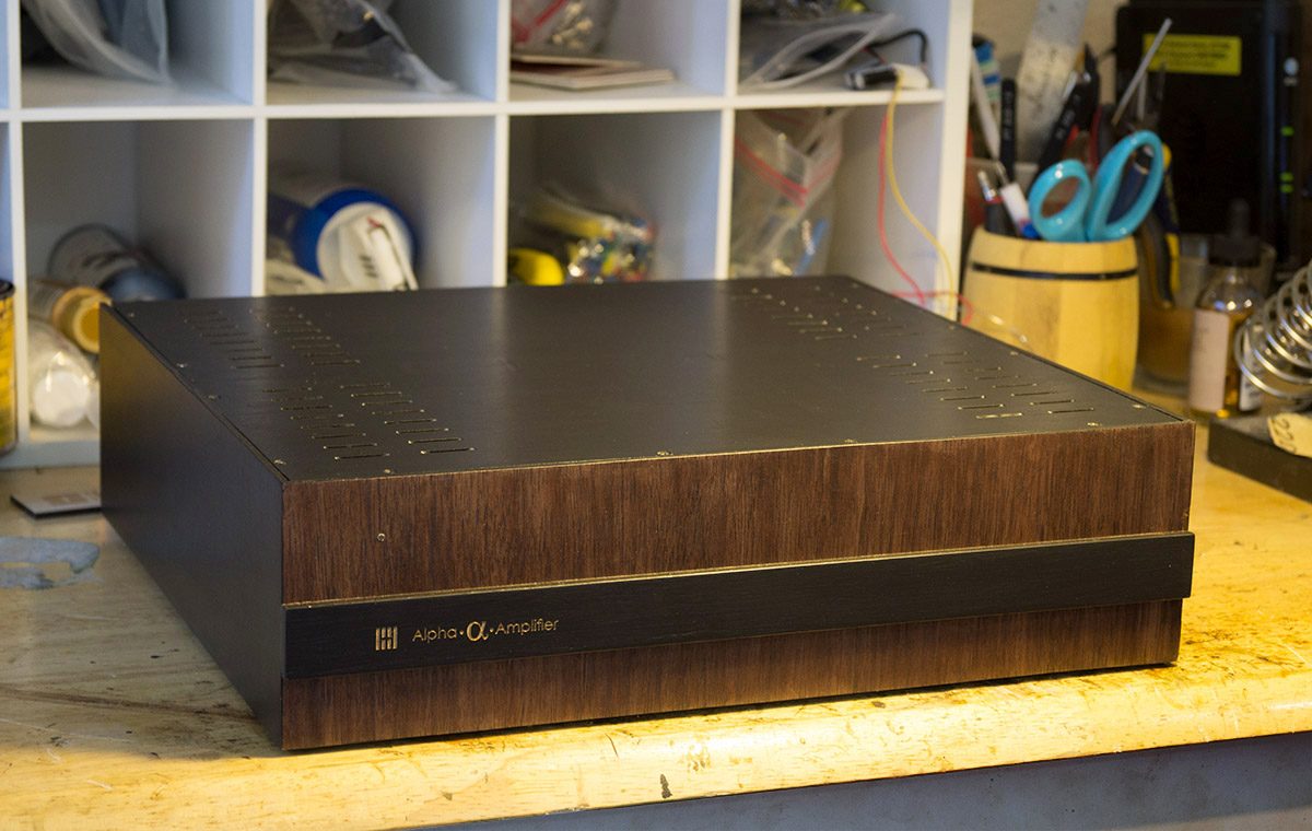

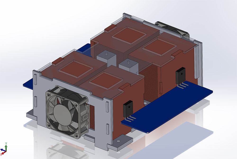

As for the heat sinks I have two fans one for each side X.
BTW, just to make it worse all the boxes are made from wood, no aluminum pieces 😀.

Beautiful work, Aatto. I thought those "wood" panels were 3d printed like much of your stuff. It would be very instructive to see the power supply box with DC step up and cap Mx. Which SMPS are you using (HP?) and which cap Mx are you using? That's interesting that you have multiple diode bridge ground loop breakers. Usually there is only one between dirty earth ground and "clean" 0v amp power ground. Lots of CRC and CRCRC certainly helps. It's a very compact implementation - how warm does the fan cooled inside of the case get?

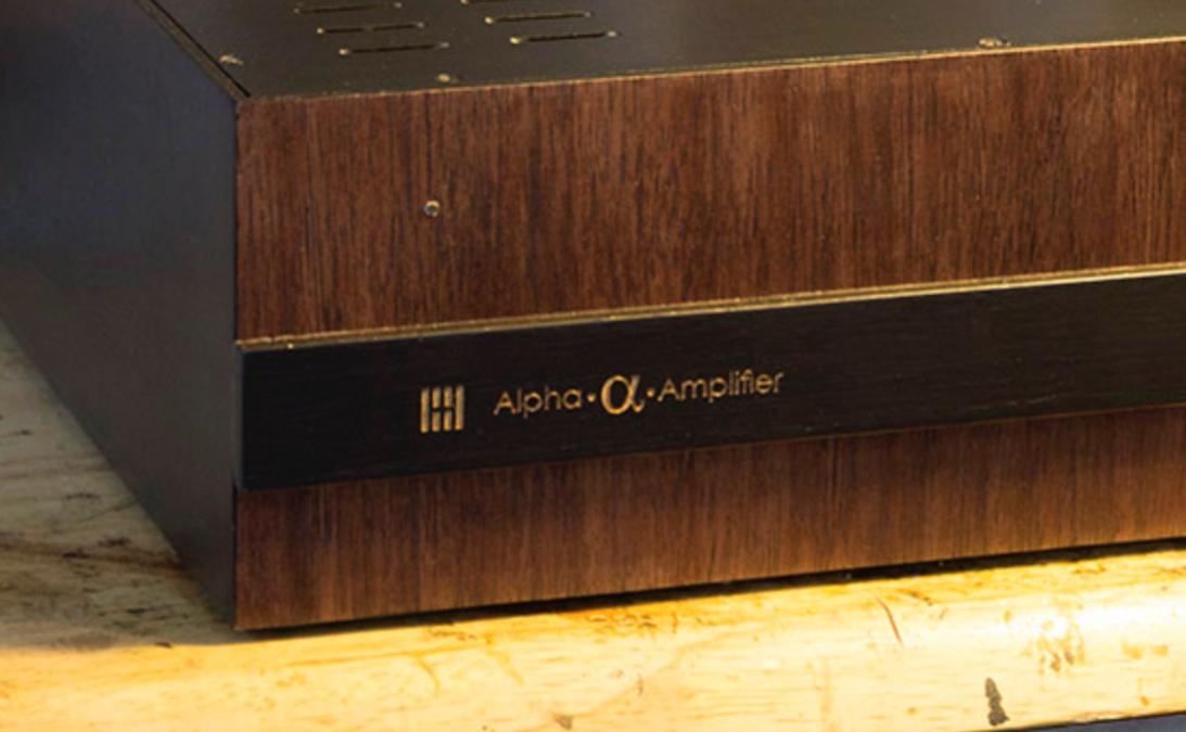

Would you like to share the Alpha 20 logo artwork
Hello Aatto,
My compliments on a nice build, Happy listening (I wish I was at the same stage)
I very much like the design of the Alpha 20 logo / text on the front plate, would you like to share the artwork?
Grtz
Bert

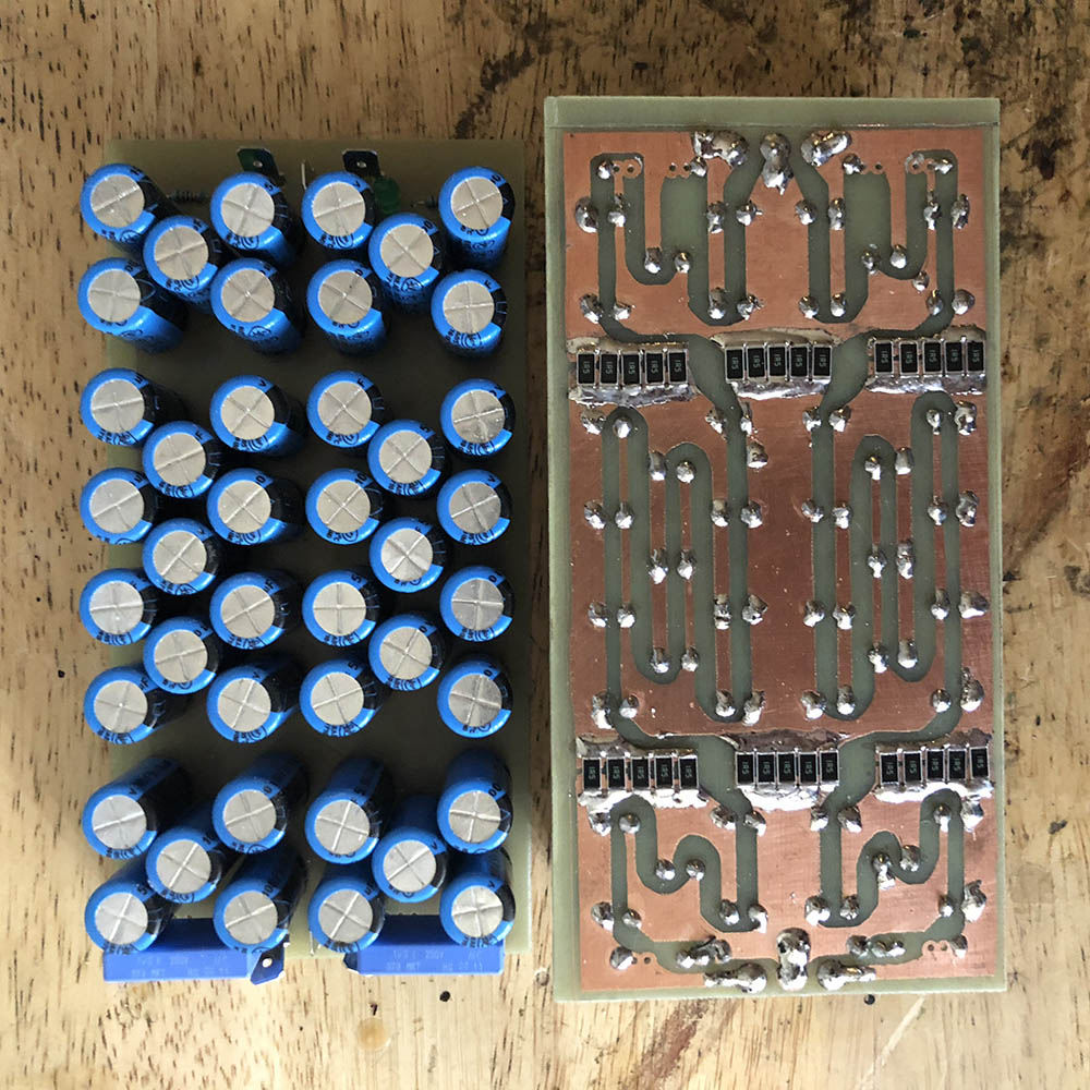

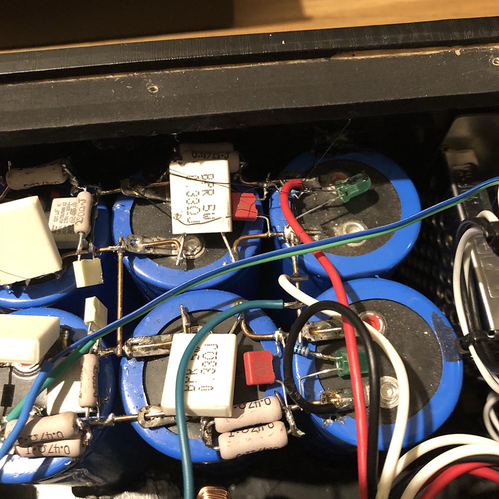

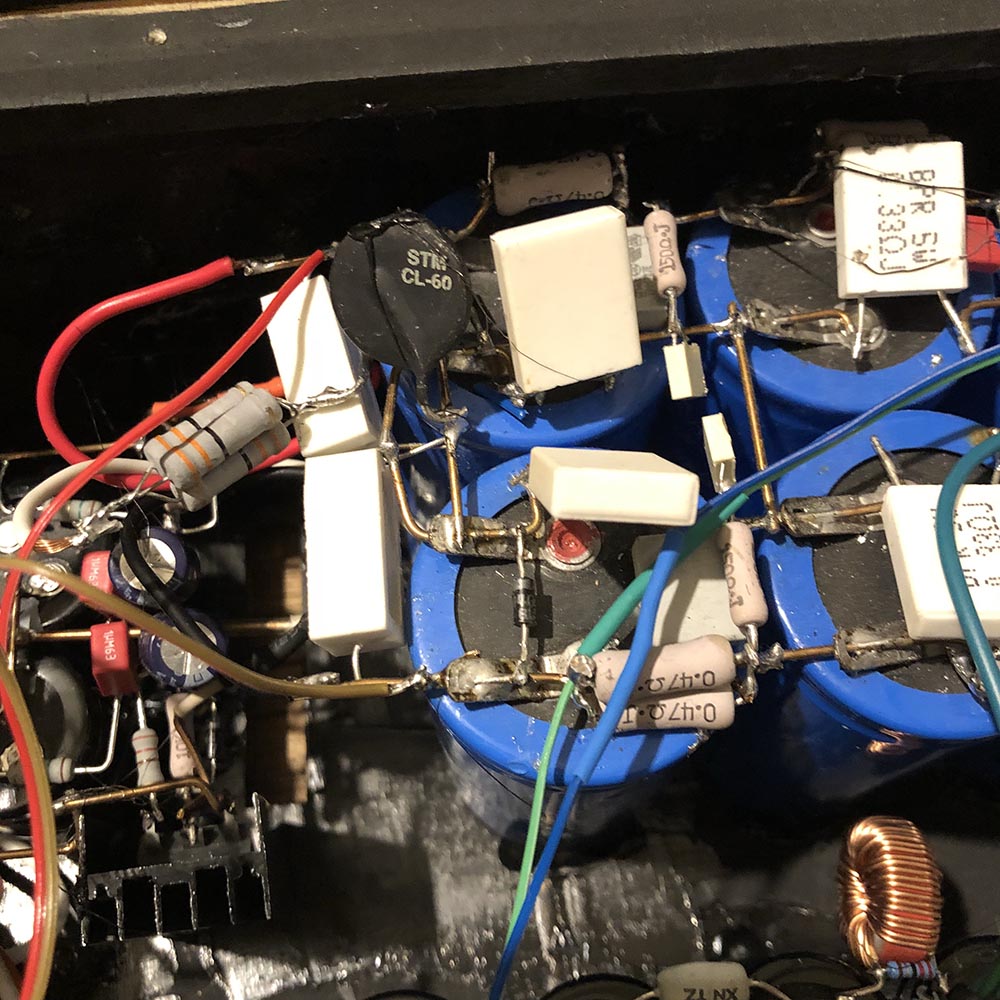

I attached some pix, hope it helps. let me know if you need more details.
main CRCRC filter, CRCRC cap array and logo is included.

I do not own a 3d Printer, what you saw so far is all laser cut/engraved wood panels, best 400$ i ever spent i would strongly suggest it. 😉

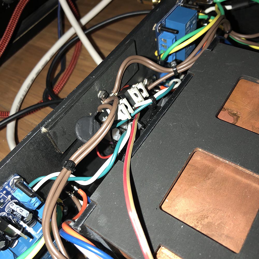

...how warm does the fan cooled inside of the case get?...
well so far i managed to run the amp for a few hours and it gets pretty hot, heatsinks got to 150F, so for now i m running it opened top ( top less !) which i can hear the fans now, i used hot glue for some components and it start to loose its solid state ! so I crank down the voltage to +-22.5 (was 24.5) and will keep an eye on it but I will eventually switch to an aluminum case.
150F is 65C and that’s hot enough to cook steak with!🙂
Probably making it so compact and your heatsinks are just pure copper blocks and fins and not heat pipe spreaders. That PSU is impressive and I j ew it had to be more complicated than I thought. No wonder you don’t have any noise - look at all that filtering CRC - especially with the R on the 0v or GND bus. Maybe some more cents in tip and bottom panel with laser cutting will help cooling.
you are right, the amp box is too small and crowded, it prevents air circulation i removed the top and now it is 95F ! huge difference, i could add more vents but it is a 3mm MDF and will results in a weak construction (the copper heatsinks are HEAVY ). i have to put more thoughts into this.
BTW the second set of CRCLCRC filter you see in PSU is for trafo, it's +-40v for my FH9.
My theory behind this was that high mf caps are expensive and it would be cheaper to have smaller caps (6800 to 10mf) but have better filtering path.
