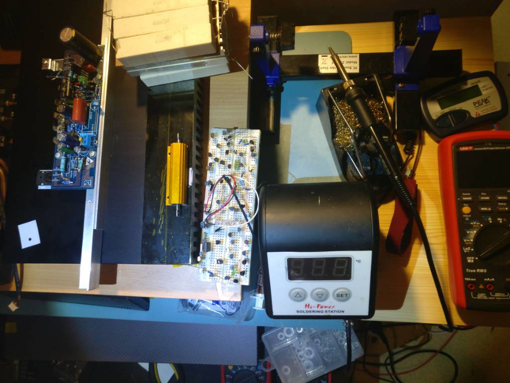

well so far i managed to run the amp for a few hours and it gets pretty hot, heatsinks got to 150F, so for now i m running it opened top ( top less !) which i can hear the fans now, i used hot glue for some components and it start to loose its solid state ! so I crank down the voltage to +-22.5 (was 24.5) and will keep an eye on it but I will eventually switch to an aluminum case.
I think your fan must be the same size than your copper heatsink as tall and wide. Or you must make some adapter so all the air force to go true the heatsink. Like these, see the plastic at Dell. I have two Dell computers. Dell CPU Heatsink Optiplex GX620 330 740 745 755 E521 J9761 D9729 Mini-Tower OEM | eBay You have not much room there so the 2 fan option may be better. Two fans next to each other. That one fan like how is in the picture is not enough. Just an advise🙂
Especially summer time if you run the amp several hours it will get fried. I forget to mention your fan must take fresh air from outside of the enclosure!

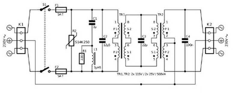

Hi Tonza,
A good system, BUT it requires not one, but TWO transformers, and the third transformer for the step down for the secondaries. This will work beautifully, and remove a good deal of the grunge and the DC on the mains, but the power supply on any amp is the most expensive part and you are suggesting almost tripling the cost.
The idea of a good engineer is to do what any layman can achieve, but at ten times lower cost......... something to think about!
Now, to end on a positive tone, how is your ALPHA coming along and do you have any thoughts on the sound quality?

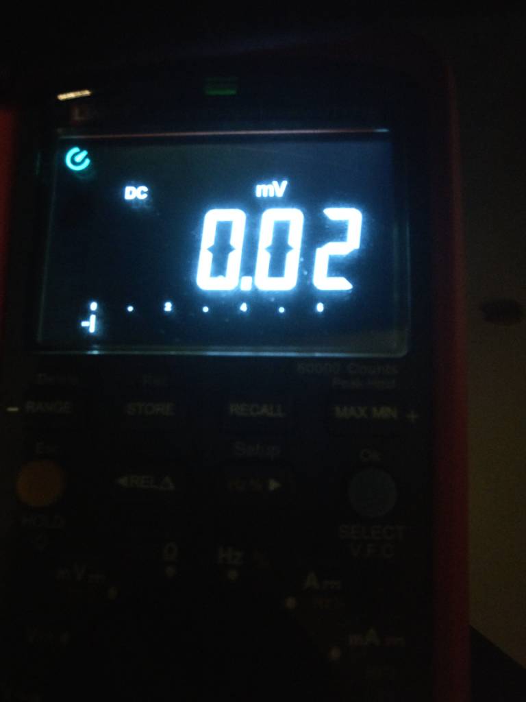

This is a dc test only!Hi Tonza,

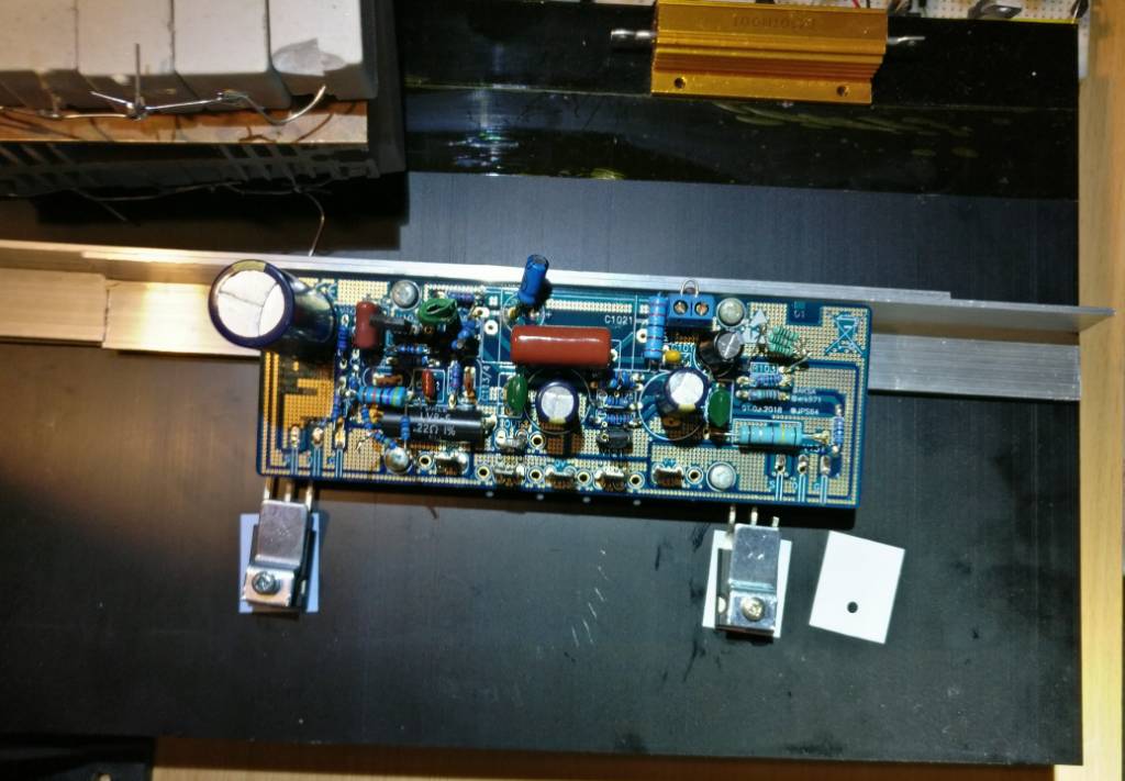

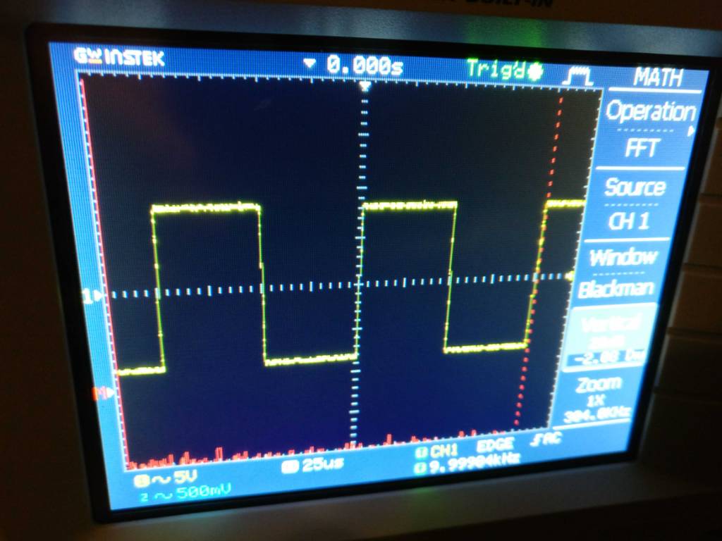

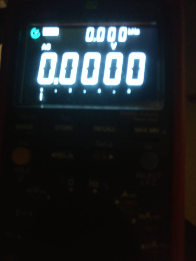

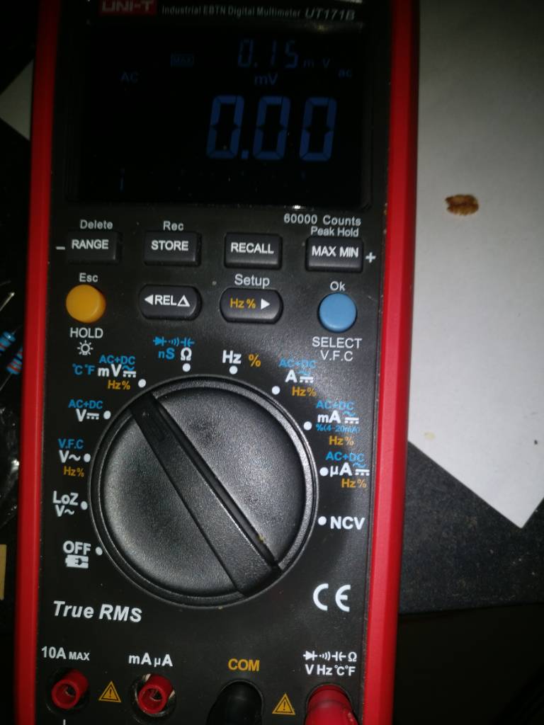

As it is important to send pictures here, I got it to about there nJust played around with input shorted, dc of course. Try a few hexfet next & see if it will behave as amp. Used what I have not the best build but.....
We can increase parallel fets in your ltspice or Danny's we can get it stable to smaller loads even under 1 ohm, no problem. But the res. 0.27 & better be tight tolerance in ltspice world.

I admit that is as low a noise figure as I have seen....... and that 10KHz square wave is picture perfect!
Congratulations! Very good result.

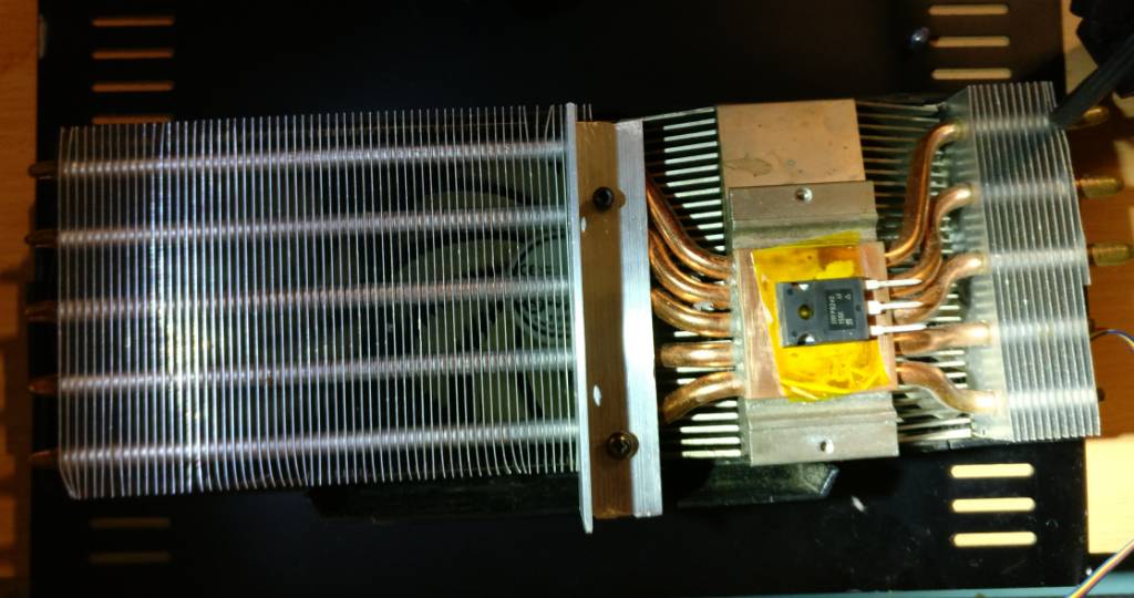

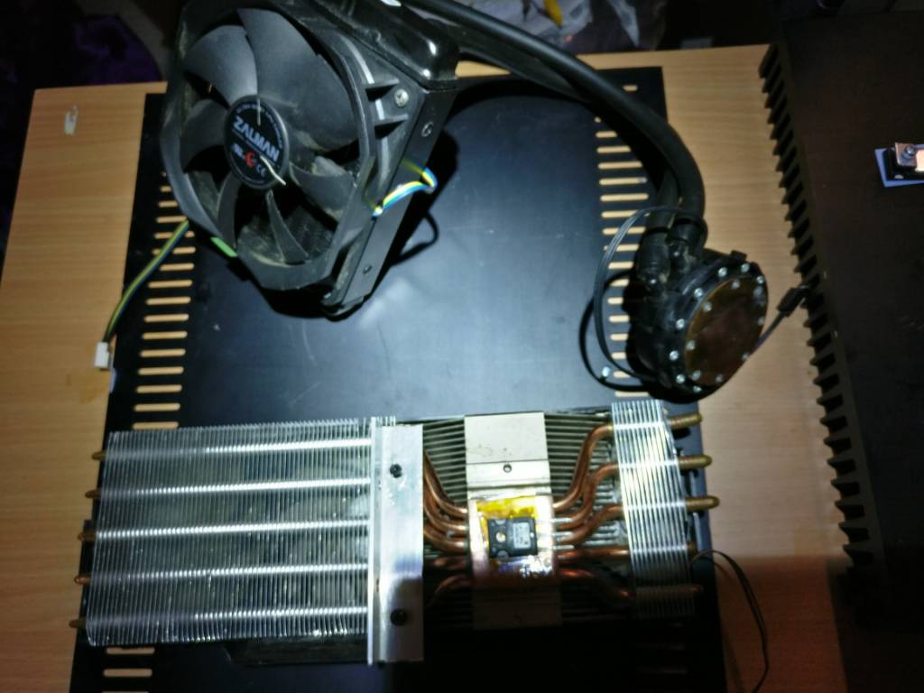

Zalman cooler used to get a Ati Radeon graphics card to 44 max 50 Celsius. The heat pipe is with 3 fan92mm could not handle the heat as well the card was heavyly overclocked so summer is coming and se push pull is a thingy to have.This is a dc test only!

That heatpipe CPU cooler should be more than enough to cool the MOSFET. It might be the Kapton tape you are using. A while back, I think it was Maty Tinman or was it Jontuin? Whom recommended the ceramic insulator pad. That pad is about 8x better than a 1mil Kapton tape. So you may just need to switch to at least using silicone pad like Keratherm etc.

the fan is the same size as the heat sink and i have two fans, one for each side ( one for every two heatsinks), but the problem is not the fans, the problem is small box and no room for air circulation, as you read in my previous post when i remove the top the temperature stays at 90 to 100F which is good enough in Texas heat.I think your fan must be the same size than your copper heatsink as tall and wide. Or you must make some adapter so all the air force to go true the heatsink. Like these, see the plastic at Dell. I have two Dell computers. Dell CPU Heatsink Optiplex GX620 330 740 745 755 E521 J9761 D9729 Mini-Tower OEM | eBay You have not much room there so the 2 fan option may be better. Two fans next to each other. That one fan like how is in the picture is not enough. Just an advise🙂
i think my solution is either a bigger box and/or a box with at least aluminum bottom plate so the heat can be spread out and cooled.

Hi X,Whom recommended the ceramic insulator pad. That pad is about 8x better than a 1mil Kapton tape.
I recommended those, here's the post with comparison test and seller info.
Grts,
Danny
Thanks Danny for reminding me and sorry I forgot it was you. Those pads do indeed work marvelously well on my Alpha BB. They do require a heatsink compound paste though so not as eat as paste-free silicone. But the results are quite good. With my Alpha BB and the CPU coolers running on 10% minimum speed, the aluminum clamp bar on the MOSFET never goes above 38C and the heatsink temp is 27C so that air coming air is hardly even warm.
