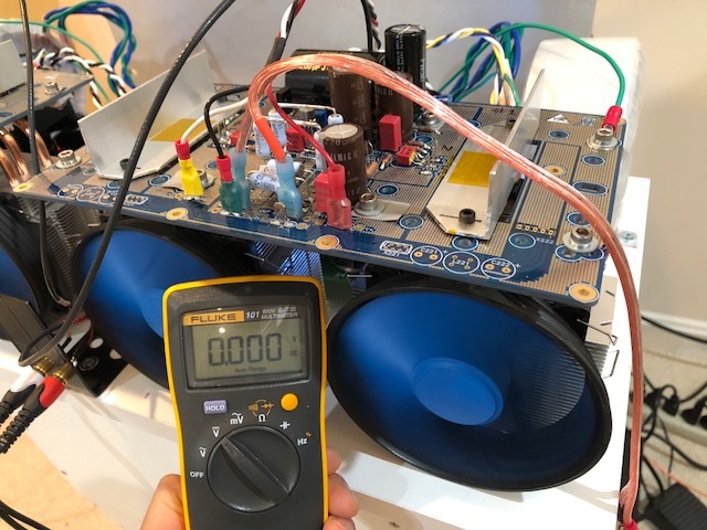

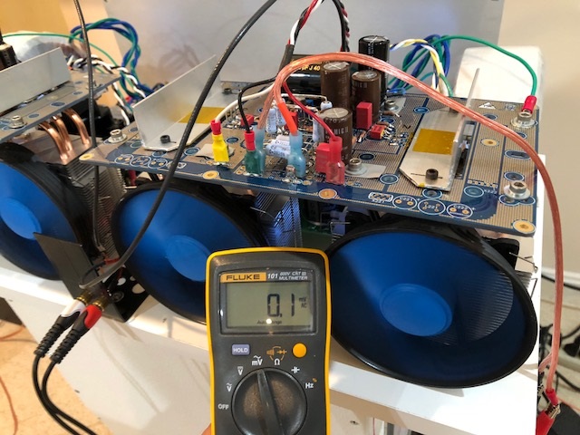

My Alpha BB continues to work well. After a month the noise with volume turned down on preamp is 100uV rms and DC offset is 0mV. It is an amazing sounding amp that is easy to live with.
Noise at output:
DC offset at output:
Noise at output:
