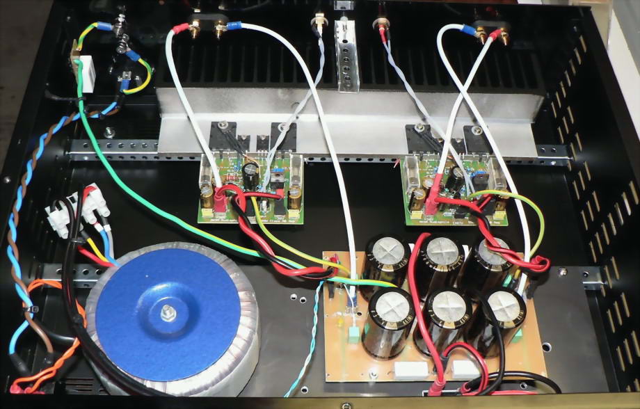

here you have Aksa amplifier from Rabbitz... lovely construction..do not know if was Hugh that made this one or if was Rabbitz... seems to me Rabbitz as he is very carefull with details... a little bit more than Hugh i think.

Nice ones... the wires needs some care in my point of view they could be more hidden
but it is clean and nice.... well... i cannot make this better..but to watch and criticise is very easy.

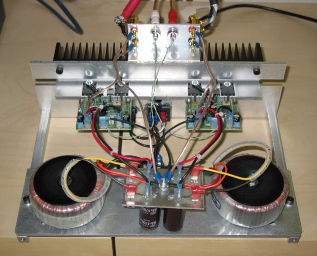

Hey.... they're my amps.
The one in post #324 and #328 is the Lifeforce 55 with Hugh's supplied modules and my installation. I have very fond memories of this amp as was very priviliged to be part of a tweaking process by Hugh the master. It was facinating to follow the attention to detail and thought process involved. It was one of the highlights of my DIY amp building and thank Hugh for the communication as it unfolded.
The amp in post #326 is my mongrel AKSA 55N+ as it is really a mixture and is my current amp. It's built on boards supplied by Hugh when I bought the LF55 and became an amp where I could try a lot of different things which I wouldn't have done on my beloved kits for fear of destroying them. A great opportunity for a builder thanks to Hugh.

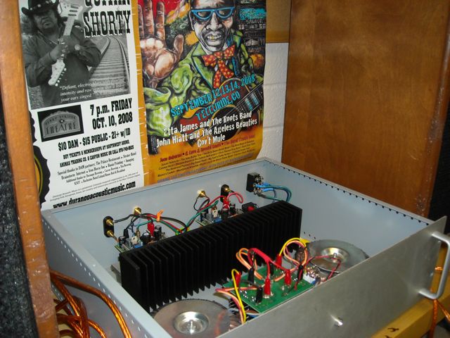

My 'topless' AKSA 55N+...
Built it me self with some advice from Hugh
Listening impressions? I like it... a lot. and I've only got about 20 hours on it.

Great Amp. Great service from Hugh. More pictures to follow

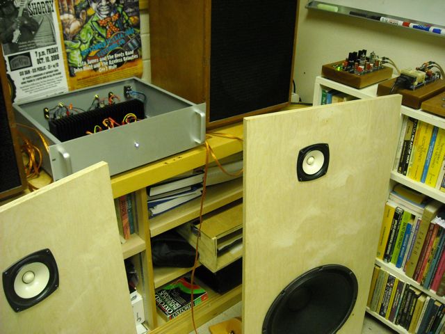

Last one...
A final photo with the entire set up. The listening room (currently) my office. Far less than ideal. I can't bear to bring it home... but I've promised the neighbors a listen and some beers...
You can see the DAC, pre, AKSA N+ and Open Baffles . A bit tight, but it's the best d**n sounding office on campus, by a many country miles.😉

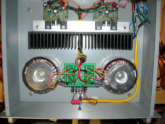

Ryan,
That's a beautiful layout, very clean, uncluttered, nice wiring (although a tad long?). Innovative mount for the heatsink, too.

Cheers Hugh,
Yes, I wrestled with the length of the mains wiring etc. All of the input and output wires are short (i.e. near the back of the chassis). To achieve that, the mains run and ground lines to star are long. But, it is dead quiet so no complaints here.
I posted the layout over on the 'issue' thread. Mine is only a working example (one of many many)
The heatsink is mounted on alum. pillars that I fab'd.

Hi Ryan,
I'd have to say that your wiring job is excellent! Really, the optimal way to lay out an amplifier. You have satisfied every requirement for keeping the AC mains away from everything and all other cables are reasonably short.
When the layout and wiring has been done properly, things will always work out well.
Just think. The power transformers are near the front. That means that if you were to rack mount this amp, the bulk of the weight is supported by the faceplate. If you are simply sliding the amp into a shelf, the weight near the front makes it much easier to do. Meanwhile, the signal inputs have a very short distance to travel. So a small capacitance or distance to pick up noise.

And even better, insert the mains cable through the bottom at front close to transformer
Mount a simple fuse holder, and you get rid of even more AC wire etc 😉
