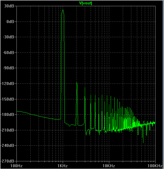

Something like this,Hugh?

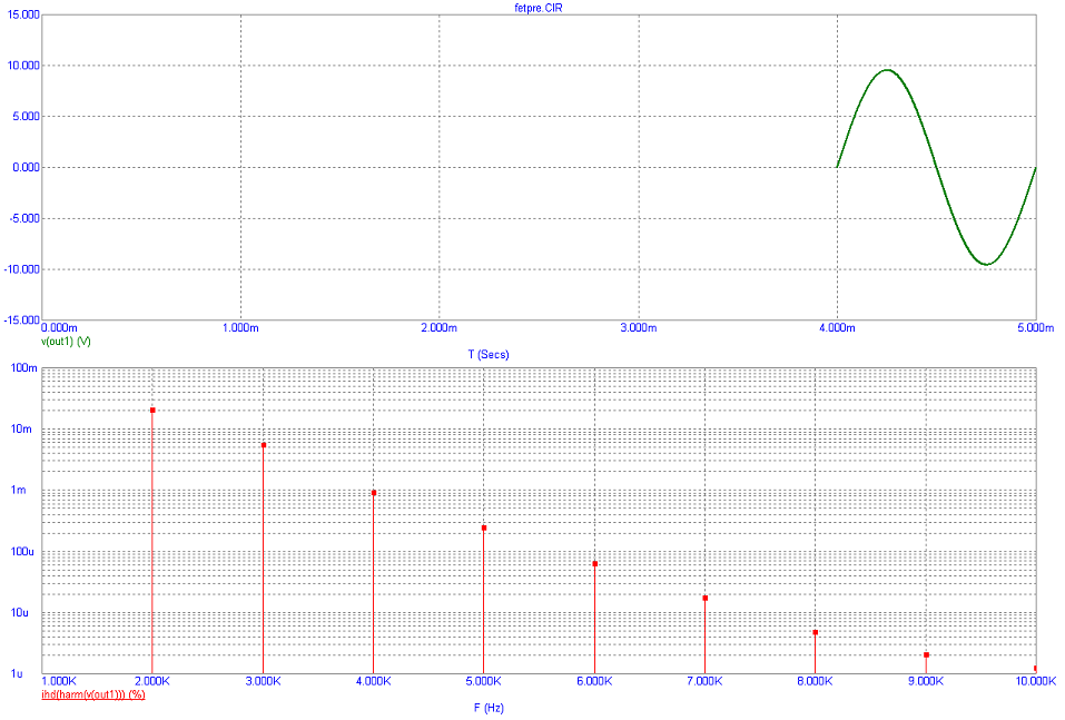

Or like this... This topology can go ALL the way.
OS
