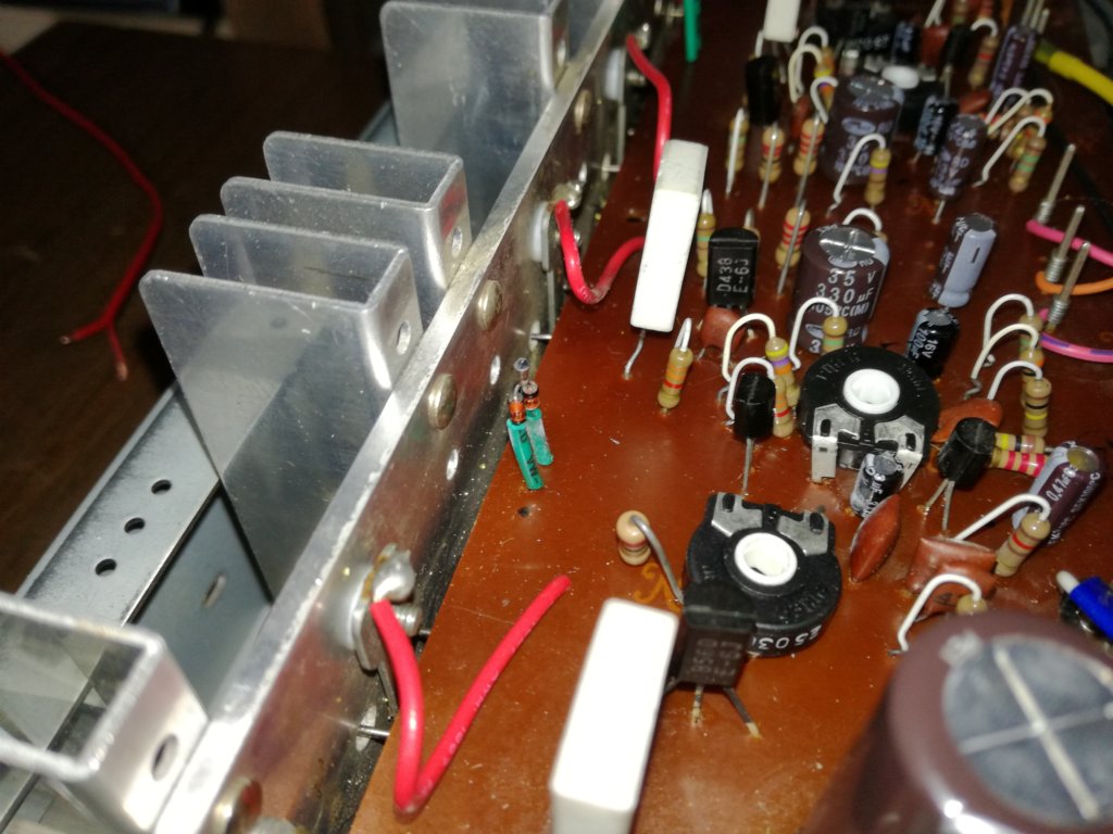

Hi all,
To continue on Akai AA-1020 amplifier, may be anyone got some idea ...
I just restored one of these receivers: new caps, adjustment & cleaning.
One channel was bad, I replaced all 4 output transisotrs with 2N3055 and I also adjusted voltages in amplifier.
Receiver works good for aprox. 10 minutes.
After that one channel stops working.
TR5 and fuse for that channel blows.
What can be wrong ?
Tnx

Thermal runaway perhaps. You need to monitor the bias current in the bad channel and see if it creeps/jumps up. Those series diode packs can be troublesome (generally across many makes and models).
try something better then 2N3055, it may be oscillating as these are slow.
changing the 100p cap to 150p may stop the oscillations at the cost of high end response.
the diode stack appears to contain 3 diodes providing 2.1v bias
