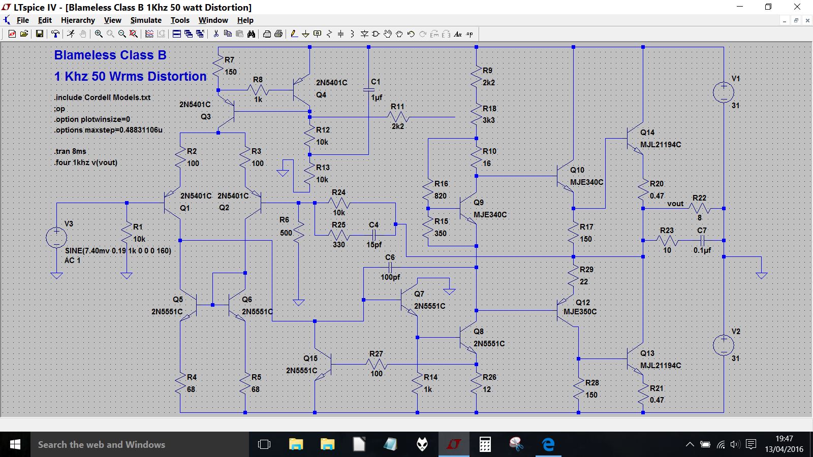

The vbe multiplier has been around since the early days of transistor amps but it seems only in recent years that we have started refining them quite so much.
Something like Doug Selfs arrangement on his 'Blameless Class B' design would be very suitable I would have thought.
This is the arrangement. The 297ohm would be the preset and the 16 ohm might be slightly tweakable to get the very best result in your amp. Best as in least change with temperature.

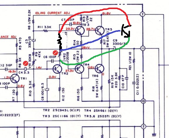

The vbe multiplier should be easy to configure. Just mount the transistor on the heatsink and wire C and E to the appropriate points on the PCB. Replace the trimmer with the chosen new value and wire the appropriate end to the base of the new transistor. Remove the diode chain and in their place add the chosen fixed resistor that will go across C and B of the new transistor.

Thanks Mooly - looks very simple to install, and would be of benefit performance wise so seems like a no brainer.
So replace VR2 (200R trimmer) with a 297R resistor (or thereabouts) instead.
VR1 (30K) elsewhere in circuit kept as-is.
VD1222 replaced with approx. 16R. How to fine tune that value? Can it be calculated 'on paper' or would it be best to replace with a trimmer?

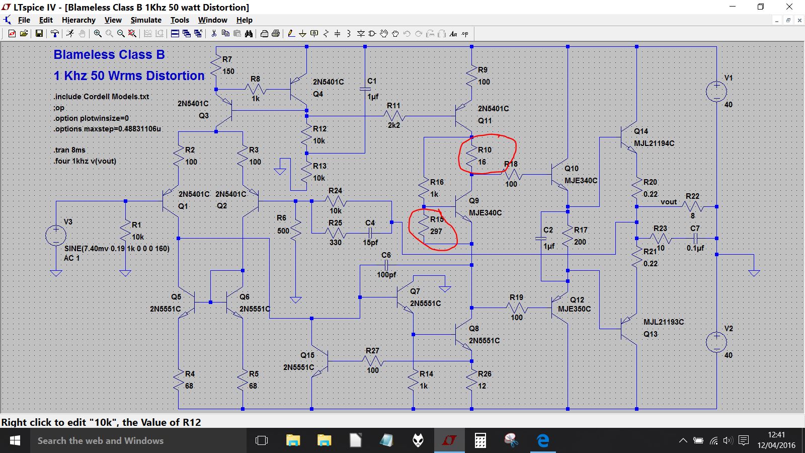

I was doing it without the 16 ohm tbh. Just a very simple multiplier in the time honoured fashion that we used for years. If you wanted to add the resistor then it would be less disruptive to place it at the multiplier itself. That way all the print stays original, no cutting or hacking. With the multiplier on the heatsink there will always be some thermal inertia, if you can place it on (touching) one of the outputs then you would get better control. Its all relative though and we never used to fret over such things in the past.
VR2 stays a trimmer but would typically be a 470 or 500 ohm preset. The resistor from C to B on the multiplier would be around 1k. VR1 stays the same.
Thanks for clarifying that resistor between C & B of the muliplier Mooly. So 1K for that then. Either on the pcb where the vd1222 was originally mounted, or between the legs of the multiplier itself then.
Any suggestions for the multiplier? Mr Self's diagram shows MJE350C. A good choice here?
MJE340, the 350 is the PNP. Pretty much anything is OK for this because its not in the signal path as such. You would need to insulate it from the heatsink.
How are the diodes mounted ? Could you rig anything up there using a smaller package device.
Just quickly rehashing the circuit above to match your quasi configuration and we get something like this. This is running at 50ma bias in the simulation. The 1k is probably going to need be nearer 820 ohms to get a suitable adjustment range with a 470 ohm preset.
For minimum bias current the transistor has to be fully on and that means the preset has to be at its highest value (470 ohm). That's the starting point. I'm wondering if its safer to go with a 1k preset. Although 470 ohms is OK in simulation, its a bit marginal in that it only just reduce the current to zero. Going to 1k would be more certain. If you went to 1k for the preset then the originally suggested 1k for the C-B resistor would be OK as well.
