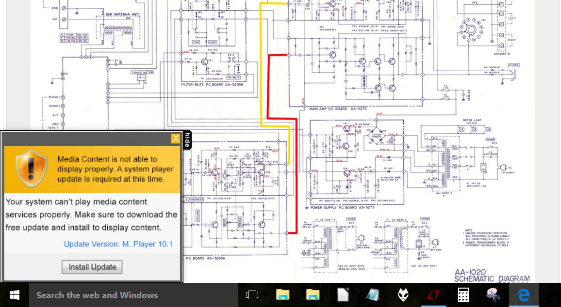

I've attached a couple of diagrams below which should be readable via the direct link to Photobucket (assuming the frequently unreliable bucket hasn't kicked it!). Too large to post here legibly.
The following is the circuit as-is, with the signal paths highlighted in yellow and red:
http://s954.photobucket.com/user/John-M23/media/1020 Circuit Signal Path.jpg.html
This image shows the shortcut I've currently taken to wire out the high/low filter PCB:
http://s954.photobucket.com/user/John-M23/media/1020 signal path shortcut.jpg.html
As it stands in my amp at present, the signal goes out of the tone control board (pins 6 & 8 in the circuit diagram) via two 2.2uF caps. The signal wires are now directly wired to the input pins on the Main amp PC board, at pins 4 & 8. The input caps here are two 0.47uF electrolytics (though I'm using 1uF films as had them handy).
Was wondering whether I could/should perhaps wire out those two 2.2uF caps on the tone control PCB board, now I've wired past the filter board pcb, or the input coupling caps in the Main amp board instead?

Better to attach pictures directly to the forum really, or do a zoom in of the area of interest 🙂 These external sites are often full of unwanted stuff.
If you have films at the power amp input then it looks like you can directly connect those to the preamp output. So you would link the 2.2uf caps and remove the 100k (was it ?) resistor that goes to ground at the junction of the two caps.
I usually endeavour to post photos 'in thread' Mooly, but the images were too big, and cutting the circuit into smaller chunks made it harder for others to read & piece together (I actually tried and the txt often wasn't legible). Photobucket is also a recognised/popular image hosting website so should be nasties free. Just click on the link, then click upon either the magnify icon, or the download icon. Should appear as its optimum resolution then.
So link out the 2.2uF (C13/13b) caps on the 'Tone Control PC Board', and remove the 100K resistors from input to ground (R1/R1b) on the 'Main Amp PC Board'? What would a typical/sensible value (after having done the mods just mentioned) be for the C1/C1b input cap on the Main Amp board Mooly? The circuit diagram shows 0.47uF. There was a 0.47uF electrolytic cap originally fitted, which I replaced with a 1uF film cap as I had it to hand at the time during the testing phases. The service manual in the parts lists confuses matters by then listing C1/1b as 3.3uF too!

So yes, link out the 2.2uf's and remove the 100k's. 1uf should be fine, in fact its not possible to give an exact answer because there are a lot of interacting time constants, the speaker coupling cap, the feedback return cap, in fact any cap in the signal path.
If you did revert to an electrolytic then you would (possibly) need to fit it the other way around compared to how it was originally because of the DC voltage on the collector of the preamp output transistor.

Great, thanks for confirming that. Out of interest, and trying to learn a little more, why do the 100K resistors need removing now? If that's too in-depth to get into here no problem 😉
When you have two caps in series, the junction of them is not defined at a DC level. Tying that point to ground defines a zero DC voltage at that point.
If you don't remove the cap when you short out the 2.2uf then you are placing the 100k across the collector of the preamp transistor which would then slightly alter the DC conditions around the transistor.

Thanks for the explanation Mooly. I think I'll just remove the 2.2uFs altogether then & wire link the remaining pads. Remove those 100Ks (no wire link there I assume) on the power-amp input and job done 🙂
That's it. Just one thought, whenever you change anything like this you might that any switch on/off thumps and noises are altered or become more prominent. You will only know that by trying the mod though.
